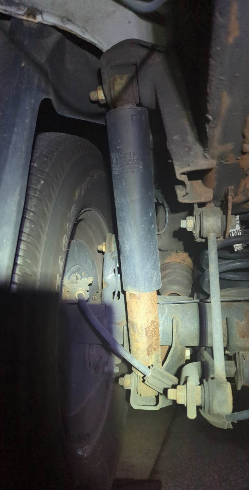

i can't seem to find what shocks i need online - might have to go to part store and show a pic.
i have z56 RPO but i can't seem to find what i need
should be an easy replace there

The rear, and standard PPV?
yeah just rear, and standard PPV as far as i know - I'm real new to all this
I *believe* the z56 here is the suspension if that helps
happy to get any information that might help you help me and appreciate the assist

I have replaced mine with OEM shocks. They’re shorter than non PPV units. I can look at my logbook for the numbers when I get home.
