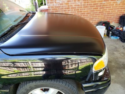

Sanded the hood down. Then wrapped it in Avery Sayin Black. Theres some imperfections but I'm pleased over all. If I was to do it again I would have used a sander and started with 320 then gone up to the 1500 I stopped at
Now j just have to clean it :)
EVERYTHING shows up under a wrap. Idk how these guys get damn near perfect results. They must work in a completely sterile environment.
Lol this was done in my car port in the middle of spring with constant wiping away pollen

That looks great, your gonna wrap the whole truck?

Oh I definitely agre . But being this is a giant vehicle. Idk man. The hood was nerve wracking enough
Might be better off paying a shop to wrap the rest of it, it can definitely be tricky and nerve wracking

Naaaaahhh Haha. If I do decide to wrap the truck I'll do it myself. I think I'll tackle panels at a time. Next up is the roof. Gonna fill the xm and onstar antennas then sand it down. This time I'll sand more.

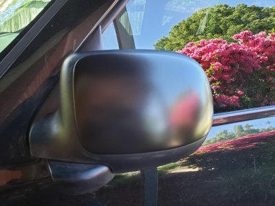

But I did just do my mirrors too. Pretty easy

Did you pop the covers off to do the wrap?

Yep. Broke a few clips (surprise)
Just used some strong ass double stick tape to put them back on.
