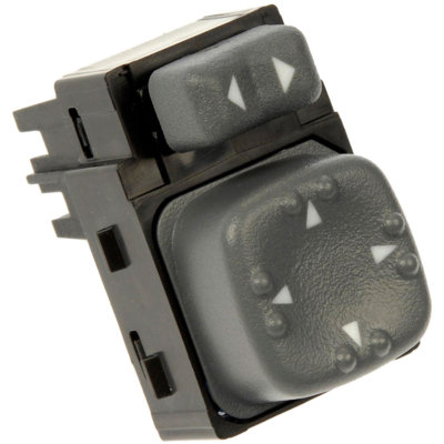

Then I’ve been needing to replace my mirror switch for the last year So i ordered that. I could only move the mirrors down, every other direction had quit working lol.

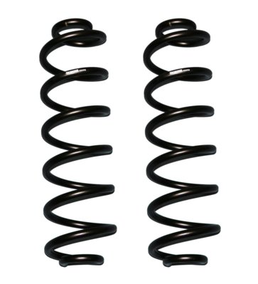

And I can’t find 4” lift springs for the rear so I went ahead and ordered these 5” lift springs, gonna take out the 7” spring spacer and stock spring and put these in should get more articulation and will lower the back 2”.
You have a 7" spacer? The new springs should be much better.
