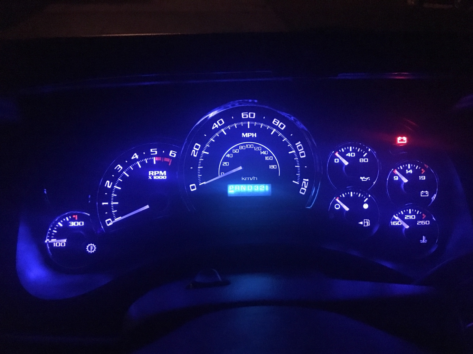

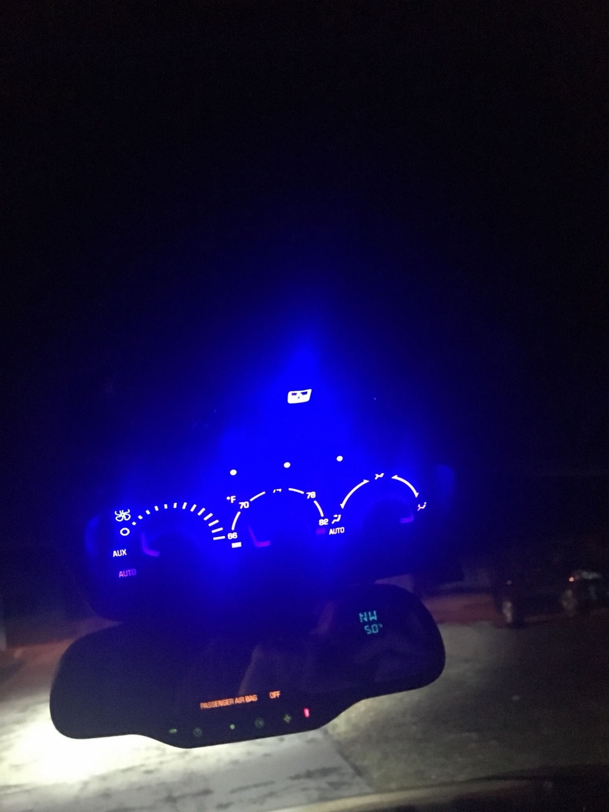

Installed the new cluster today, it’s a Platinum Escalade cluster with blue LED’s and needles, pics don’t do it justice and installed the rear HVAC control console had it all switched over to blue LED’s too

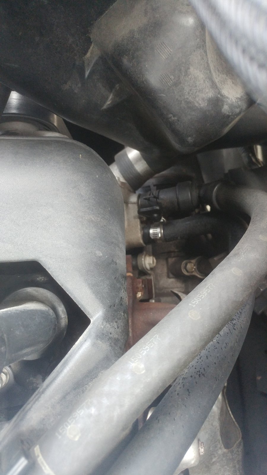

Hard to tell, but how did you eliminate it?
TheAutumnWind
Jan 8, 2015
3,254
1,996
That is a pic of the side of the water pump before i fixed it (where the leak was) actually so you cant see it. I simply removed the qc (molded to the original hose) and stuck the hose in its place with a hose clamp. The replacement hoses do not come with the connectors molded on, you can buy them seperately but i chose not to. Just seems like an unnecessary potential failure mode.
