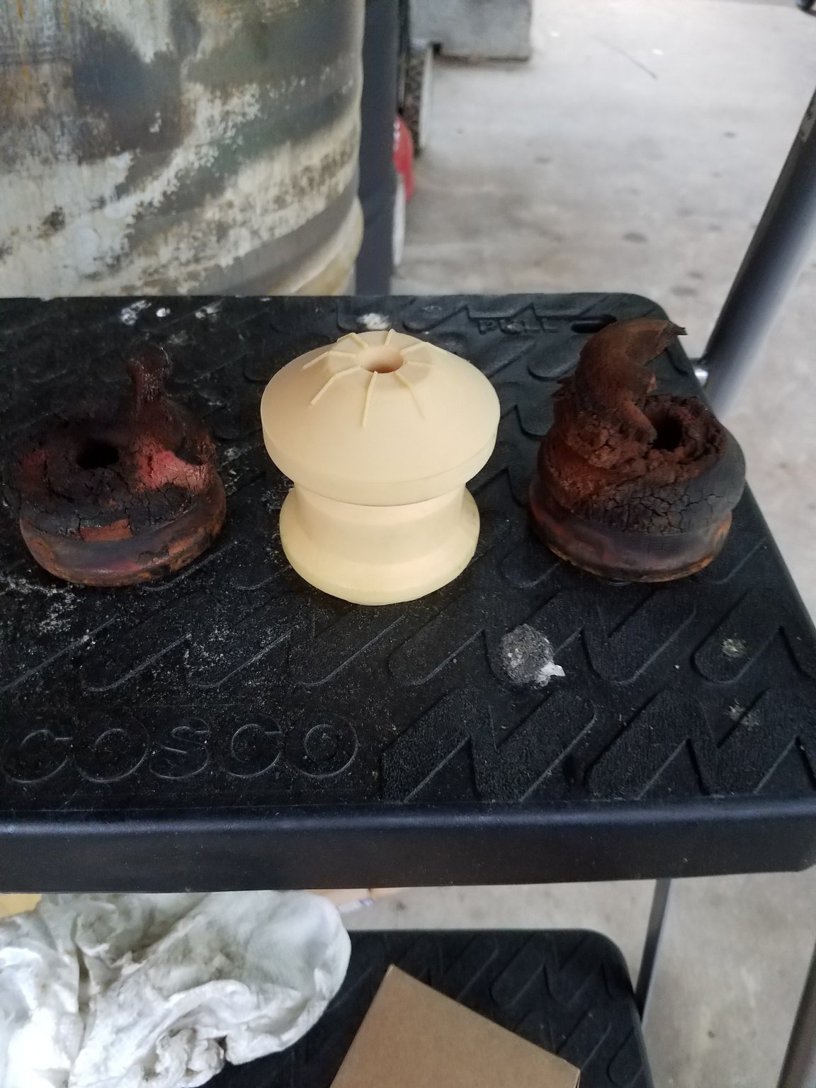

Also replaced the front Bumpstops, jounce stops, bumpers or whatever they're called. Dorman part number 523-089 or GM part number 15153959 if anyone is curious. Easy to install and make the truck ride quite a bit better. There wasn't much left of the old set.
What tools did you need? How long did it take? I'm gonna pick these up this afternoon and have a road trip tonight and was hoping it won't take too long
33,200
51,447
Super easy. You might just need a long flat head to pry out the old ones and some wd40 or any lube spray to twist in the new ones. There's no hardware holding them in.
Does the truck need to be jacked up or can I do it while it's on the ground?

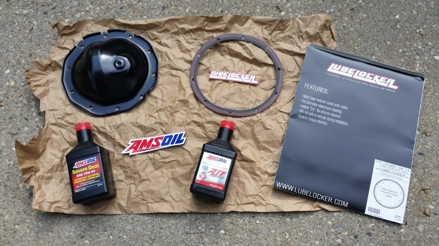

Technically last night, but I changed the fluid in both my front and rear differentials and the transfer case. While I had it apart I installed a new cover on the rear diff and used a LubeLocker gasket when I put it back together.
This was my first servicing of the diffs and transfer case since buying the Yukon. The rear diff fluid looked fairly clean, and had been serviced before at some point. Only a little metal dust on the magnet. The front diff appeared to have never been serviced in the 160K on the vehicle. The fluid was dark and opaque. The magnet was covered in a thick layer of fuzzy metal shaving, but no metal chunks or chips.
The transfer case fluid looked clean, but the big surprise was about a quart of extra fluid came out when I opened the fill port before draining the case. A little research suggests that I have a bad input shaft seal on the transfer case and ATF from the transmission is making its way in. I always check the ATF level before I head out to tow (it's on our departure checklist) and have never seen the level drop. I'll keep an eye on it now since the level in the case is where it should be, I'll see how long it takes to loose a quart of ATF. I guess that's another thing to add to my to-do list.

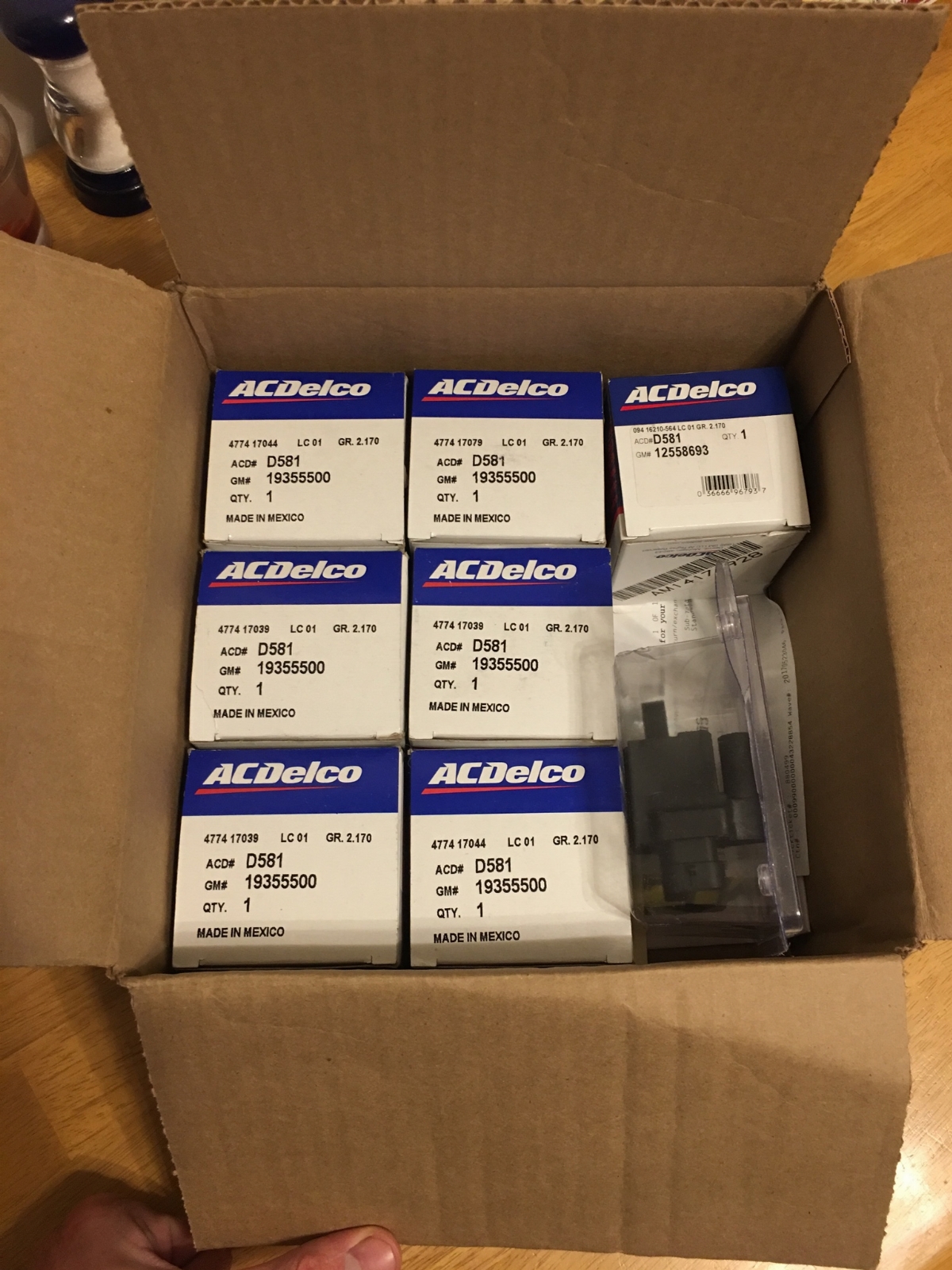

I've got a bad one on either side forget the exact numbers so figured I'd do them all while I'm in there found them for $25 each which is a steal and I'm at 160k so who knows how old the others are
Where'd you get them for $25 ? I might have to replace some myself, waiting for BB to let me know what's up after they analyze my misfire data log.
Edit: just saw your latest post NM.
Edit again: I see you're lucky too, you have the D581's. I have the D585's which are $76 each on Jegs. Ouch.
95escahoe
Aug 2, 2010
5,162
4,466
I did the price match through Jegs using the Amazon price if you notice closely one box says 12558693 the rest are 1935550 which replace the 12558693 coils there identical and in AC Delco packaging otherwise that
