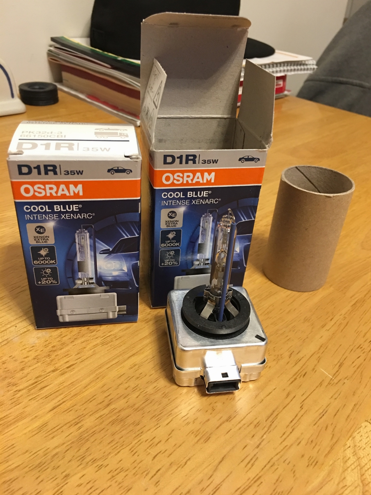

The Osram D1R bulbs came today, the headlights should be here tomorrow
You are going to like them a lot.
Huge improvement over my worn out osrams and the 5000k kensuns.
Don't be too concerned about the "up to 6000k" they aren't aftermarket blue, more like high end mercedes oem white.
That's good to hear, that's a good color
