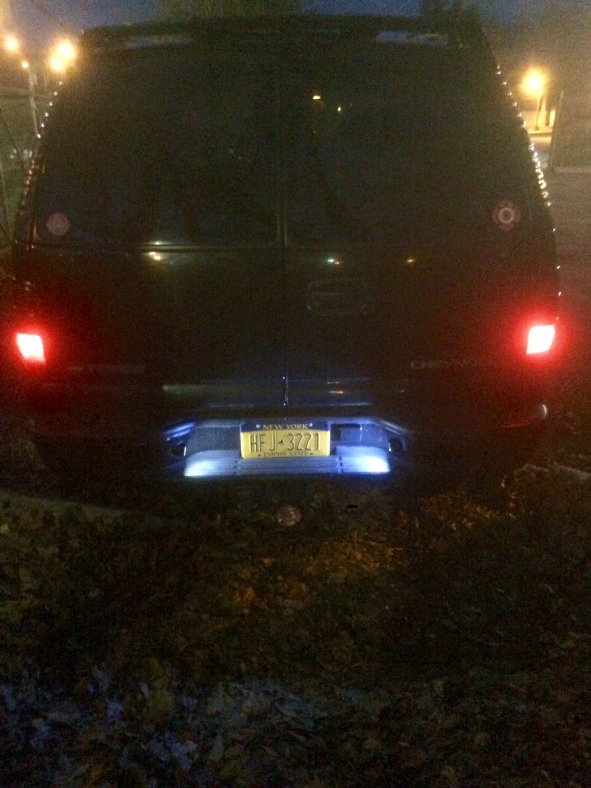

Unfortunately I think so. It was either have license plate lights or have front footwell lights. And I'd rather have all the interior lights be the same than have the plate lights be nice but still have 2 different colors with the interior lights, y'know?
I hear ya. I still have to add those foot well lights in mine.

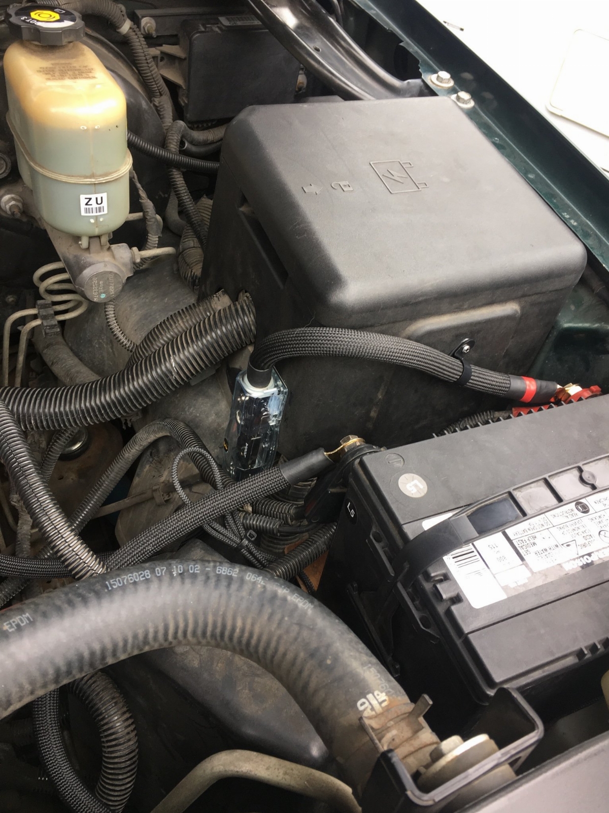

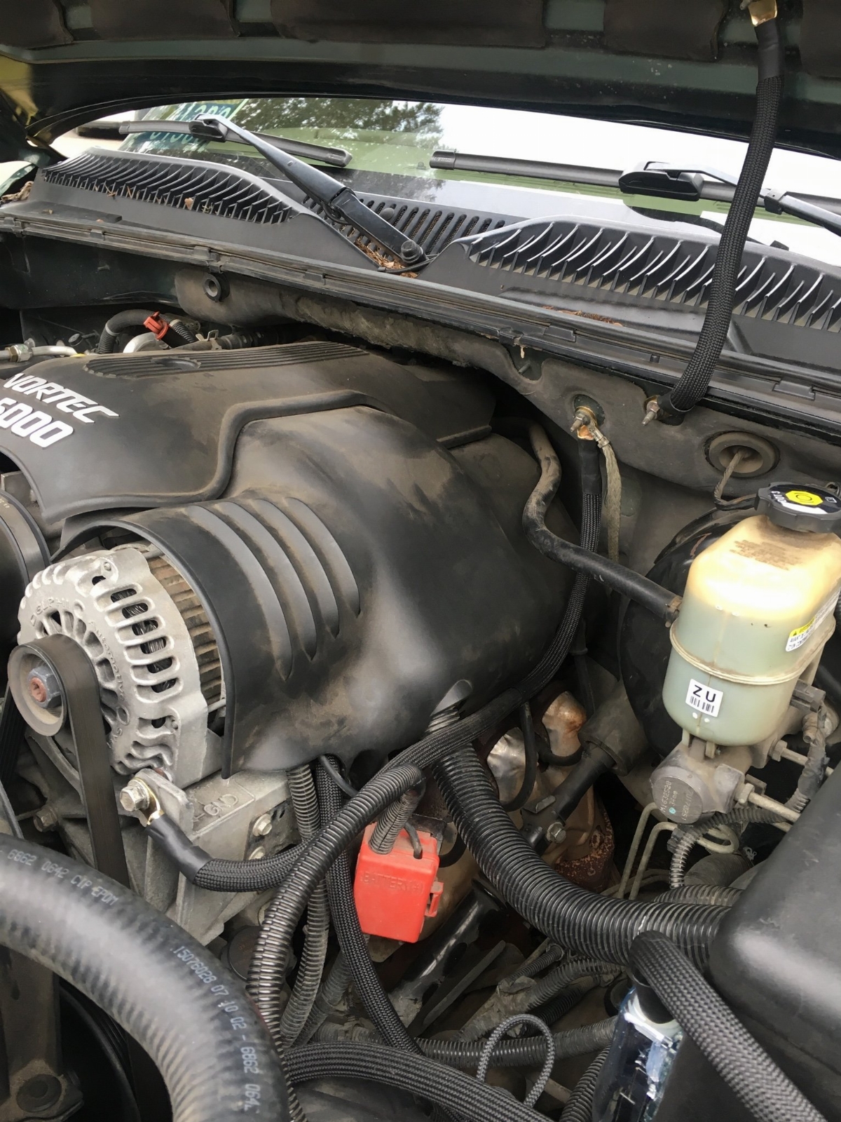

Used the leftover 1/0 gauge I had from my camaros battery relocation to do the big three. Used a stinger fuse box off the battery to be safe and wrapped it all in black nylon techflex because lime greens just too much for the Denali lol
So far haven't noticed too much of a difference, but apparently the people on gmfs have noticed a 1-2 mpg increase so I'll be on the watch for that.
That looks really good. What did you use for connectors ?

I've heard of some led bulbs might be too big for the plate lights, don't know how true that is, but just make sure you get some that'll fit in the housings.
Using LED bulbs in the plate light housing is extremely tight! i managed to barely get them in...just be careful and don't press too hard
Not sure about mpg, but it helps to ease of pressure on the alt/batt/starter and adds like 1-2 db's if you have subs lol
I need to do this.
I have my doubts about the mpg too but I read it on gmfs, so I might as well pass on what I read. so far I haven't really noticed a difference except my check engine light is off now and it usually comes right back on after I clear it.
It's a fun project if you're into wiring and making things look oem as possible.
@1992rs what did you use to crimp the terminals on that huge wire? Is there an inexpensive crimp tool I don't know about because all I see is $$$ ones.
Honestly, I flathead-style chisel and a hammer haha
I actually have a hydraulic crimper from harbor freight that supposedly supports 1/0 but every ring terminal I've used won't fit. It works great on 4 gauge and smaller. After a couple hits with a chisel I can fit 1/0 if I really want to mangle it, but the caveman method can hold just as tight and comes out cleaner imo.
