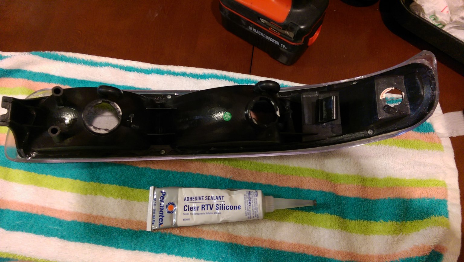

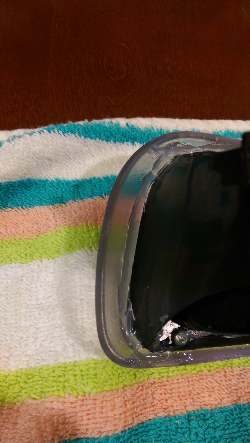

I noticed the other day, parking light lens on the passenger side had moisture in it. Looked this morning and it was much worse. So I took the lens out, used a blow dryer to dry the inside, and put a bead of silicone around the entire inside perimeter of the lens. I then put silicone under the gasketss of the bulb plugs, then ran a light bead on top of the gaskets. I'm going to let them dry, and hopefully it won't let water get inside. I also had to use some silicone on the reverse bulbs, same moisture issue. Those haven't leaked since. I highly recommend doing this if you're running any type of aftermarket lens. View attachment 72456 View attachment 72457
Everytime I buy aftermarket lenses I put a bean on them religiously. Even before I put them on the truck. Rule #1
