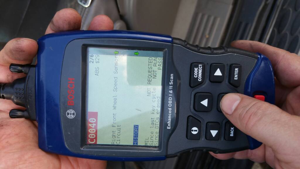

So progress has been made. Got rid of on the c codes for the abs module. Still have C0040 which is the front right wheel speed sensor. I checked it with my multimeter and it is fine. I am getting the proper level of resistance from it. So my next idea is that the Hub might be going bad. The Hub Holt the wheel speed sensor is fine. I know that's not the right word for it and I can't think of it right now. It's the rigid piece that detects when the wheel is spinning. Found a picture online but even that doesn't show the spline that I'm talking about. I also know if the air gap is off from the wheel speed sensor it will throw up the error code. But I have no idea how to check it does anyone else?

So progress has been made. Got rid of on the c codes for the abs module. Still have C0040 which is the front right wheel speed sensor. I checked it with my multimeter and it is fine. I am getting the proper level of resistance from it. So my next idea is that the Hub might be going bad. The Hub Holt the wheel speed sensor is fine. I know that's not the right word for it and I can't think of it right now. It's the rigid piece that detects when the wheel is spinning. Found a picture online but even that doesn't show the spline that I'm talking about. I also know if the air gap is off from the wheel speed sensor it will throw up the error code. But I have no idea how to check it does anyone else?View attachment 72518View attachment 72519

Had to c codes. C0265 i think it was and c0040 is the other. C0265 is gone. Able to fix that last night when I read flowed the soder. Still have the c0040. Just replaced the wheel sensor no less than a month. Tested it again today. I keep reading about the air gap between the sensor and the piece in the Hub. No idea how to check that gap. Thinking the Hub is next unless it can break open to replace the abs gear.

Yah front passenger. Been jacking with it most the day. Done now. Bout to research what i can tonight. Hope I'm making sense. Also. FYI. Only my break light is on now with that code. The abs light is off now.

I've never replaced the sensor by itself but I have replaced the hub. It's fairly easy
