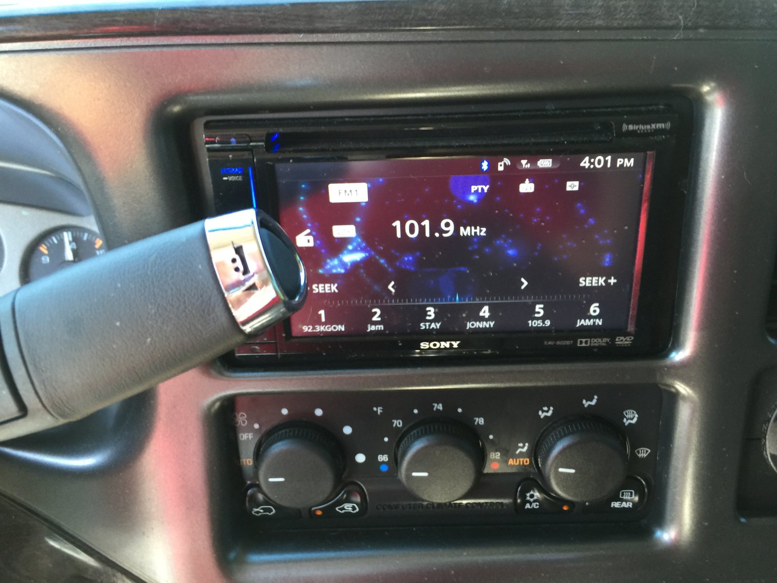

It doesn't limit at all, any DD will fit with a little modification. The brace is easy to remove and once that's out of the way and you install an 03+ cage and bezel you have unlimited possibilities. Here's mine. This mod isn't difficult.
