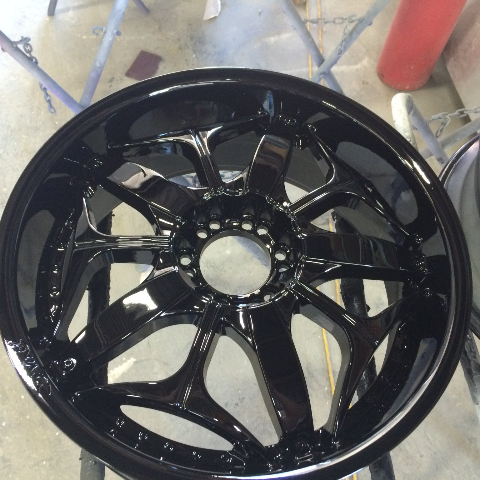

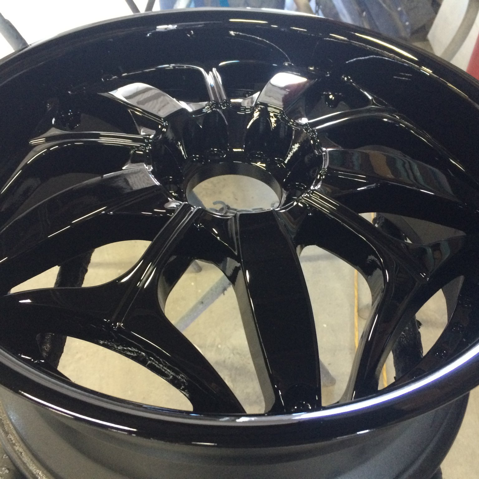

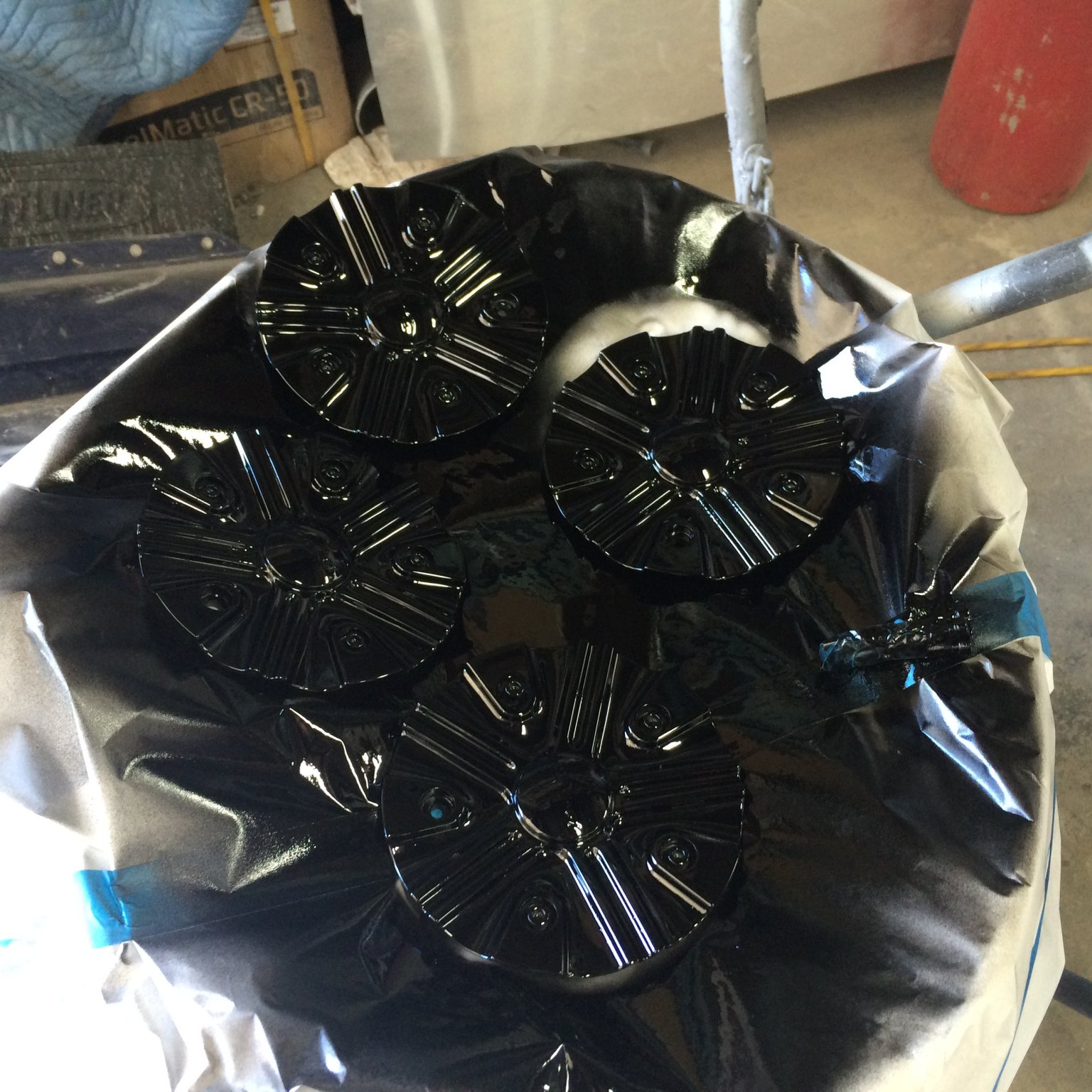

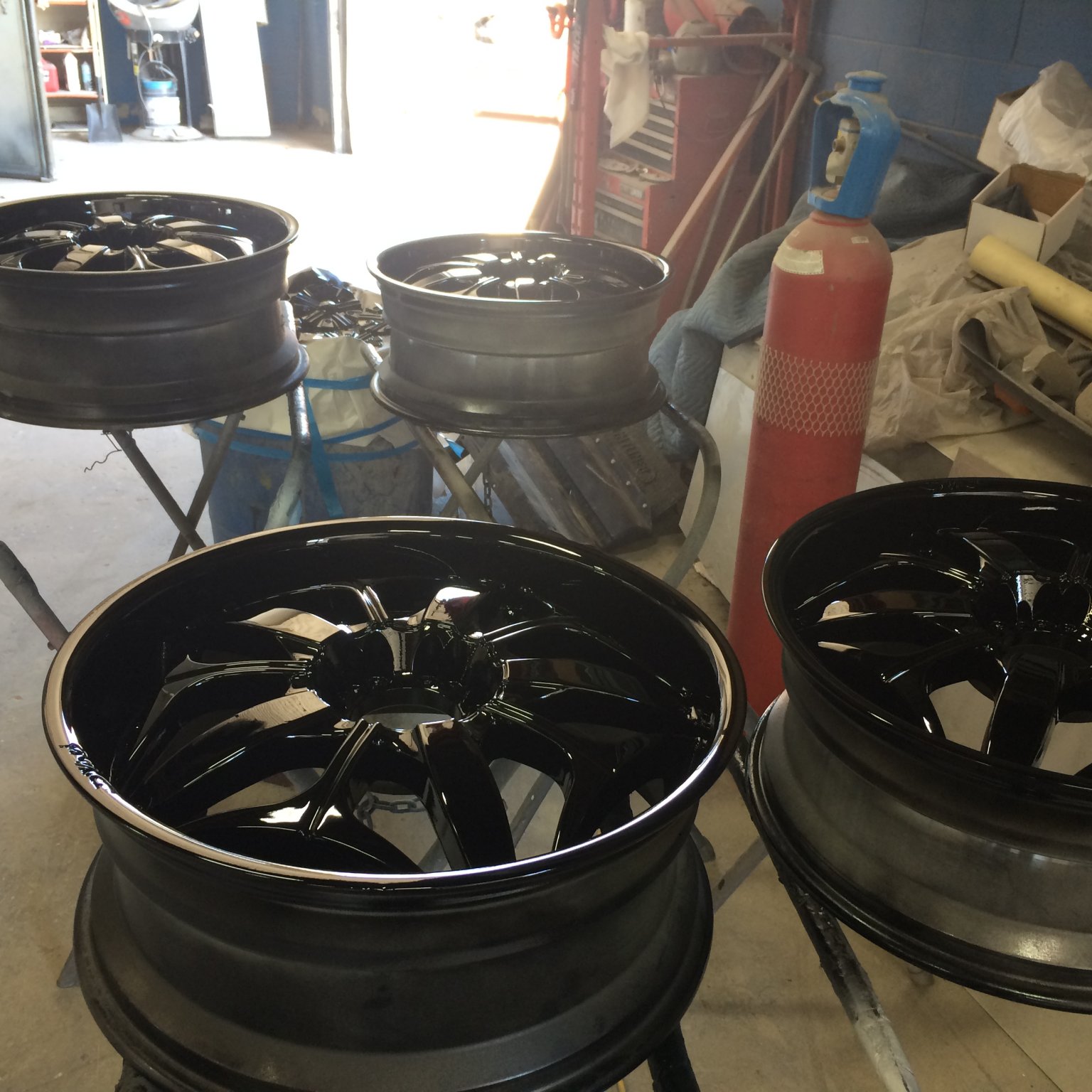

Up date #2. The rims are finshed being painted and rubber being mounted in the morning.

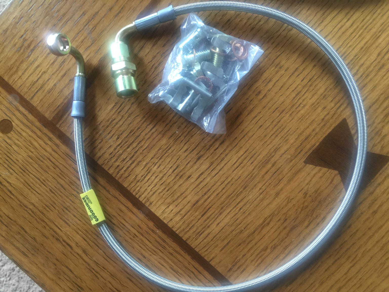

Stared at my braided Goodridge brake lines and decided to go ahead and order parts for my GMT900 front brake upgrade and do it all at once. Then I installed the new OEM blower motor that was delivered today . Nice and quiet and it really blows. Ha.View attachment 64843
Take a moment and count the threads on your break lines. There are different thread pitches for the front and rear brake calipers. I stripped one of them out found out the hard way. Update us when you have them on and how you like to them

The fronts are about twice as long as my rears and the Goodridge lines are exactly the same length as the factory lines so I couldn't possibly mix them up. They use the factory mounting hardware also so it should be good. I'll definitely post pictures when I do it.
