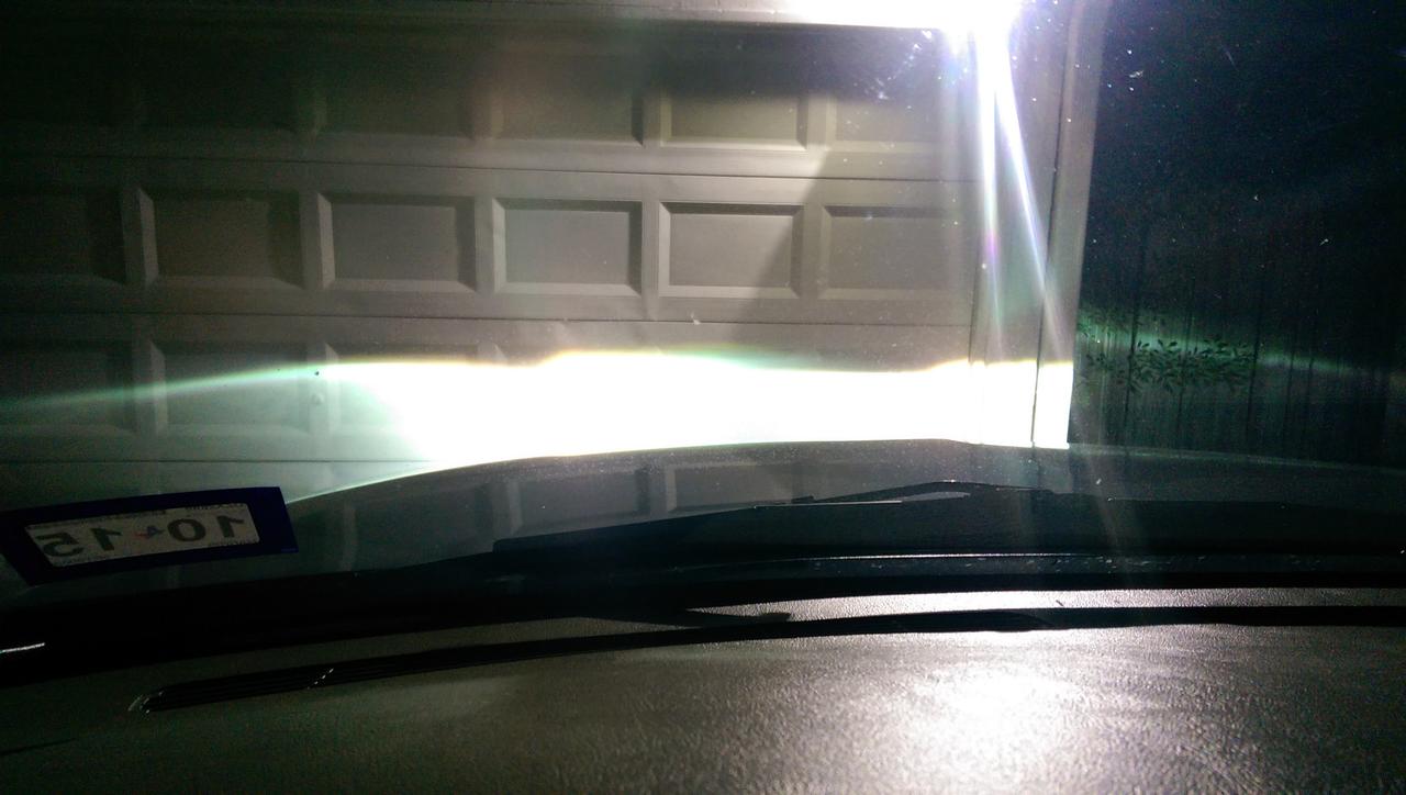

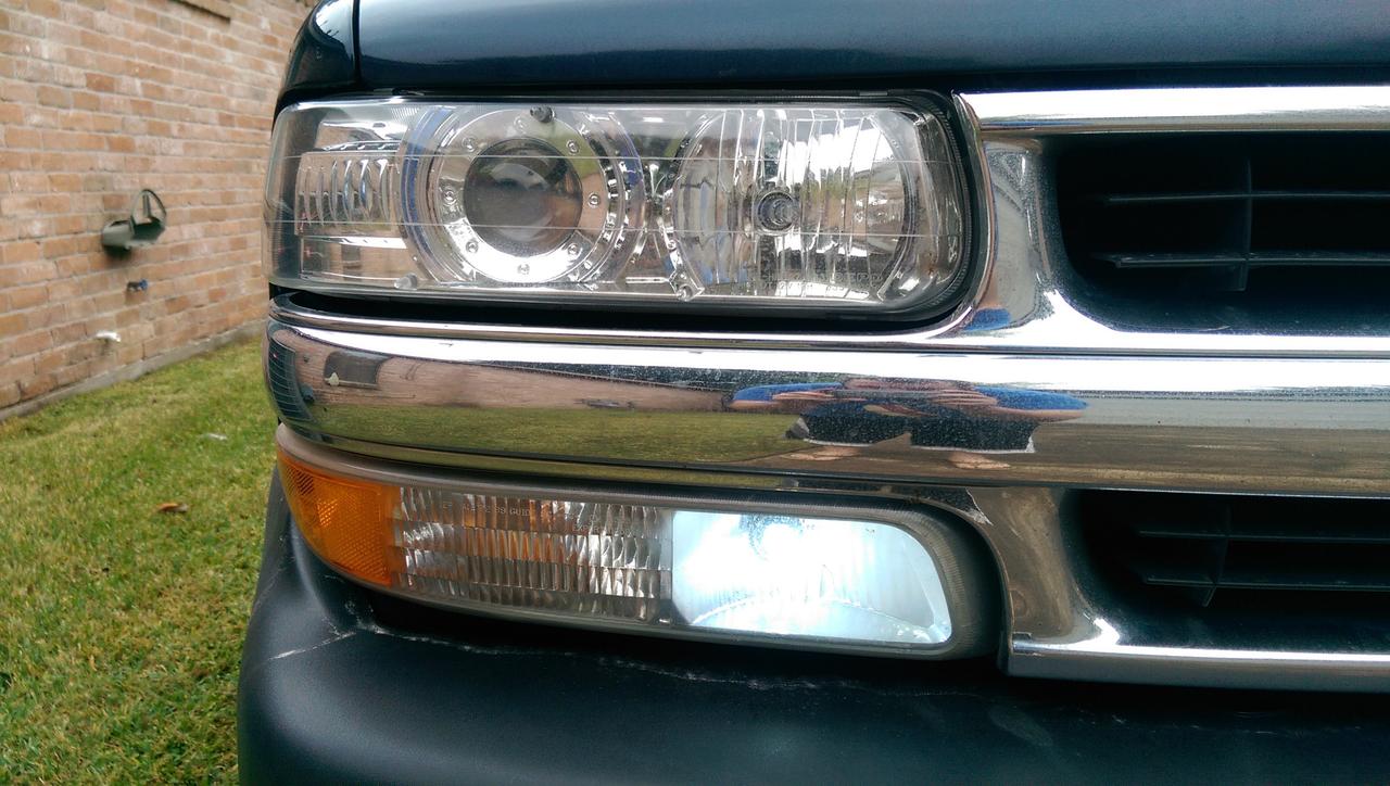

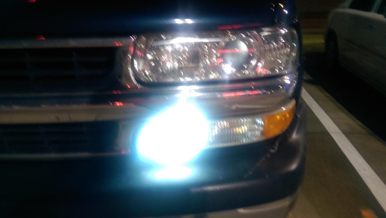

I have some like that. they are fine in reverse and turn applications, but as DRLs the leds burn out one by one fairly quickly. Mine are almost a year old and about half of the leds have burnt out.

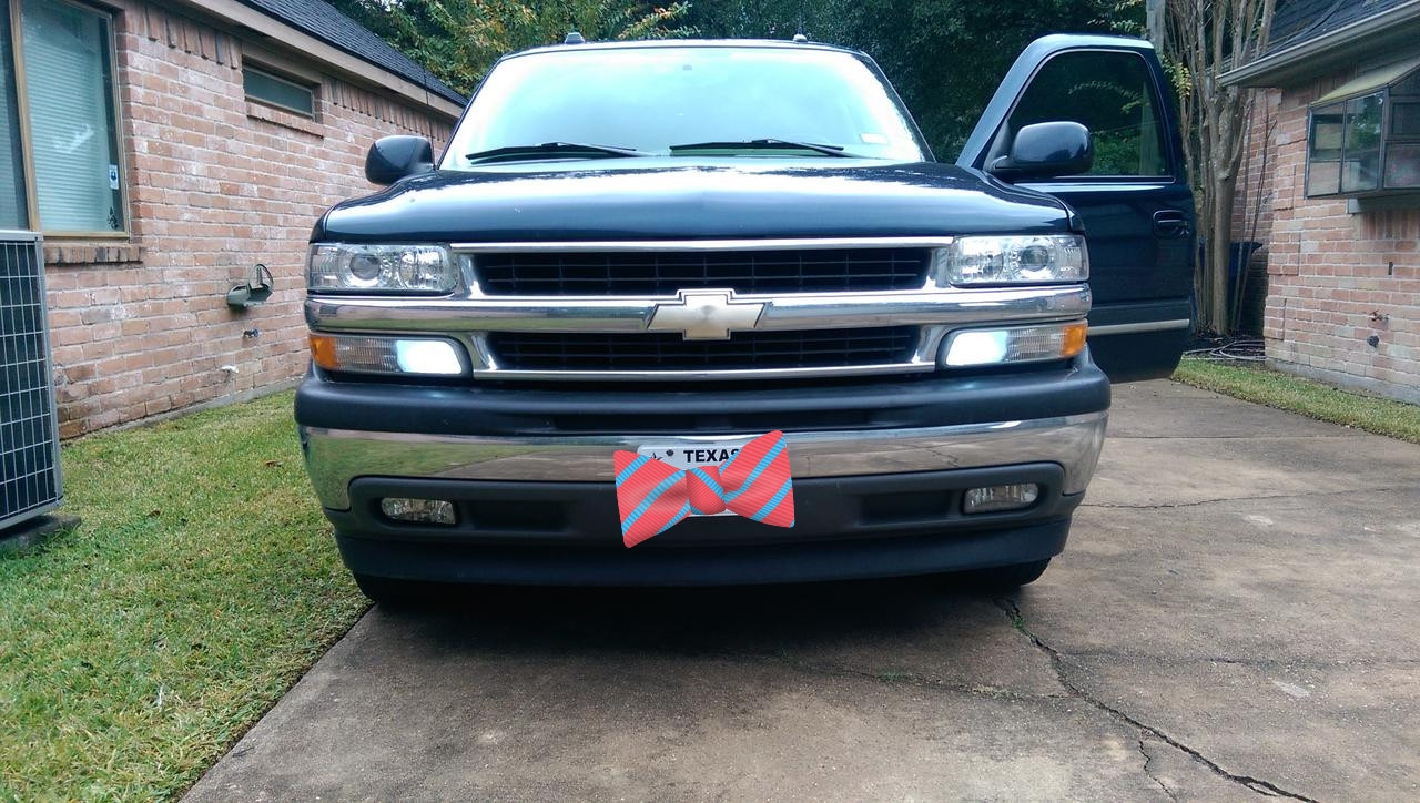

here are a couple shots of the DRL replacements i got.
this is at night when unlocking it
during the day with the truck in drive

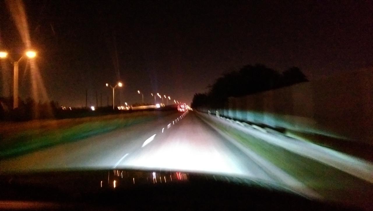

also added a relay harness for the HID's stopped the flicker i was getting as well as made the light pattern better overall. I dont think the HID's were firing completely off the stock wiring.

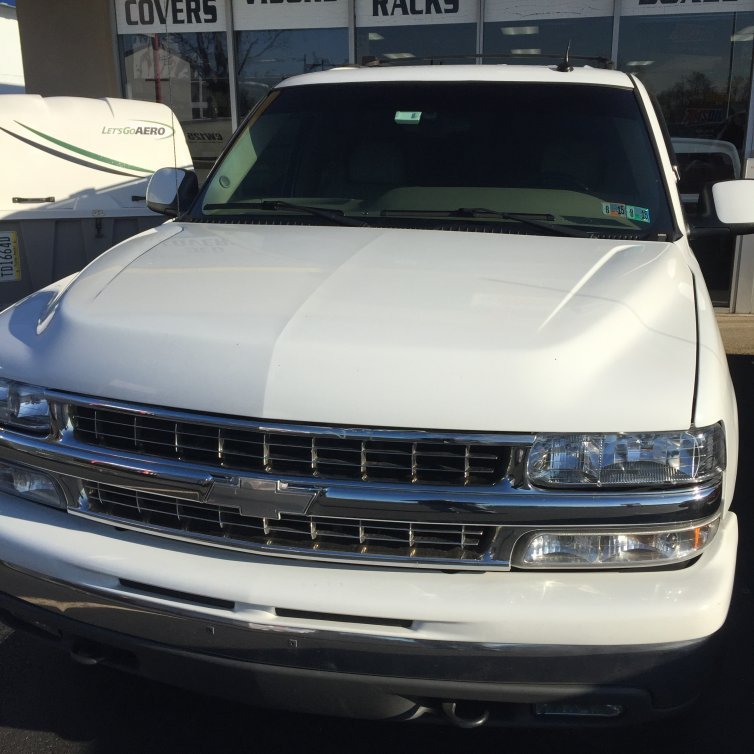

I was on my way to work this morning and saw my buddy on the side of the road with another vehicle. They had a fender bender. When I went to check on my buddy, another vehicle struck and broke the driver side mirror on my suburban. I went to pep boys to pick up a cheap manual mirror. Changed it out when I got home. I also ordered new mirrors.....btw, Happy Thanksgiving to all
