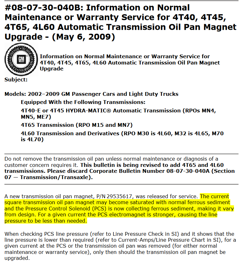

Nice simple solutions. Need to drop the pan sometime soon for a filter so I'll have to do these. Thanks for the info! I always planned to do a screw on filter. I have had these laying around for an embarrassingly long time: https://www.amazon.com/gp/product/B0014BHVRO/ref=ppx_yo_dt_b_search_asin_title?ie=UTF8&psc=1
