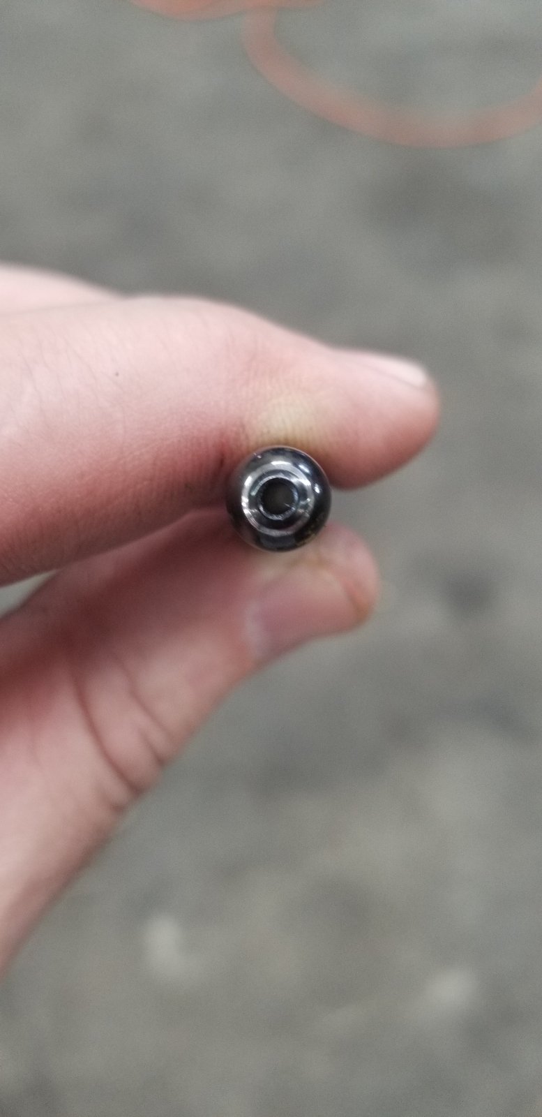

Out of everything that can be affected by the shrapnel from a roached cam bearing, the pushrods are the least likely to be harmed. Just look at the tips to make sure they aren't scored from metal in the oil. They're probably fine. If they were sized for the cam you had, then you may or may not be able to use them if you get a cam with considerably lower or higher lift.
32,178
48,591
Don't see why not as they do directly touch the cam. Send a picture of them.

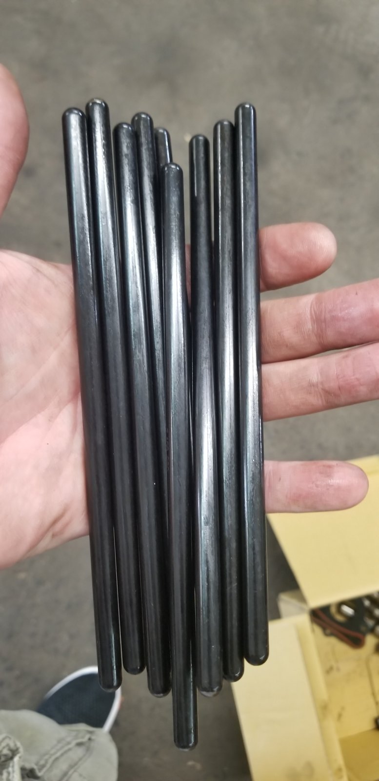

Here's most of them--they look ok.
Post a pic of the cam too if you can. That sucks its toast any idea what cam your going to go with this time?
I posted a pic in my 1st post. Damn thing is stuck, only comes out 1/2 way.
Pushrods should be fine, I don’t see how they could have been damaged. Awesome to see it getting worked on, it’s been a long wait hasn’t it?
