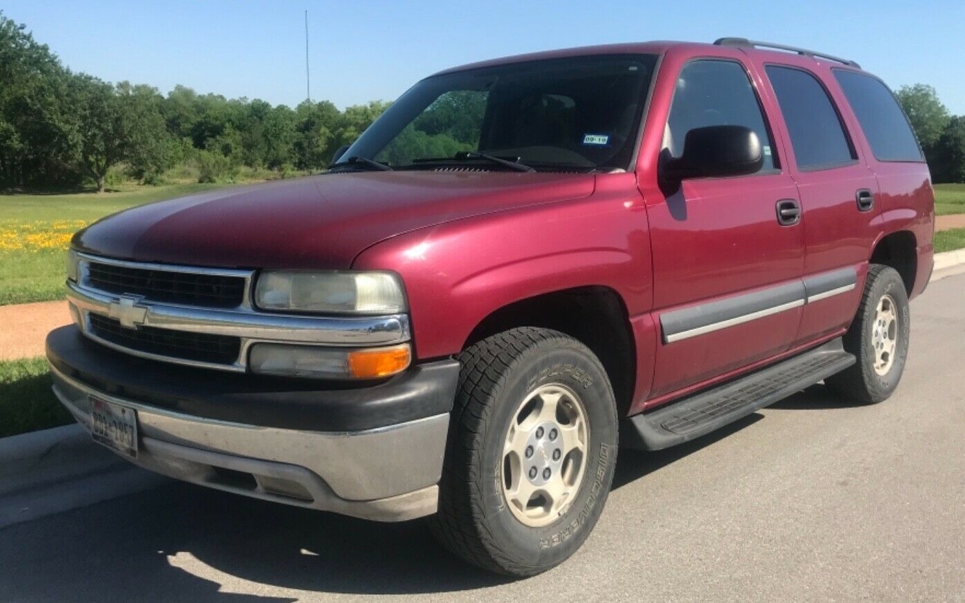

My 03 Tahoe is getting kinda rusty, so I went to Texas and bought a replacement, an 04 LS.
I transferred the DJM 3/5" suspension, big brakes, PPV wheels, and front air dam. Debadged it, buffed the paint and installed new lights and LED interior bulbs.

Gonna keep the running boards on for the winter. Still unhappy that the DJM lower control arms did not deliver the full 3" front drop as promised. Might put 1/2" spacers in the back (if I can find some), depending on where it's parked it sometimes looks a little nose high to me.

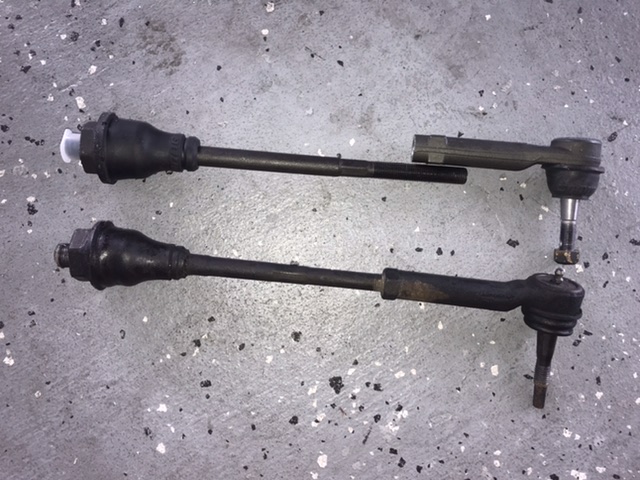

Finally found a day to change out my tie rods. Whack with the BFH and both sides broke free.
Here is a pick of the OEM and Moog problem solver ready to go on.

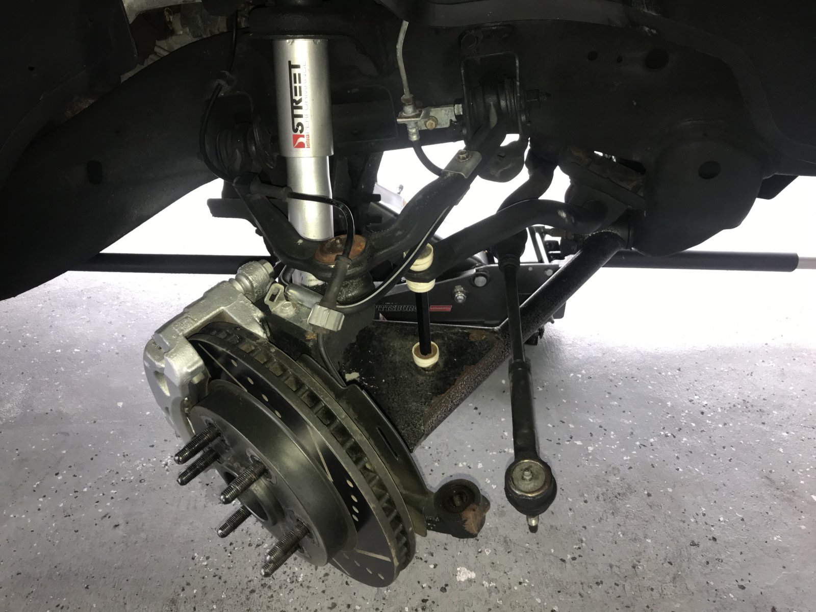

And digging around I see the upper control arm bushings are a little cracked. It can wait if needed. Only the lower arms were replaced when it was lowered. I wish I had done the uppers, but it was $$ at the time. Nonetheless, Moog, Energy Suspension or other doe anybody recommend?
Doesn't have to be today as I need to get the tie rods buttoned up and was going to go get it aligned ASAP.
Can I change out the upper arm bushings later without an alignment? Rather not have to pay for an extra alignment and hopefully he doesn't find anything else when it goes on the rack. Thx.
