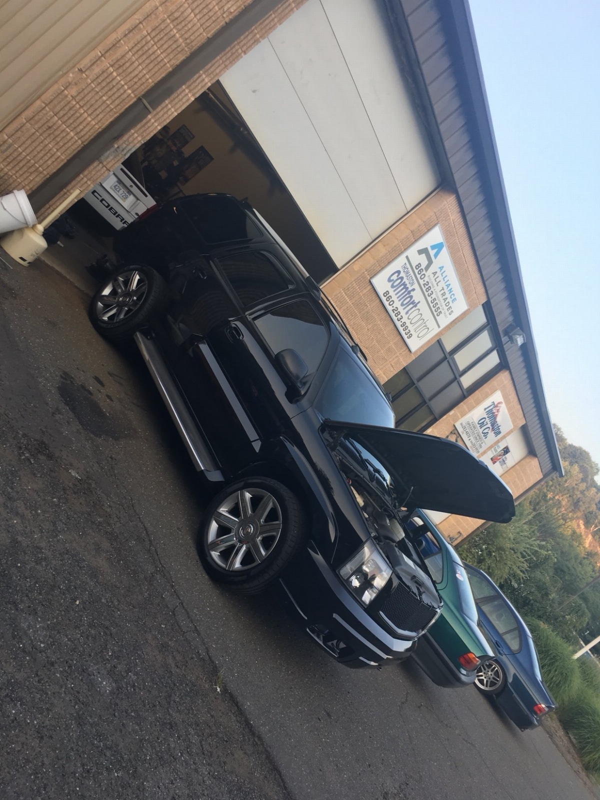

Had the wiper holes welded up today
They didn't paint it yet?
Nope I gotta bring it back to the bodyshop in the next few weeks when they have time to paint it, they wouldn’t weld the holes up due to it being aluminum so had to have someone else weld it, came out pretty good I don’t see any warping
