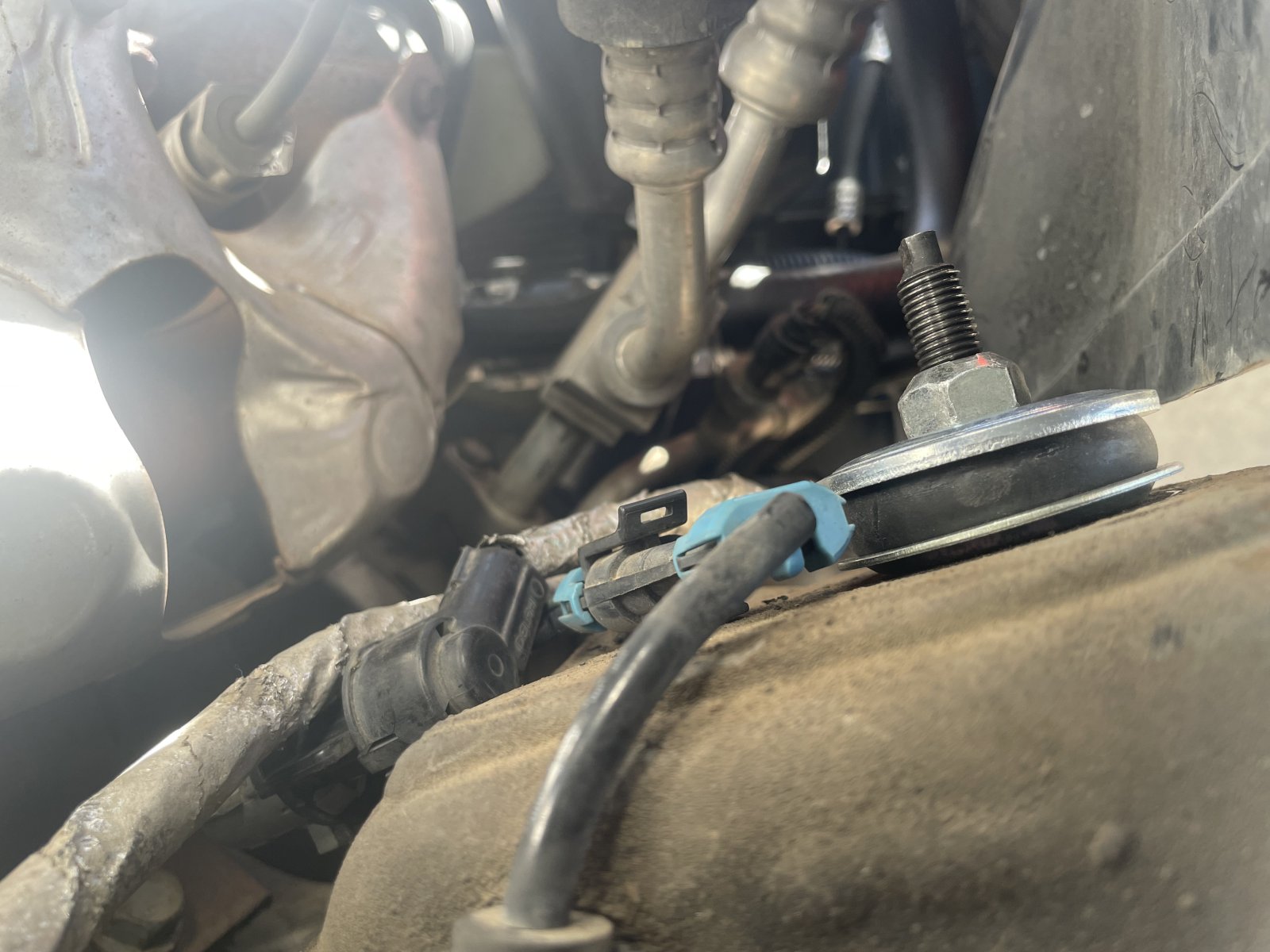

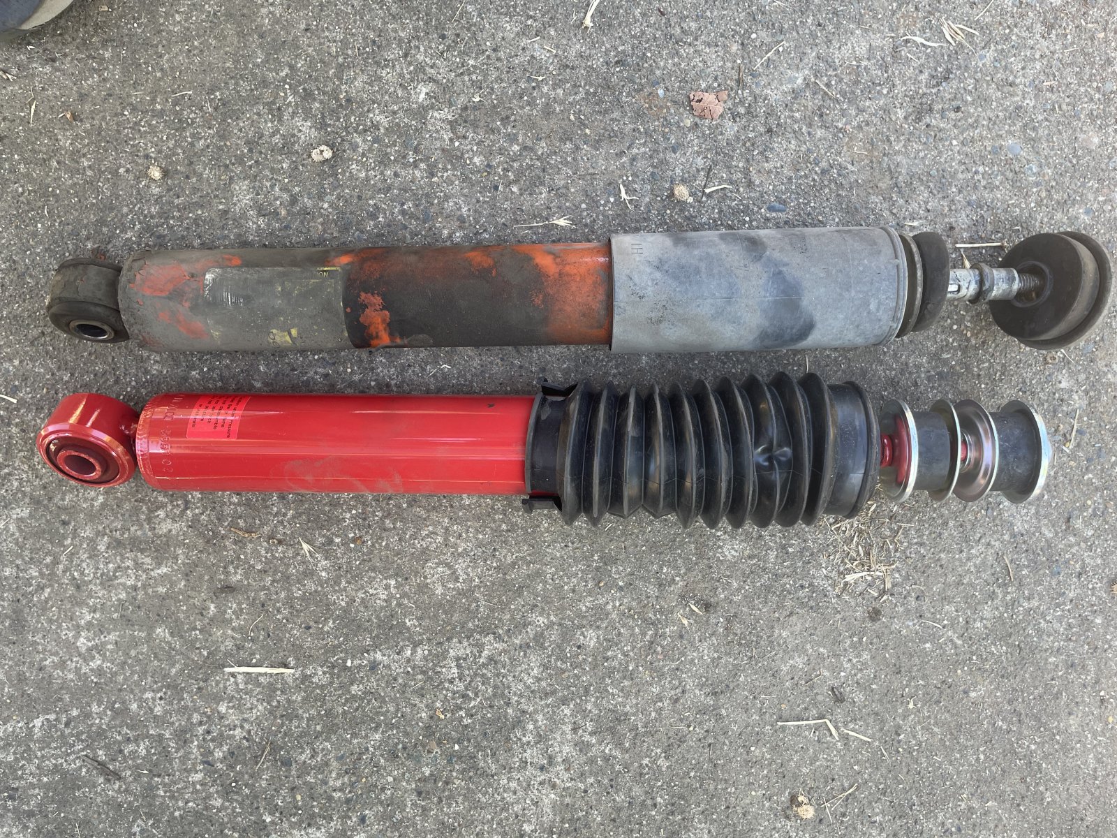

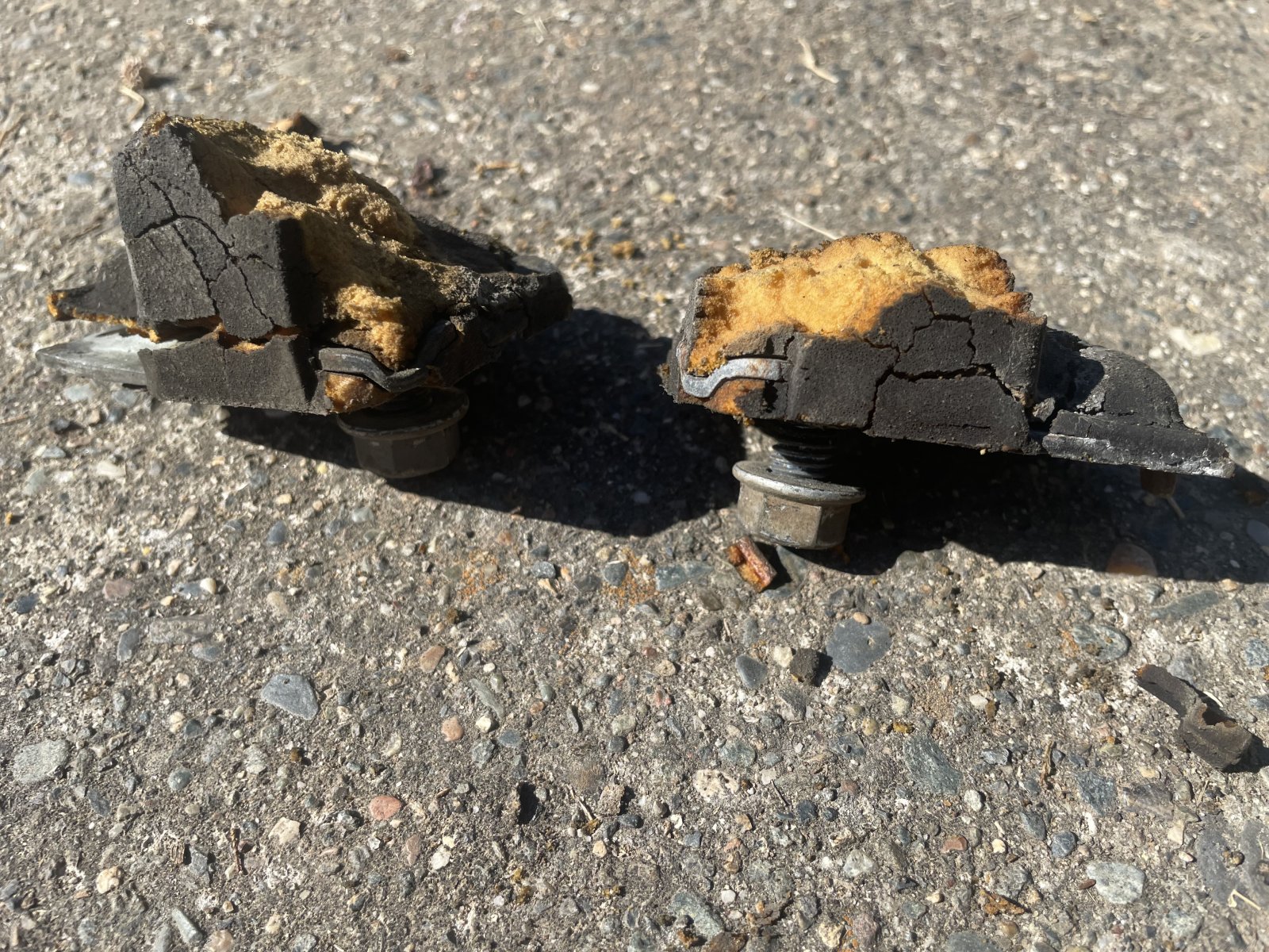

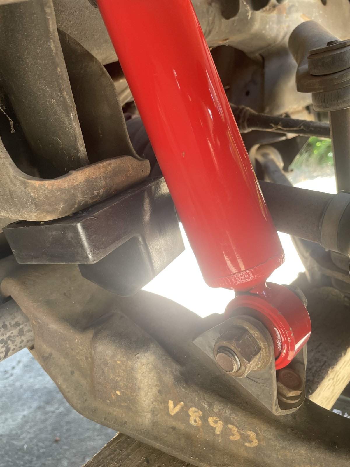

Installed front kyb shocks and mevotech bumpstops.. Maybe install rear shocks tomorrow..
Old bumpstops...
Old autoride shocks vs KYB monomax..
Hopefully I didn't overtighten the upper shock mount? Too squished?

Yep, the emblem I removed said "LT autoride". The stiffer KYBs feels better to me, less floaty.
Plus I couldn't find replacement Z55 struts for the 2500, so I figured it was only a matter of time.

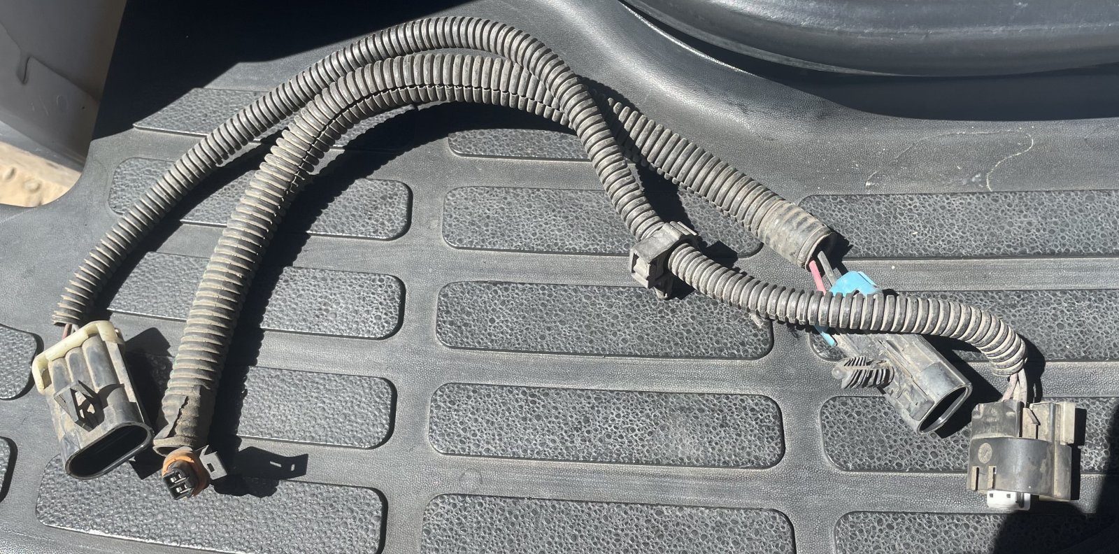

Removed the height sensors also, the left rear had two extension harnesses, one for shock and one for height sensor..
It's like GM made the main harness too short on purpose and added some wire.. (plugs are different on the ends of extension harnesses)
KYBs were approximately 1/4" longer in front, and 1/2" shorter in the rear at full extension.

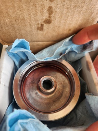

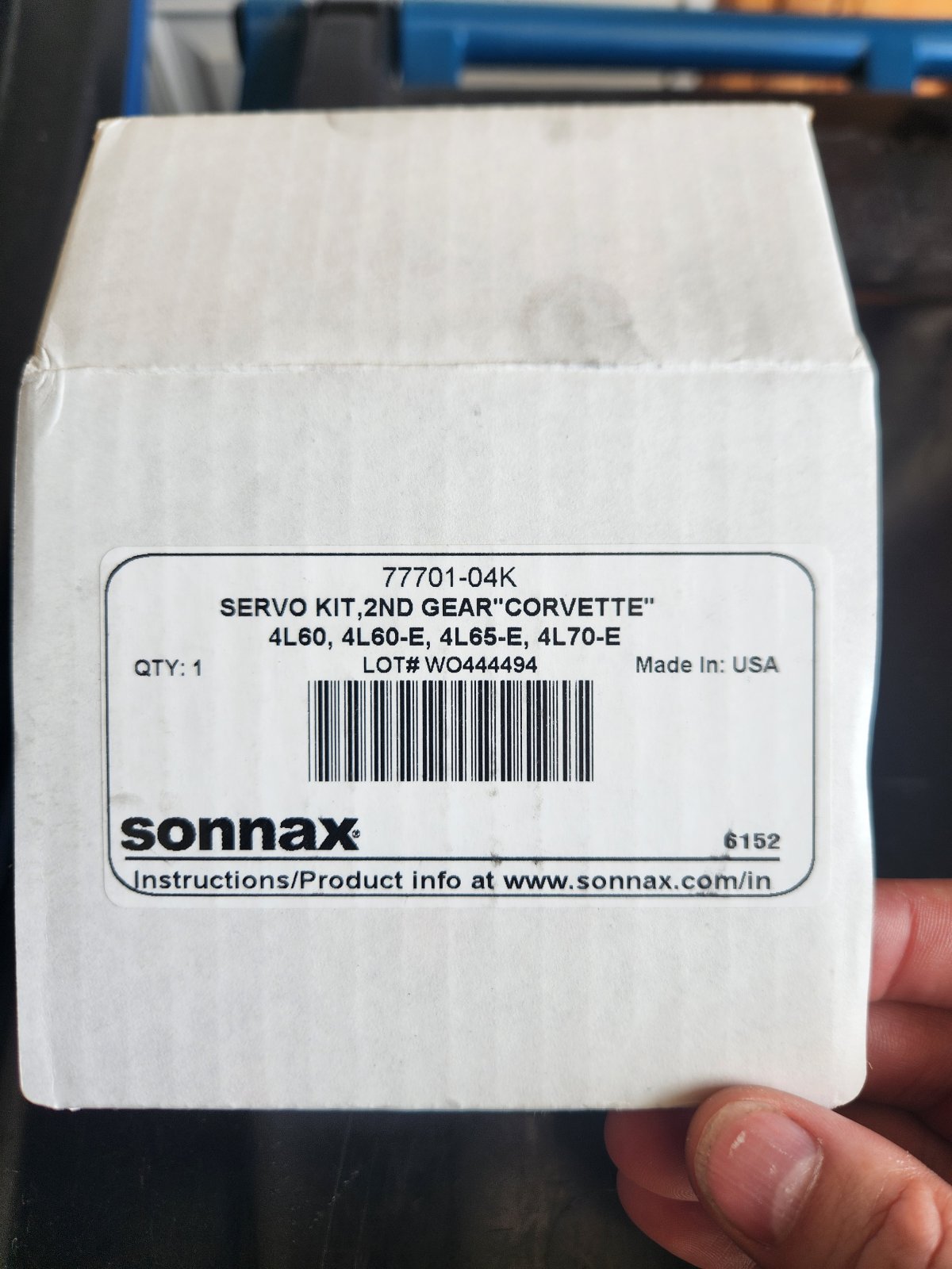

Finally had some time to finish my trans hard part updates.
Got my sonnax corvette ratio servo installed. Super easy job on these trucks. I was done so quick I forgot to take pictures. Enjoy an image of the box and old parts in there for safe keeping. Lol
FYI the sonnax kit does NOT include a cover gasket and I lost my first.one so I had to order a second from rockauto.
Now I just need to get out my pc and work on the trans tune a little.
