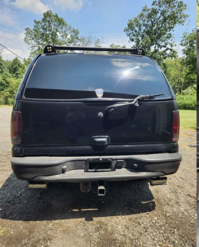

I know there was a thread in here about being able to put LEDs in the roof rack on a Z71. Screenshot_20241105_103210_Samsung Internet.jpg

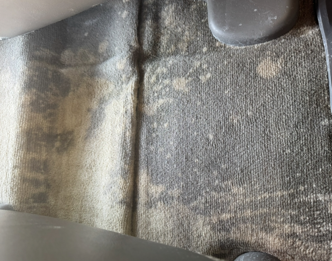

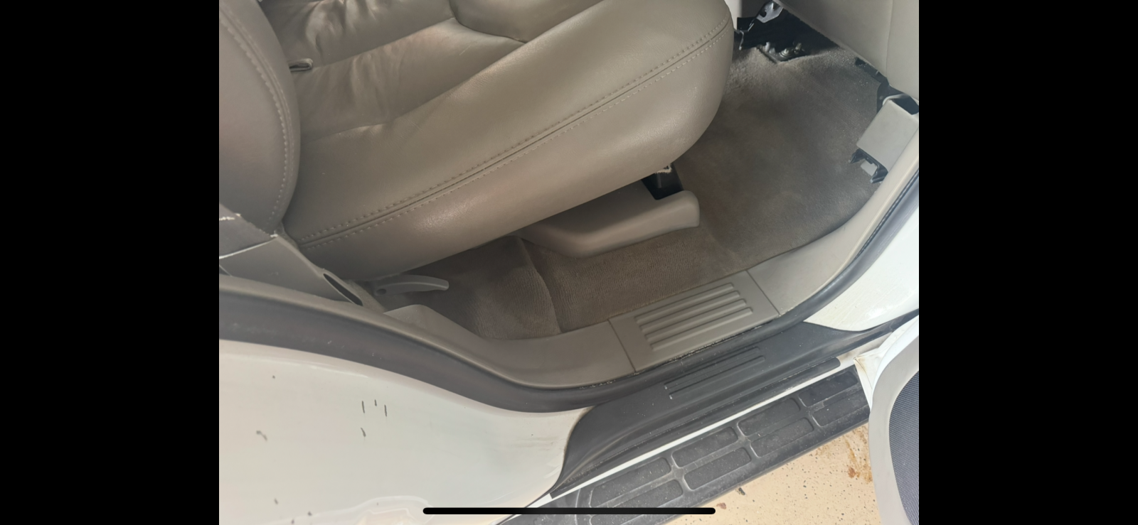

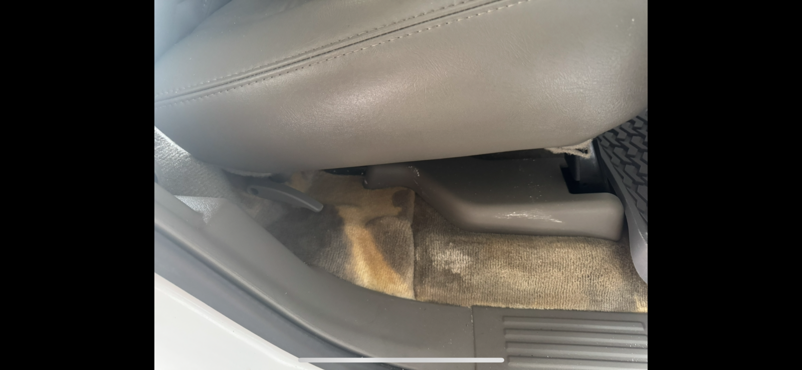

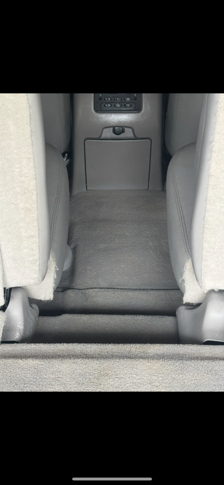

Spray painted the carpet. Yes spray paint. It was heavily damaged by a 2 1/2 gallon container of pool chlorine (twice as strong as bleach) that toppled over and the lid popped off on because person in front of me HAD to stop for a just turned yellow light. Aaaarrgh!
Anyway, used the duplicolor HPV109 medium gray vinyl/fabric paint. It’s close enough for me. Looks way better than huge bright yellow stains splattered between the seats etc.

Wow, looks great. How does it feel? Hard, or does it feel normal?

WOW. That actually looks impressive!
I saw your previous post and was going to recommend that product. I've been using it on interior plastics and even on the leather seats after a bit of touch up on small repairs. I just haven't used it on carpet, so I wasn't sure...
My house has brown carpet my wife discolored when she put a bottle of bleach near the restroom door. I think I'll try some of that stuff in brown.

Seems to feel fine. I didn’t lay it on thick and used a stiff brush the brush it right after in hopes of keeping from being crunchy. Surely a little stiffer / crunchy than before, but the trade off is well worth it.

This is incredible work - great job!
