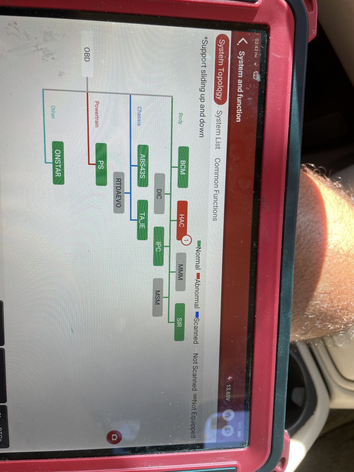

These are all the modules I can see. Under engine data there was misfire, fuel trim, EVAP, I/M readiness data streams none of which showed fuel pressure (or engine oil pressure which I was interested to find).
that must be a low end scanner if it cant show you ENGINE data, all you are looking at there is topology
dig a little deeper in "powertrain"

Yes I was just showing the topology to show what modules exists. There is no FPCM.
If I go into the powertrain module, I can look at livestream data for probably 500+ parameters (all under various sub-categories like fuel trim, evap, misfire, etc)... which I have already done. I just can't see anything on fuel pressure or oil pressure...
It is probably a mid-end scan tool. I have programmed ABS modules, and other similar modules for 2010 vintage vehicles. Programmed keys for vehicles up to 2016 year model (it can probably handle all functions up to 2020 year model). I can tell already it won't recognize our 2024 Suburban, so I was disappointed. Probably need to pay for a software update.
If I go into the powertrain module, I can look at livestream data for probably 500+ parameters... which I have already done. I just can't see anything on fuel pressure or fuel trim.
It's not the scan tool. GMT800s don't have an active fuel pressure PID. Gotta measure it at the fuel rail with a gauge.
Yep! I sort of guessed that as I was tracing the fuel lines later yesterday. Of the little bit I saw (line from tank, to pressure regulator, out from regulator, I was hoping to find a pressure gauge of some kind.... was basically looking for wires to/from..)

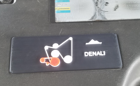

Designed, installed and 3d printed a new belt routing decal. A replacement one from GM is $25 USD, that's crazy for a sticker. So I designed my own and made it not in French, not for 4 types of engines, made it the match the size of the spot and added a little bling to it. Plus if I can't see I can still feel the route of the belt.
I need a better camera, the color is red not orange but you get the gist.
