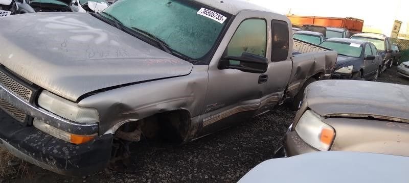

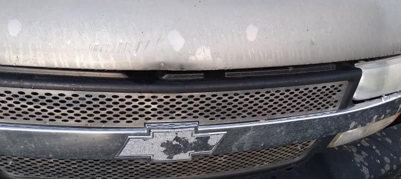

Still looking for an HD hood to do a Yukon conversion on. I found one fairly close, it’s even the right color so I wouldn’t have to paint the underside, but it’s got a dent right in the front edge. Anybody know if this is easily repairable from looking at it? I might have to ask my body guy. I’d have to cut the headlight areas out so there’s already going to be some body work on it.

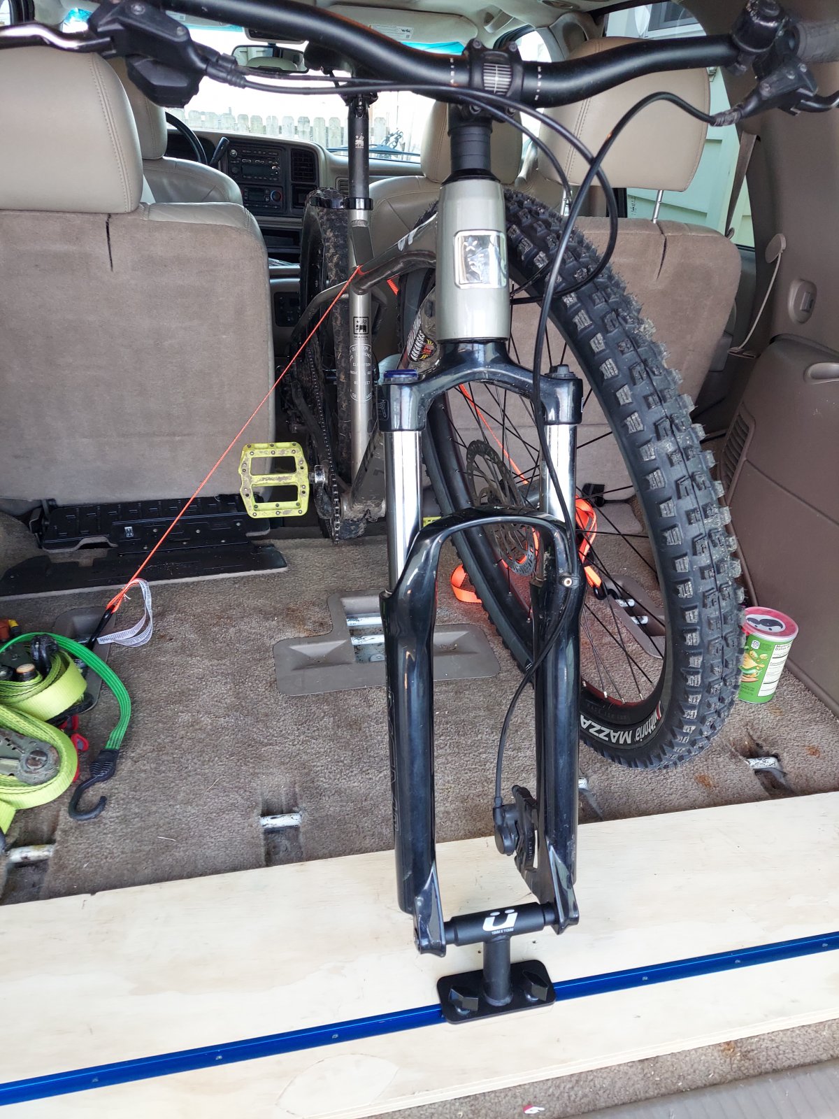

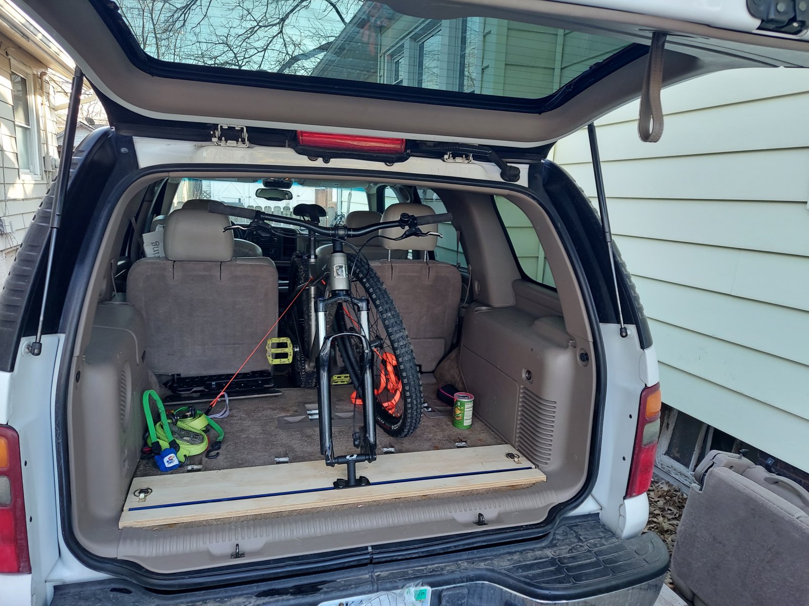

My Mountain Bike Carrier set up.
I'm brand new to the Yukon world. Just picked up at 2003 Yukon SLT with 240k mi. I'm coming from the 4Runner world, so it's a big size upgrade. Now, it's time to personalize. First up, figure out how to load my mountain bike. I haven't seen much of people carrying them inside, except for fully converted camping rigs. I need all 5 rear seats, so I wanted to do something that would set up and tear down easily. I set it on a track so I can load it on a side, instead on center, if I ever need more space. I think it will meet my versatile needs while remaining secure.
This was my plan:
Plywood
Kreg mini trak
Kuat Truck bed fork mount
Lynch Pins

Looks great!
I think that would be a a challenge for a lot of people, but the right body guy (or gal) should be able to handle that with ease. The ones who have the experience / know how, have some amazing talents. Good luck. I hope it works out! I want to see this on the Beast..!
This was my plan:
Plywood
Kreg mini trak
Lynch Pins
Looks good. How about some pictures of your rig!? Welcome, from Texas!
If it's cheap enough, I'd grab it. Imo that wouldn't be a difficult repair. Like you said body work will need to be done anyway.
26,678
52,941
They want $300. I can’t even find a new aftermarket one, they’re out if stock unless I want to pay $800+. I’ve seen used ones in perfect shape on car-part going for $600+. I think I’ll ask my body guy what he thinks about it.

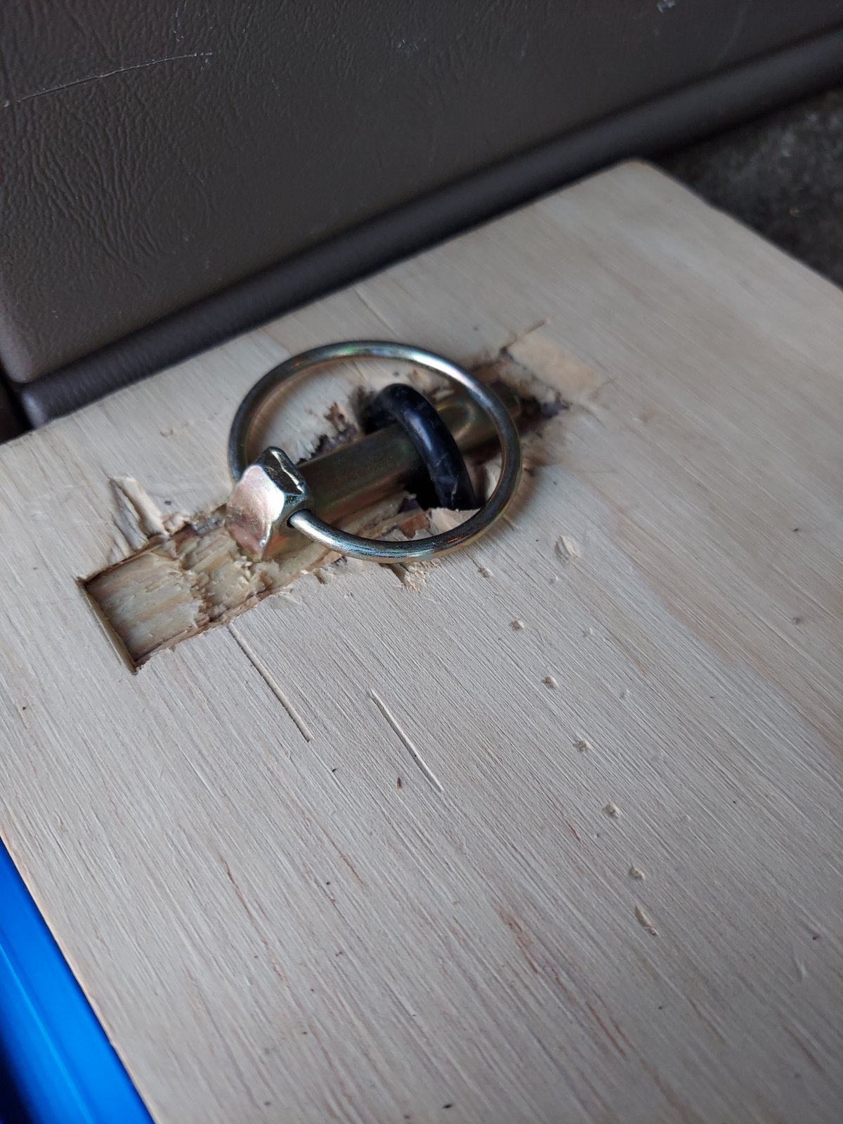

This was my plan:
Plywood
Kreg mini trak
Lynch Pins
Nice! You could also possibly use the slide-bolt side of a latch like this... So you don't have to track loose pins. It could stay attached to the board all the time and not get lost. Not criticizing anything in the design... Just brainstorming.
That's a good idea. I could have use a lynch pin with a little cable attached, too. I didn't even think about how these loose pins could go missing.
Not the same body guy who laid the paint I hope
