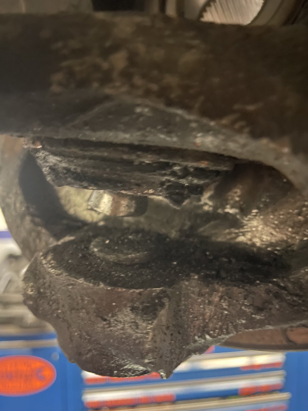

The passenger side lower ball joint was bound inside the knuckle and had to be cut out. This was a horrible start to the day and added some hours of cutting/hammering/torching:
To get the rest of the balljoint out, I ended up needing to pull off the whole knuckle. You can still see the rest of the ball joint in this pic with the knuckle. After I got it laid on the bench, I used tension from a balljoint press and heat to finally coax it out. When it broke free, it shot out of the knuckle and flew across the shop.
