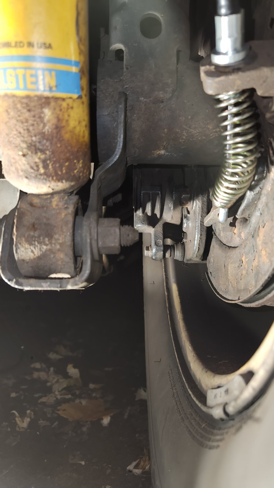

Getting the connecting clip between the front cable and intermediate was fun, but I managed to get it off. Getting the rusty nut off the equalizer took a little patience and effort, but got that too. If I can at least get the cables done, the mechanic can futz with adjustments tomorrow and hopefully get an inspection done by Tuesday morning.
P.S.: My 04 has no rubber plug/access slot to access adjustments from the rear like most YouTube videos show... The only way to make any adjustments is having the rotors off.
BTW, Haynes specs the setting as 0.026" between the shoe surface and the rotor hat. Here's what the book says: without measuring, turn the adjuster screw until the shoe lining just drags on the braking surface, then remove the rotor and back off the adjuster screw until the shoe doesn't drag.

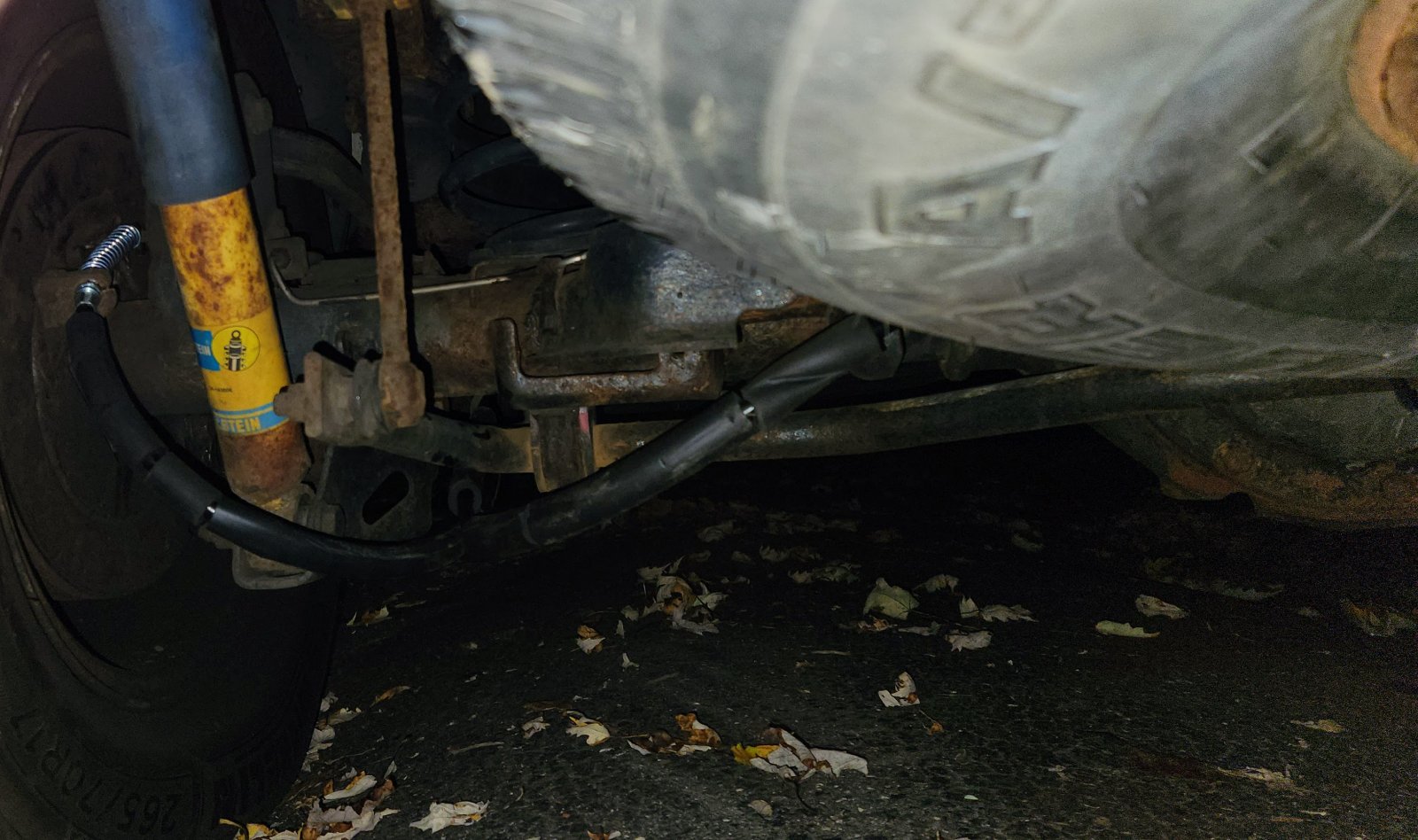

While crawling around getting parking brake stuff ready to RMV inspection, I noticed an exhaust isolator hanger was hanging by one side and a clamp on the back of the muffler split.
Replaced both. Hardest part was getting the old hanger off! The original had a band of steel embedded around the perimeter. Fortunately, that steel band was crumbling apart from rust. I was able to cut it off the mounting pins with a knife.
A new stainless band should also take care of what looked like a small leak at the the joint.
Also a little late-night driveway work on installing new parking brake cables...
Thanks to @Fless for responding so quickly with a photo of the passenger side, that I forgot to take before removal of the cable end!
I wasn't able to get the parking brake where it needed to be, but I got cables in place and attached. My mechanic is on it now for me... I ran out of time trying myself and was not getting things where they need to be to pass RMV safety inspection.
I did the best I could, but knowing limitations before breaking something is not a bad thing.

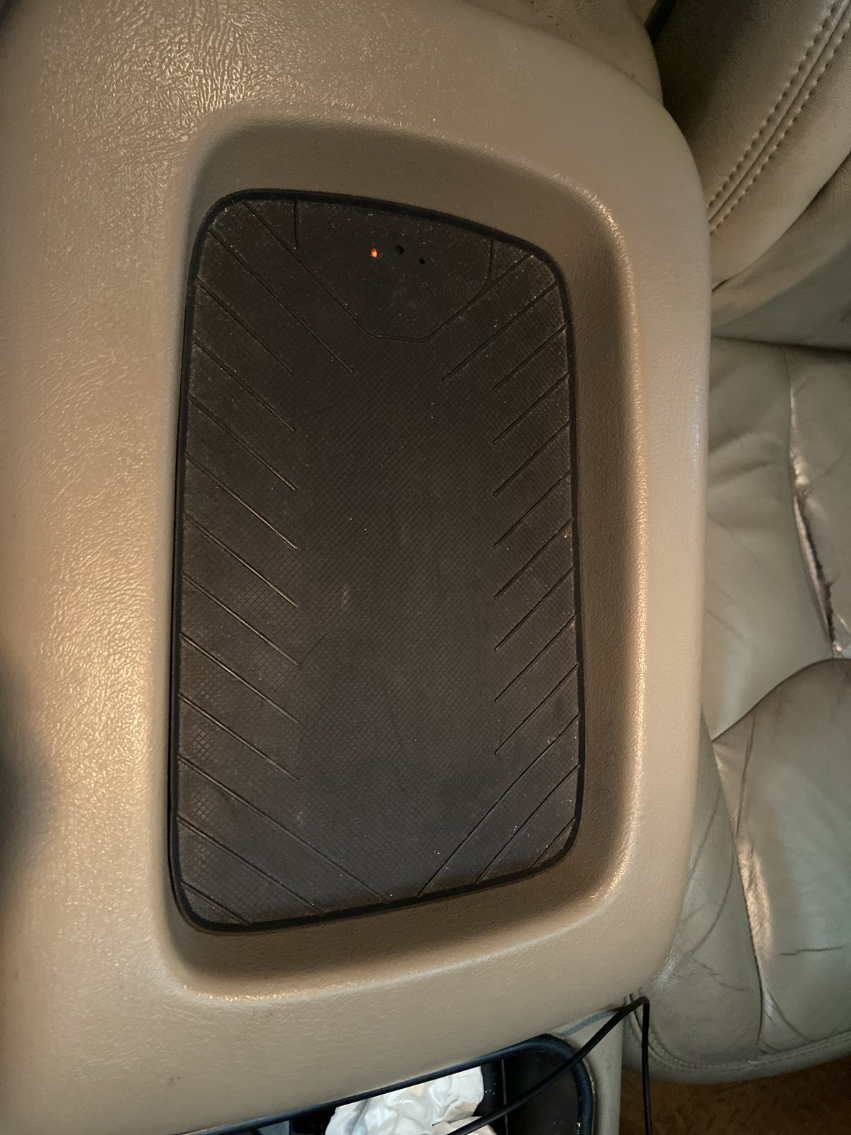

I did this about a year ago. I have wired-only CarPlay, so it’s unfortunate I still have to plug in. But, it’s very useful for my daughters cell while we’re driving and I’m plugged in, or for using BT with mine. Also, your “mat” seems to be a nice upgrade, with the little phone ridge around the charging area. Mine doesn’t have that, and with my particular phone case, it’s definitely not very grippy.. nice upgrade.! (I know, it’s filthy, and I STILL need to do my leather seat..! I’ve been a bit busy.. :fuckyea:View attachment 383291
I installed this last week..... Easy to install. Boost Auto has a great video.

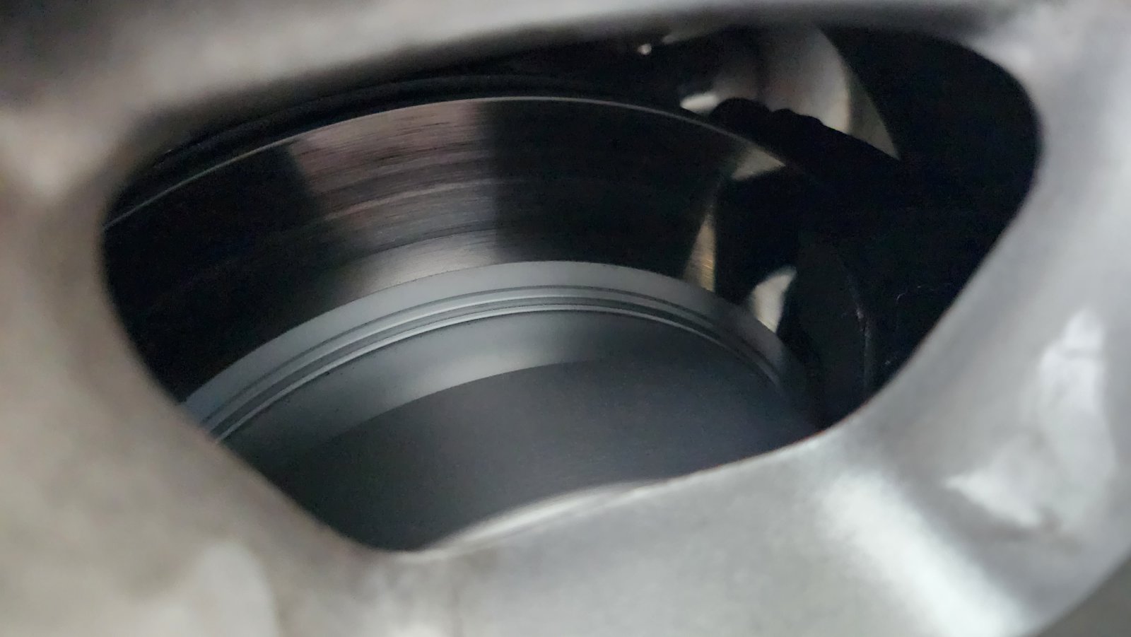

Passed MA RMV inspection today!
Good 'til October 2023
My trusted mechanic had a heck of a time with the parking brakes. With everything off and back on twice in adjustments, he determined there was something not right with the rotors. On old rotors, adjusted to brushing the inside of the hat to get the rotor on. But once the rotor was on there was too much clearance and not enough grip action. They were the cheap-o rotors I put on when my calipers seized. Maybe defective castings? Anyway... New rotors (premium coated this time) and he got them to finally hold decent.I have done a lot of DIY, but I am glad I let my guy deal with this one.

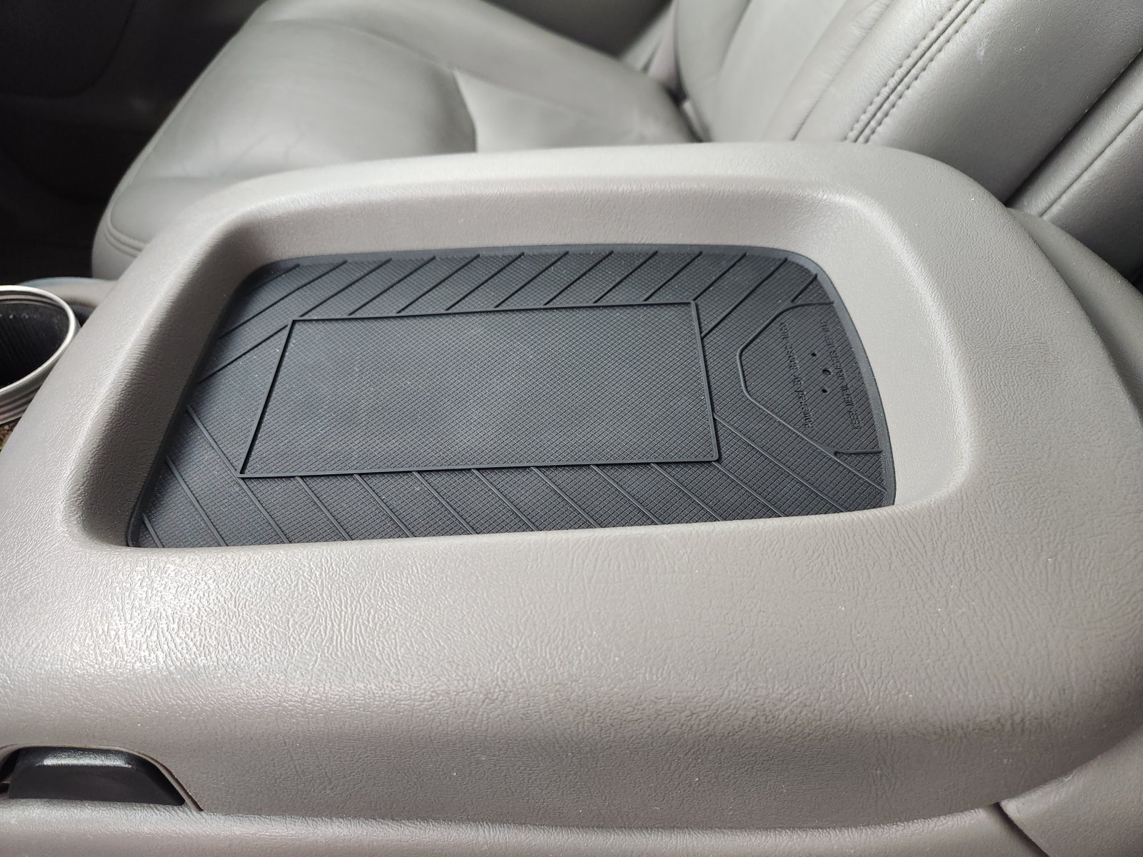

Installed my Boost Auto rapid charger yesterday. Easy install and works great! The Pelican phone case might have been interfering with the phone detecting the charging coils (or the charger detecting the phone). The phone kept charging, pausing, charging, pausing...
I took off the case and seemed to have no issue staying on charge until done. Charges very fast! As far as the phone moving around on the pad, it still stays on charge even if the phone slides up to the front edge of the tray.
I like the idea that I can put my phone on there and have it charge, even if the truck is off.
That would be handy for any time I need to rapid charge, but can't stay with it waiting for charge to finish. I can just drop it in the truck and come back a few minutes later.
