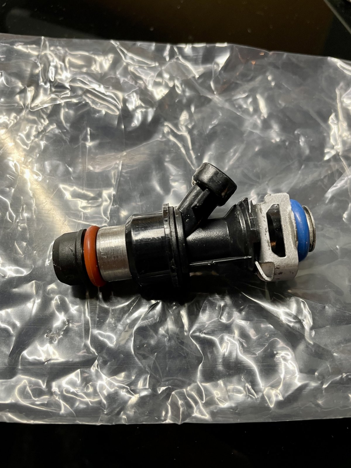

How many miles are on your suv? Why are you changing out the injectors out?
Hi, ciao:)
286000 km, gasoline and LPG routes, cylinder 4 misfire detected:(. First I ran compression test, luckily it was great:), so I decided to change spark plugs, wire, ignition coils and fuel injectors.These parts that i will change, except for the spark plugs, are the originals from 2001. (sorry for my english:))

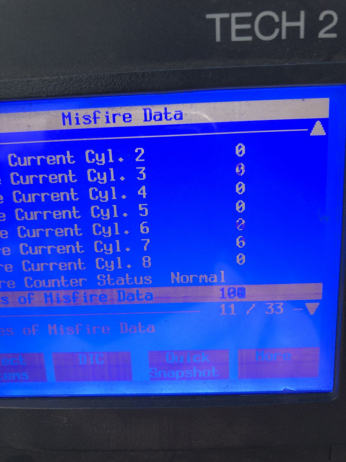

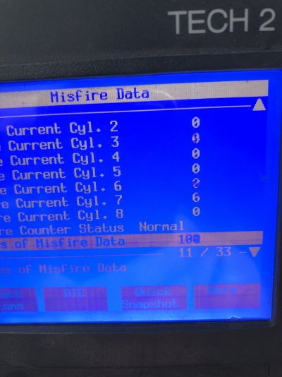

52,949

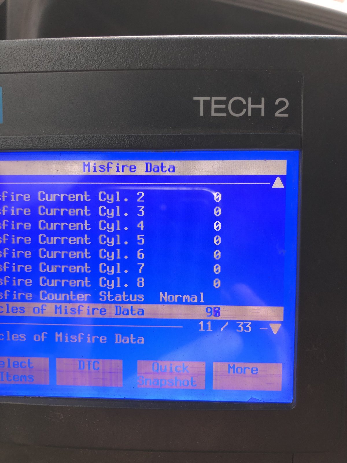

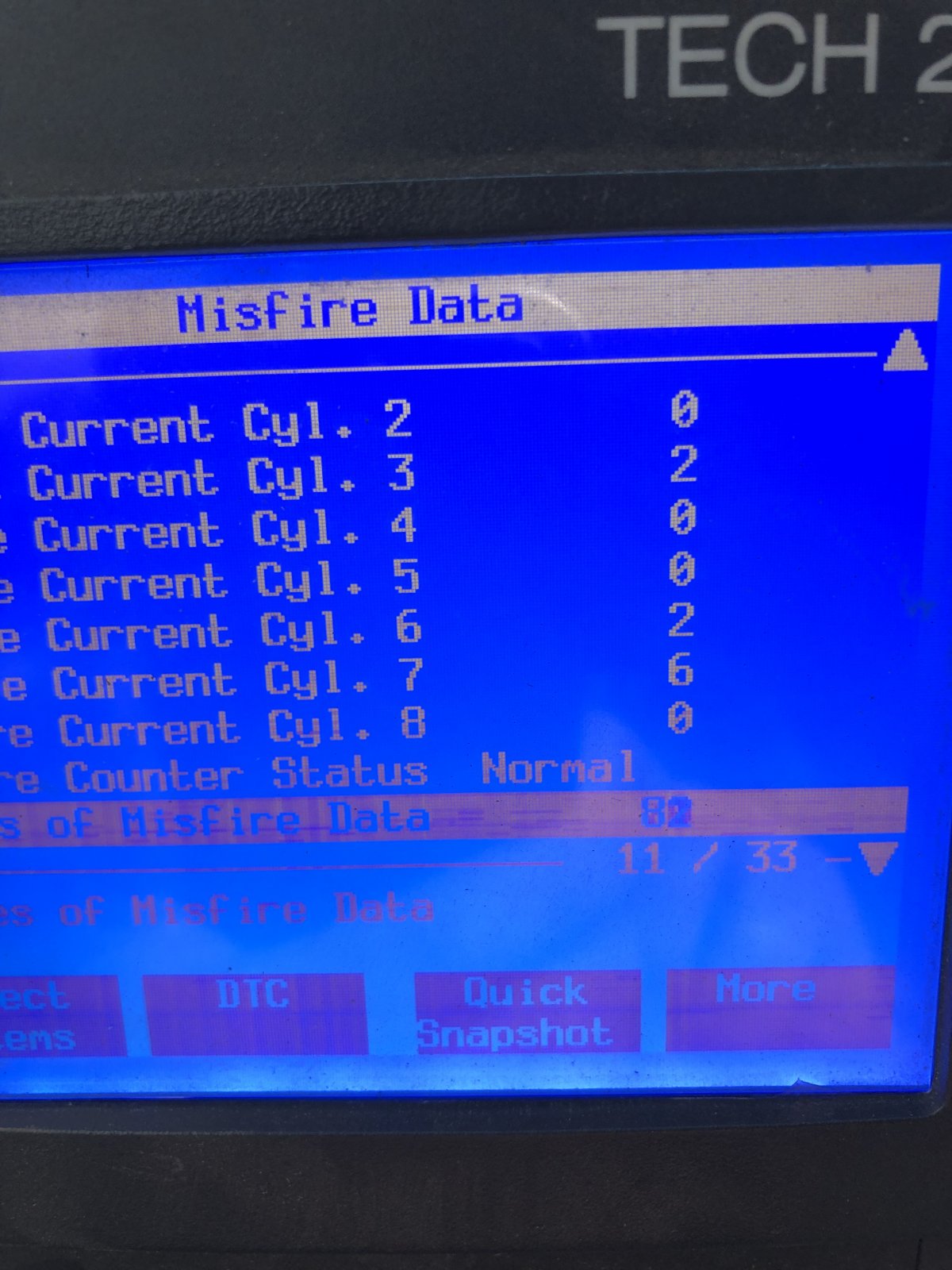

I finally got around to doing the crank position sensor relearn today. I wasn’t sure if I had ever done it after replacing the cam, at least with this ECM. The first 2 pics are misfires before and the last 2 are after. Im not sure if it’s because I get more misfires as time progresses after starting it up or if it’s because it’s more accurate after the relearn but I do see more misfires after. I tried to get as close to 100 cycles of data each time.

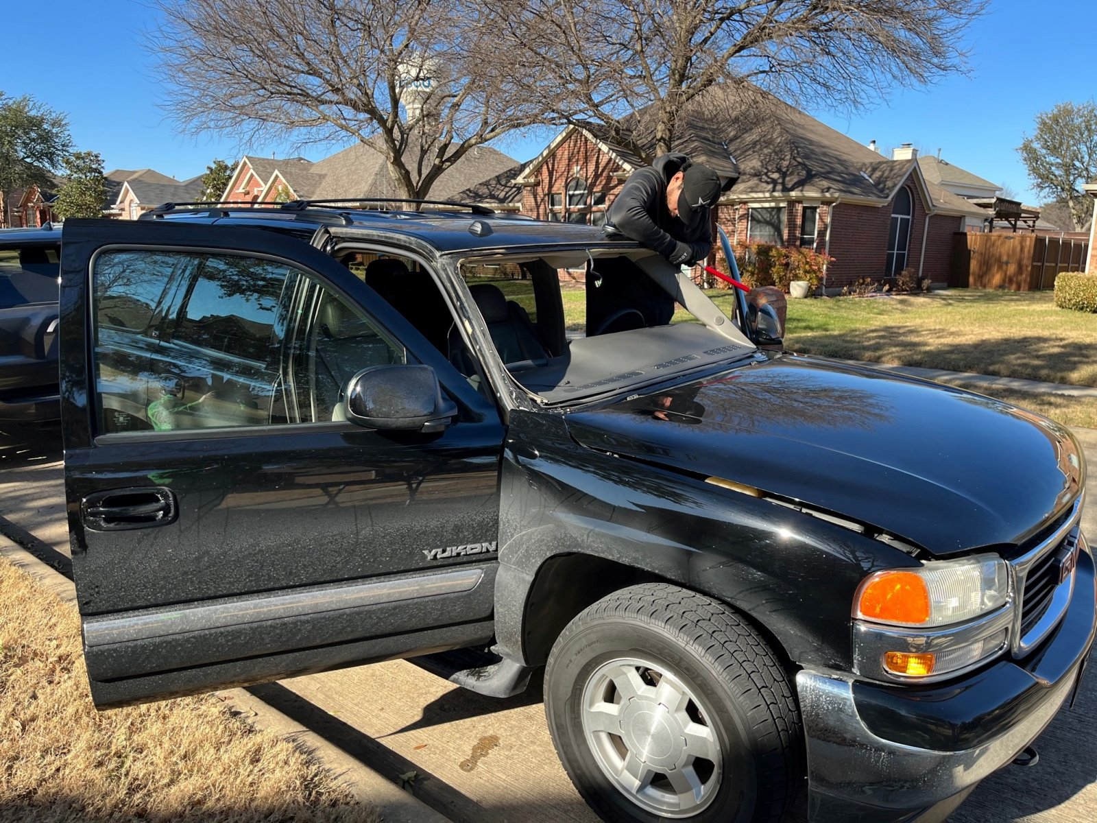

Finally bit the bullet and replaced my 16 year old original windshield today. I've been working on and off with the owner of the glass company for almost 2 months trying to decide what brand of glass would make my obsessive compulsive personality happy for the next 5-10 years... We settled on Vitro brand glass.
Apologies for how dirty she is, but it's just warm enough for the first time today for me to be ready to hand wash the truck after the snow/ice storm we had last week.

Not yet (and hopefully no problems will come up at all) but if anything comes up or comes to mind, I'll be sure to post up here. It was a bit unnerving seeing them use a sawzall with a scraper attachment to remove the glue/sealant when removing the old windshield, but I haven't noticed any scrapes or scratches on the inside or outside of the truck.
They did have to remove the windshield wipers and cowl around them, so if you were a super particular fella, you might want to remove those before they arrive so it's one less thing they can potentially mess up/break.

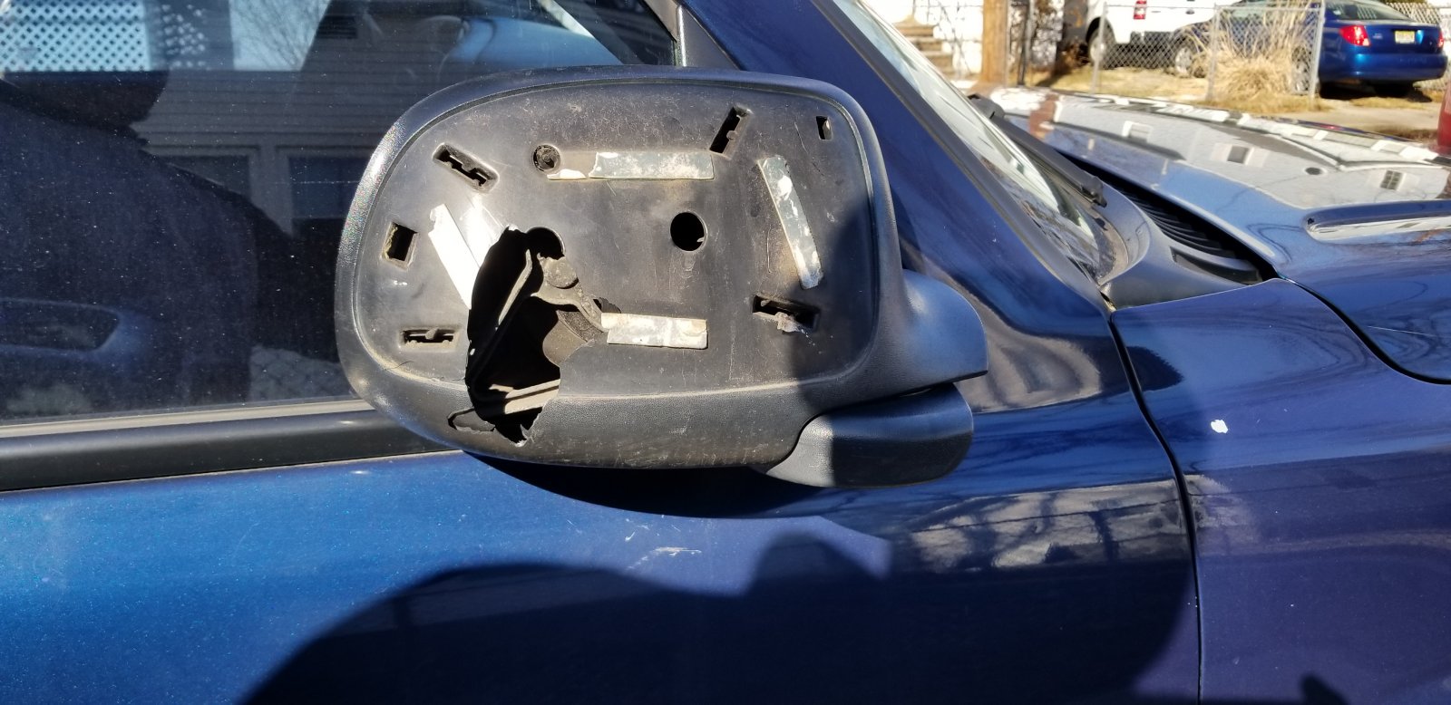

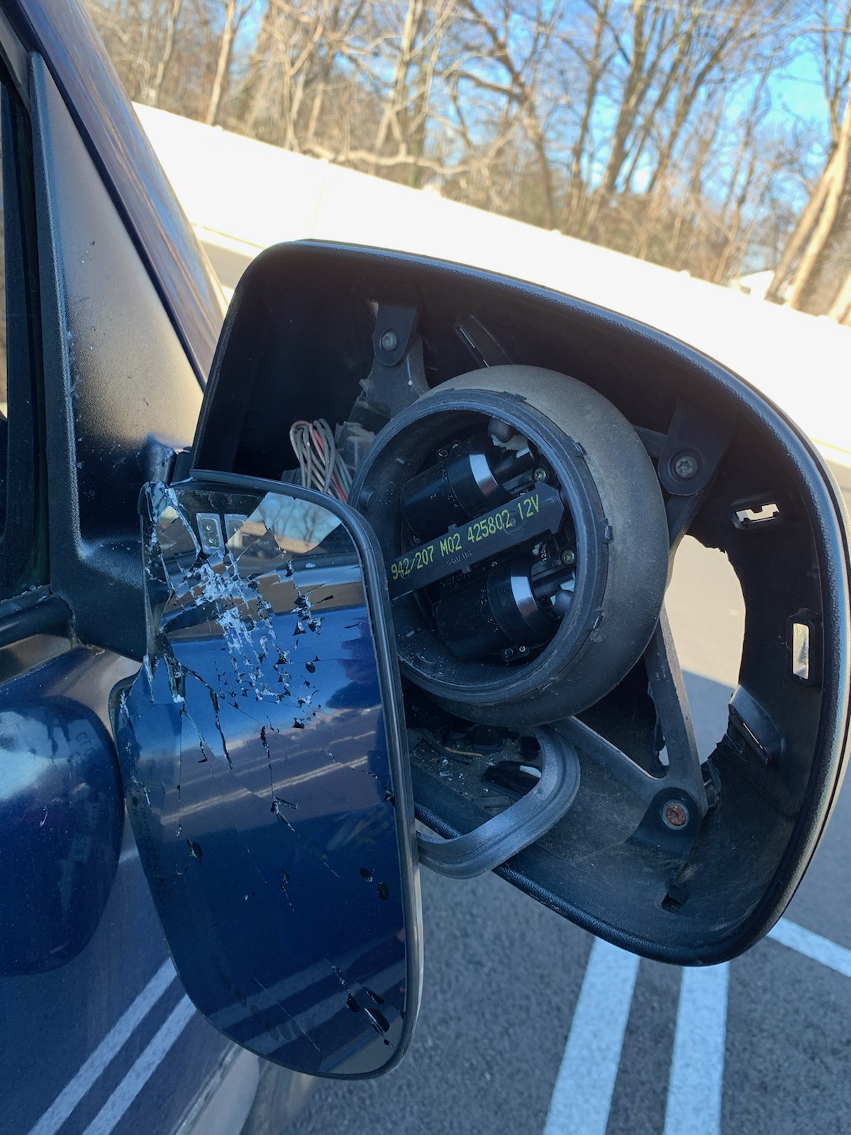

Gf went out to do some food shopping today, and the truck just stalled in the road. Started it and got the "Reduced Engine Power". So she plugs in the scanner trying to reset it and some MUTHERPHUKER in a dodge pickup can't wait and tries squeezing by. Smashes the powerfold mirror and takes off. Of course she's all nervous, so she doesn't take a pic of the truck or looks at the license plate. I tell ya, that a$$wipe is soooooo lucky I wasn't in the truck when it happened!!
Even smashed the housing. Funny thing, it still folds, and the mirror still works with the switch.
