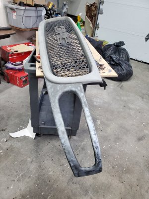

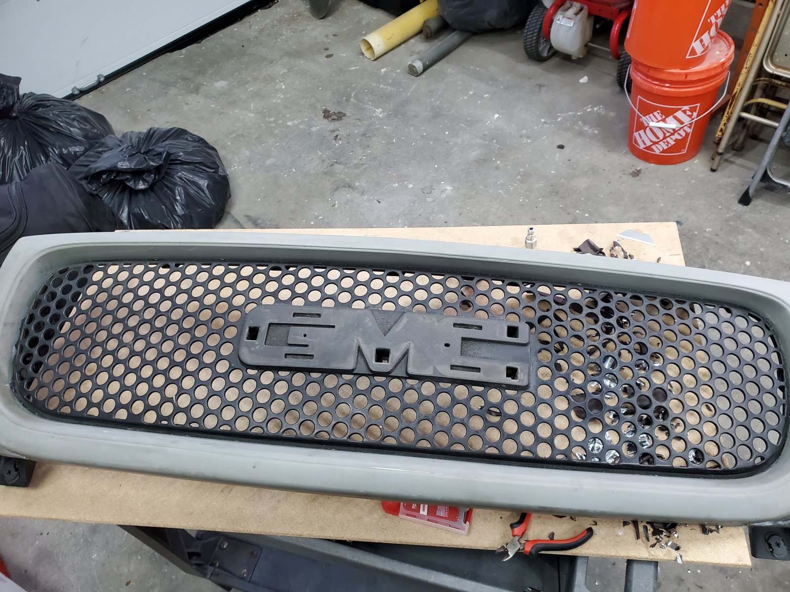

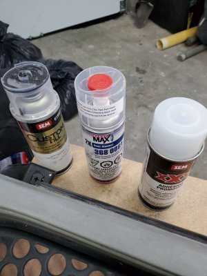

Finished stripping the chrome off the grill.... this sucked!
But im ready to start the prep for painting!
As for the center portion I'm going to re plasti-dip it. It has way too much detail to try to peel the plasti-dip off and strip the chrome. Plus the matte finish of the plasti dip will go well with the gkoss black of the grill.
20210517_191643.jpg 20210517_191651.jpg 20210517_191703.jpg 20210517_191723.jpg

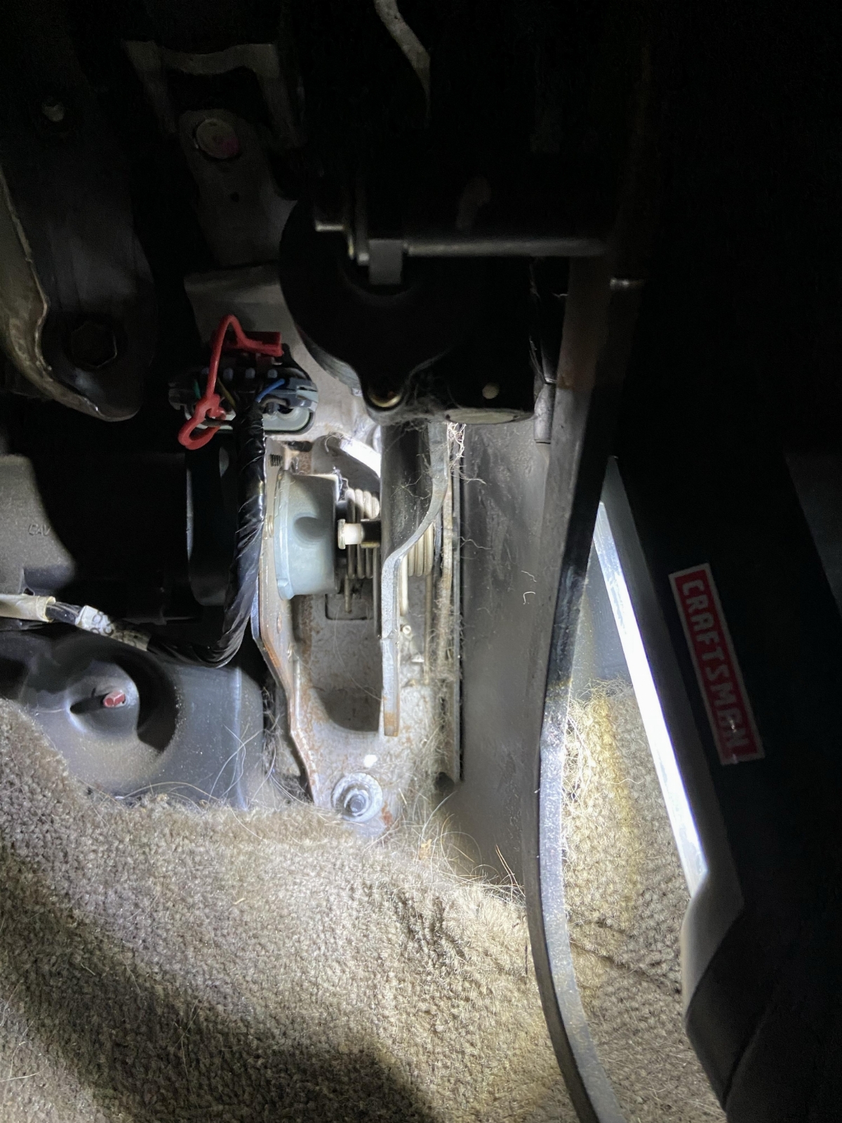

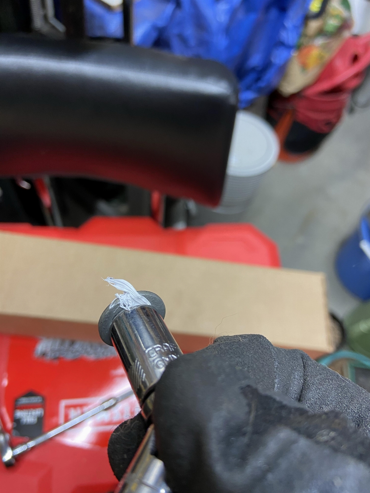

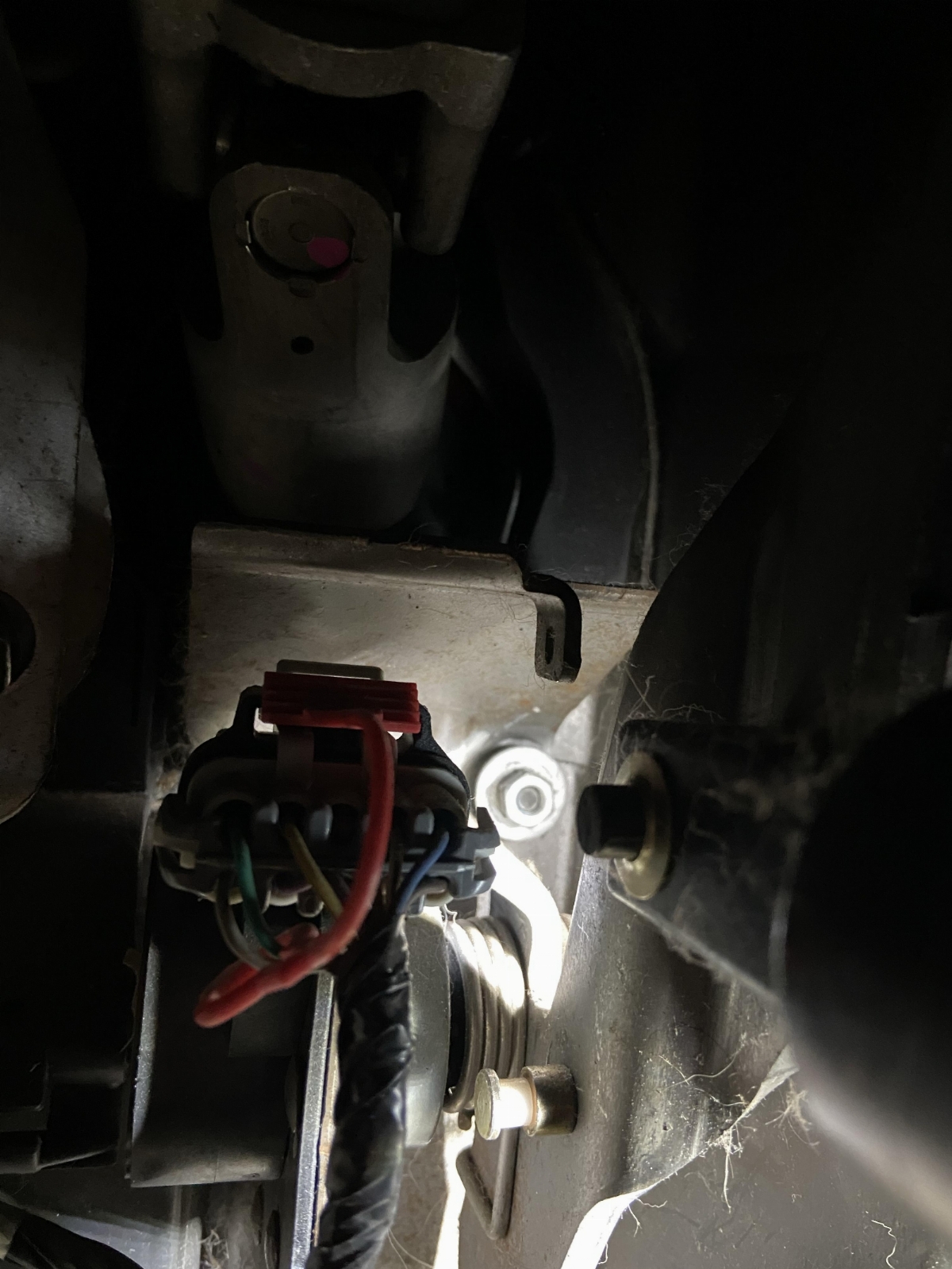

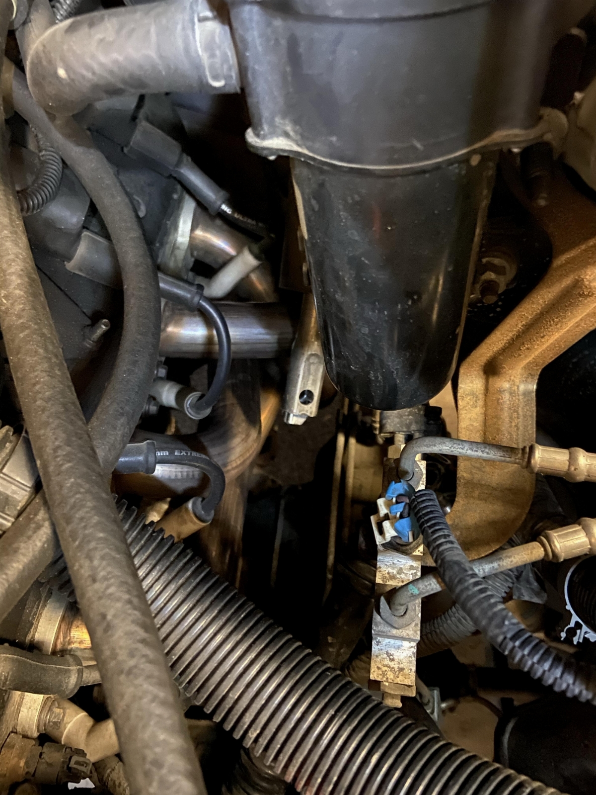

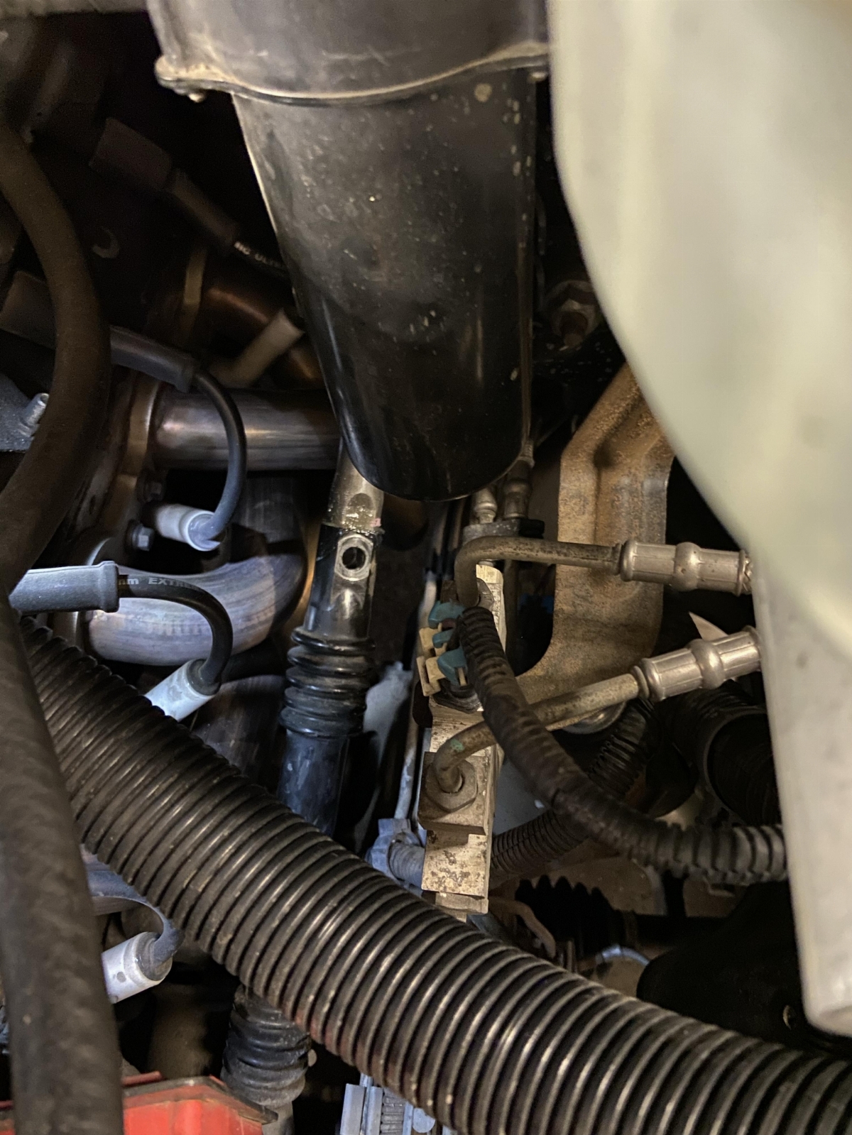

Replaced my intermediate steering shaft. Super easy job, except for the one nut. GM is good at that shit.. this should address my clunking noise going over bumps, and dips, etc.. clunking steering noises in general. Gotta make dinner, so test drive will have to wait. The alignment of the steering wheel looks good.. hopefully.. I held it in place with the seatbelt.
This mf’er.....

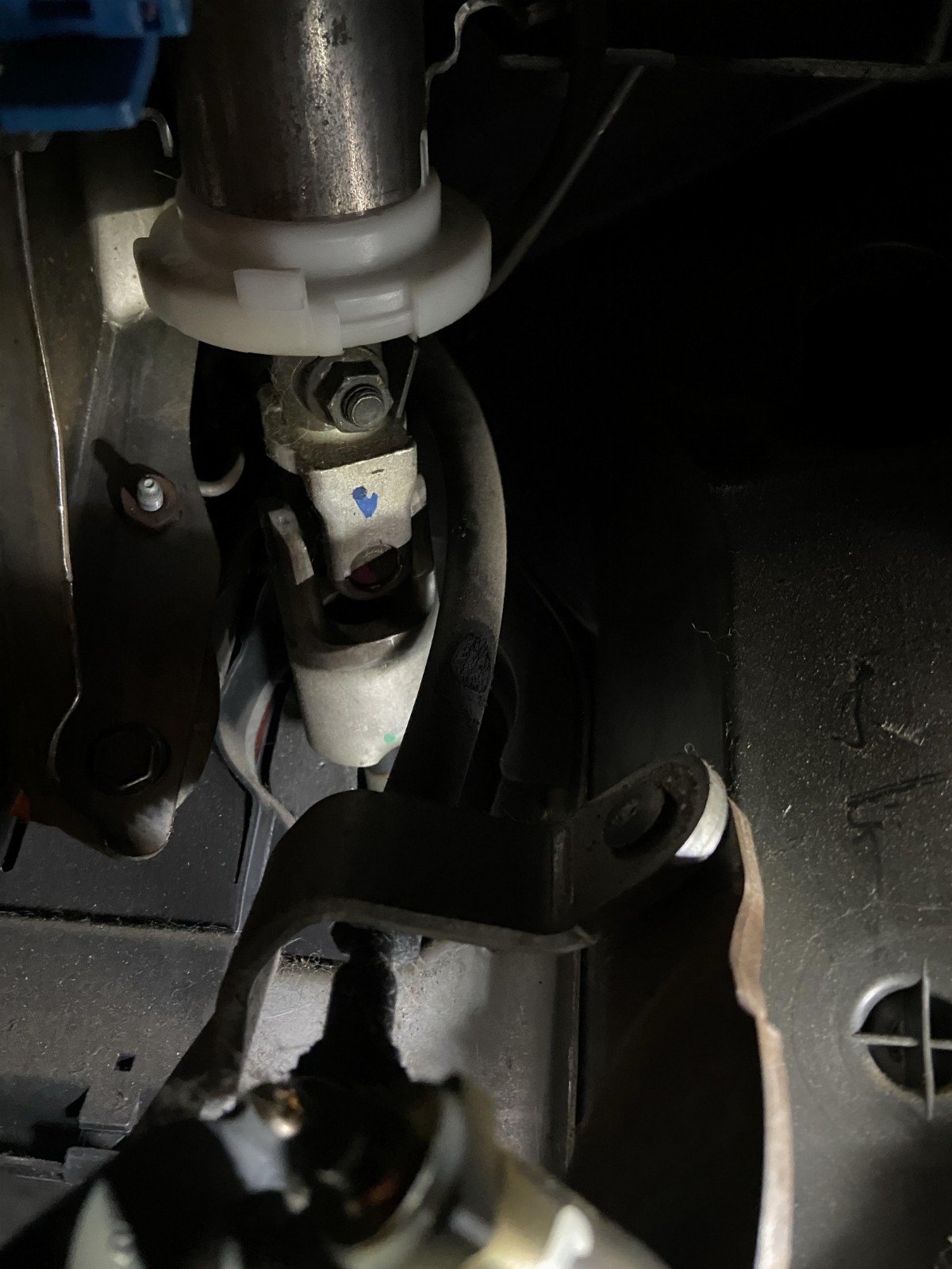

Old (left) vs new:
And had to use a trick to keep the nut on the socket. This thing was a ***** to get to:
All back together:
And the steering looks pretty dead on. Fingers crossed.. don’t want to go get an alignment..
ETA: happy to report my steering clunk is gone! And so far, steering wheel seems perfectly straight and aligned. Success! [emoji106]
