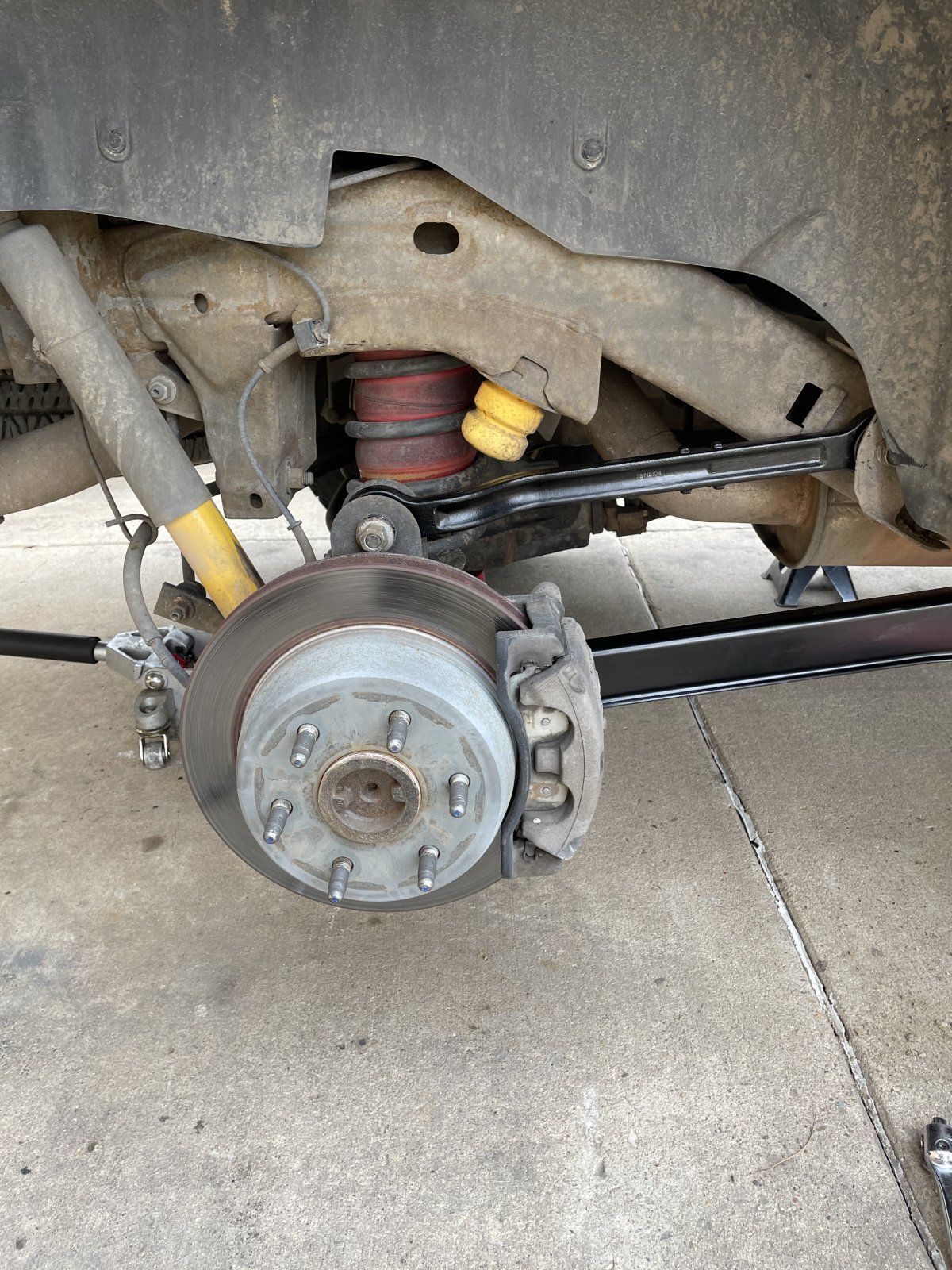

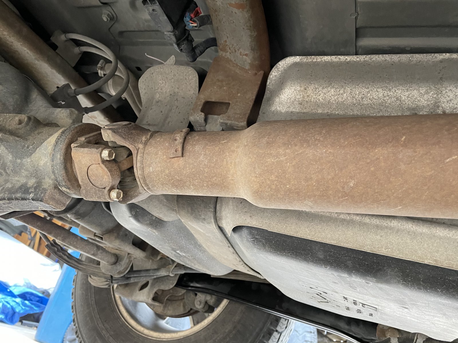

Replaced all 4 rear control arms and a quick brake bleed. also replaced the rear driveshaft U joints, ran out of time for the fronts. Can’t believe they’re original, they weren’t seized but for sure weren’t very smooth.
What made you replace the control arms? Was there play in the bushings? Have you felt a difference in how it rides or handles?
Isn’t it fun melting those u-joints out?
Edit: if they’re original, that means you had to torch them and watch the plastic that holds them in come melting out. If they had clips they weren’t original.
It has 230k miles on it and I got all 4 for under $100. I’ve been chasing an issue of it moving side to side over large bumps on the highway. Most bushings looked good but the upper control arm bushings had some cracks in them.
