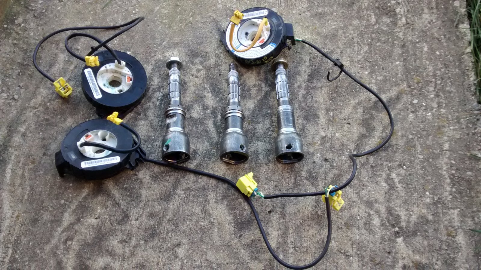

Was a nice day (< 40 F ), so I went to the junkyard. Thought I'd see just how difficult it is to remove the upper section of the steering column. That Youtube video I posted earlier made it look like a pita. Actually doing it wasn't so bad. The hardest part was removing those damned snaprings. I pulled 3, and 3 clocksprings, for practice.
View attachment 260138View attachment 260137
To hell with trying to fit that larger insert into the new steering wheel. Oh well, they can't all be good ideas.
So why exactly are you trying to fit the larger insert into a newer steering wheel? I did see the YouTube vid. Asking because I’m curious and wondering what you’re actually trying to accomplish

Clock springs can’t be spun or they’re toast. Should tape them up when removed.....new they come with an orange lock tab.
I know, useless info from me....
I didn't hear or notice that the clock spring "unwound". The wiring tab stayed where it belonged, and I lifted it straight off. I guess I'll find out if they're toast if/when I ever get around to swapping the wheel.
Was trying to find a way to put a 2003+ wheel on my 2001 - without swapping the upper steering shaft.

Every new clockspring I've seen is shipped with a locking tab at the center point, assuming they will be installed with the steering wheel and tires centered. They don't "unwind" by themselves, at least not much. You can take a used one and find the center by *gently* turning it from end to end, being careful to not put much pressure when you get to either end. Count the turns from end to end, divide by 2, and from one end move it back that many turns. That's the center.
Some of them are marked with the full turn count. The one in the graphic has 5 turns from end to end, centered would be 2.5 turns from either end.

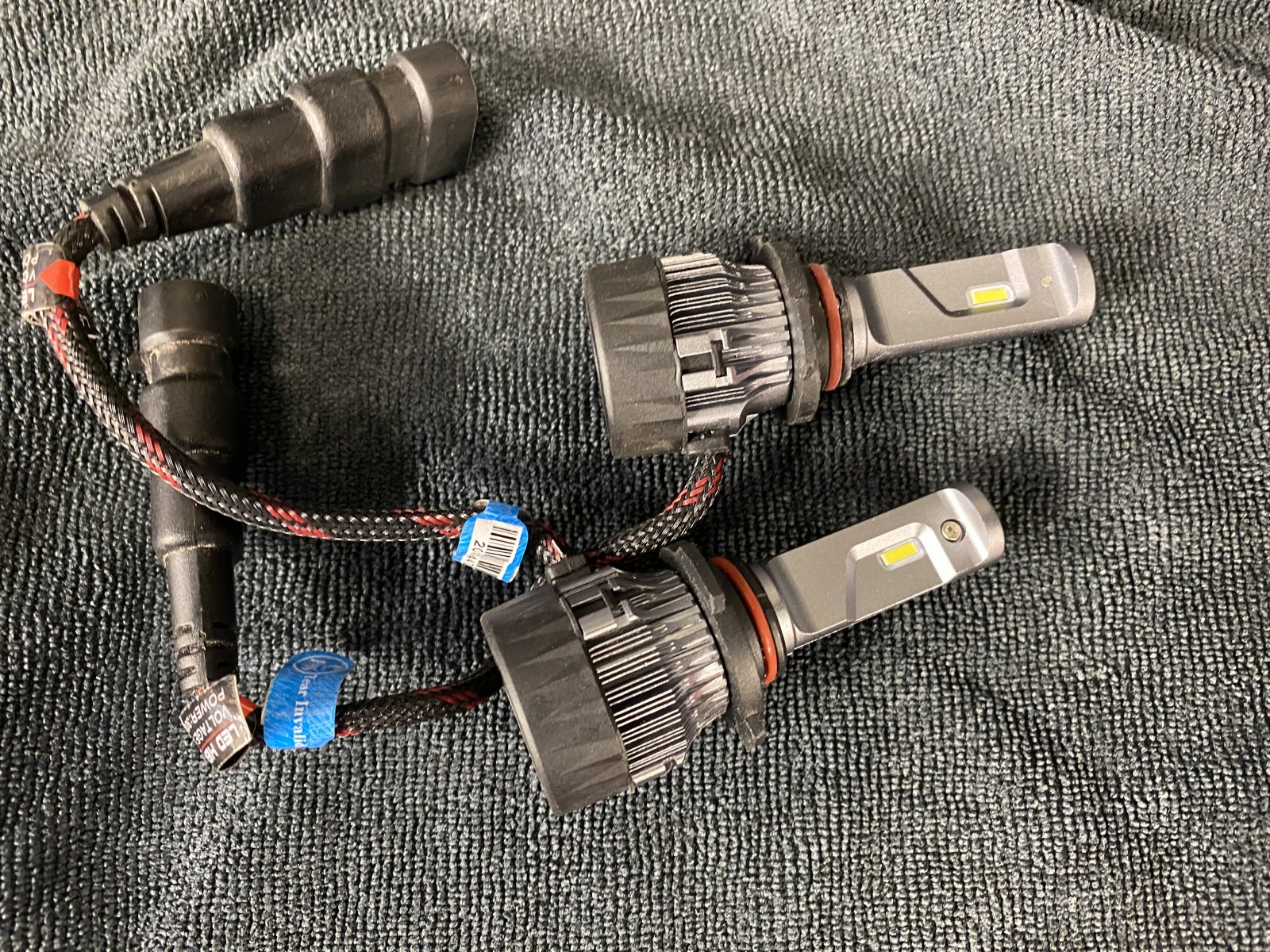

Speaking of leds, I finally got a set of highs to finish off the complete front led conversion haha.

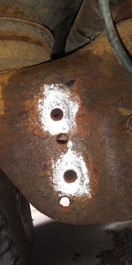

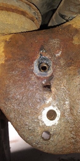

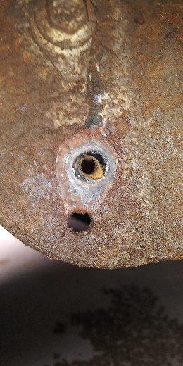

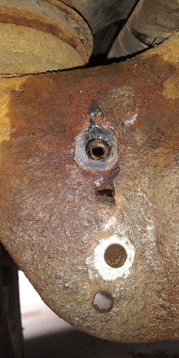

New lease on life 2006 gmc yukon xl .. lights are brighter radio sounds better and everything 12v just works better after cleaning grounds . Yes there was still paint between grounds .. you can see it on top one it fixed alot of mystery electric issues .
