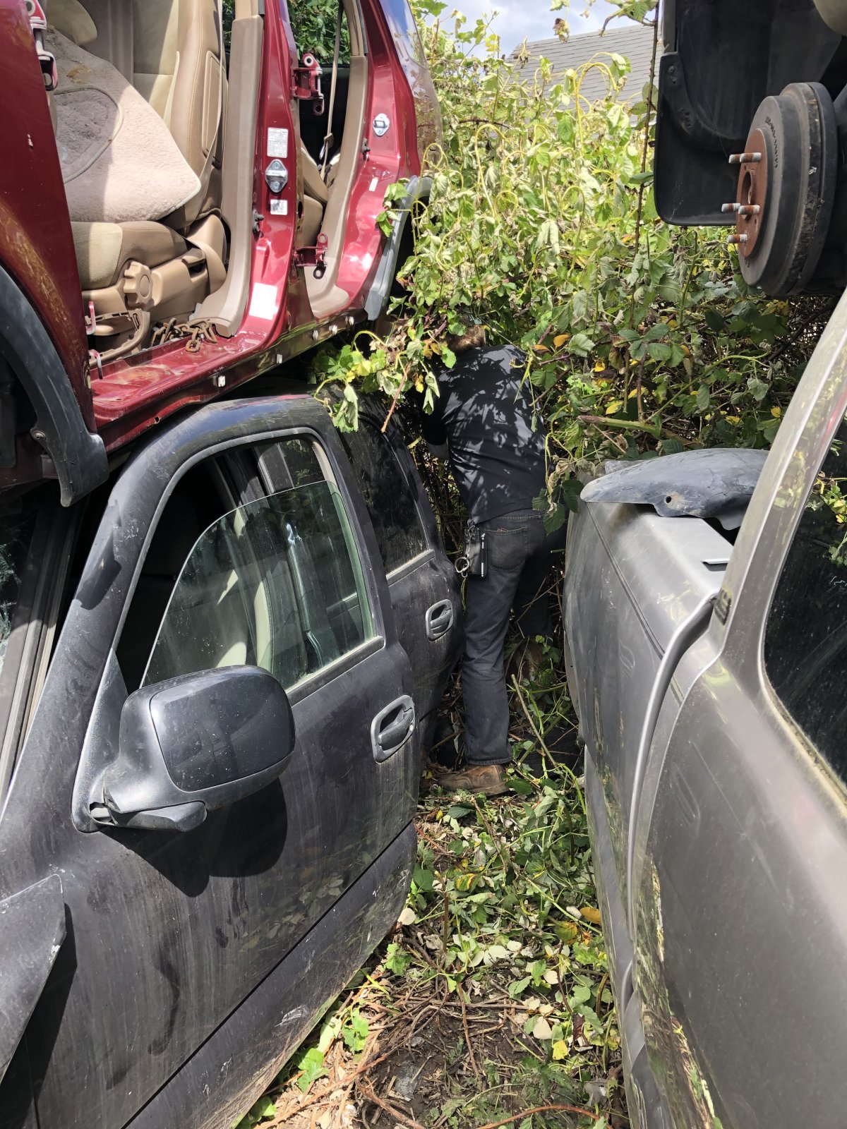

I had a good time at the wrecking yard looking for a unicorn, I just didn’t realize it WAS a unicorn- the hatch glass from an 05-06 that’s the new design. Now I see what you meant @Tonyrodz about not being able to search for it. The guys there were sure they had one, it showed on their computer that it was with no surround. An 06 Yukon. And they had an 05 Tahoe they said had one. I looked at the 05 and about 8-10 others (not sure what years they were) but they were all the old style. The 06 was buried in blackberries but dude said no problem. He cut a path around the back of the truck, took a look and said “it’s the right one I think”....I looked and it wasn’t. The office guy said here’s the RPO code for that glass, then said never mind there isn’t a different one for that style. Sucks.
Damn i miss walking around junkyards...

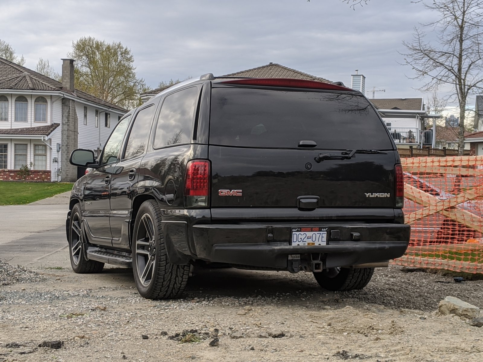

Ok, I checked car-part.com and can’t find one of those hatch glass but I noticed LKQ isn’t well represented there. I have tried searching lkqonline.com but you can’t search for glass there, or so I thought. I found some under “interior” but still no back glass, just door glass or quarter glass. But they do have pictures of the donor vehicles so I looked at door glass at their Portland yard, and there in the picture of the donor vehicle is the glass I want. I’m gonna call tomorrow. It lists the stock number and VIN of the vehicle so I can provide that.
Damn man. Too bad.

I called LKQ and both the 05 Tahoe’s that are in Portland that had that glass are no longer available but they found one in Cali that they’re shuttling up here. It cost a small fortune ($180) but I’ll just sell mine to offset it.
