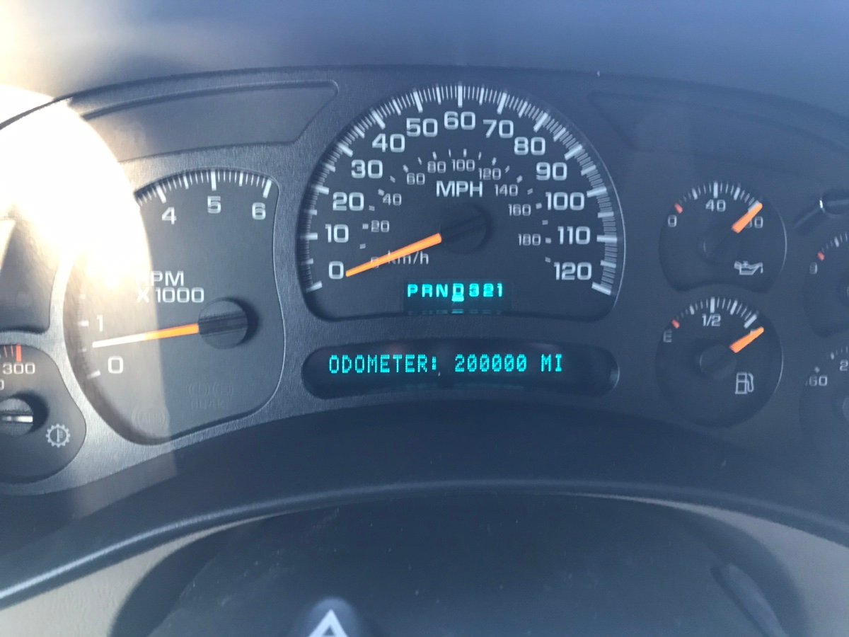

New cluster from Digital Dash Solutions. My damn oil pressure gauge is still pegged at 80. Guess I’ll have to warranty the AC Delco one just put in a couple months ago and replace it AGAIN. My fuel gauge is also reading higher. I was hoping it would be more accurate. And.. the hazard switch is reversed, so when engaged, the hazards are off. I’m considering returning this for a replacement.. not really pleased with the attention to detail.. Anyone else had less than stellar experience with them?

Yeah, first thing I noticed was the hazards, so I sent off an email. He replied, saying the hazards aren’t a cluster function, and mine must be “stuck”, to try cycling 20x.. weird, and that didn’t do anything (as expected), since they seem to have reversed polarity. Maybe I accidentally engaged them while plugging in the cluster. Not sure, but maybe that jacked up the BCM somehow. Anyway, I sent a second email, regarding the other issues. Awaiting a reply from that one. The thing that’s really not acceptable to me is the fuel gauge. It reads over full now, so I wonder how accurate that’s going to be.

Yeah, it wasn’t over -full before, so I expected it to be on the money. Also, it was already shy of full by around 40 miles, so seems to be off by a significant amount.
Here’s this morning before fill up, with approximately 40-45 miles on the tank:
And yes, the hazards work, they’re just reversed. Pushing in the hazard button turns them off now, rather than on. Maybe if it’s accidentally activated while installing, and plugging in the harness, it flips the polarity somehow.
