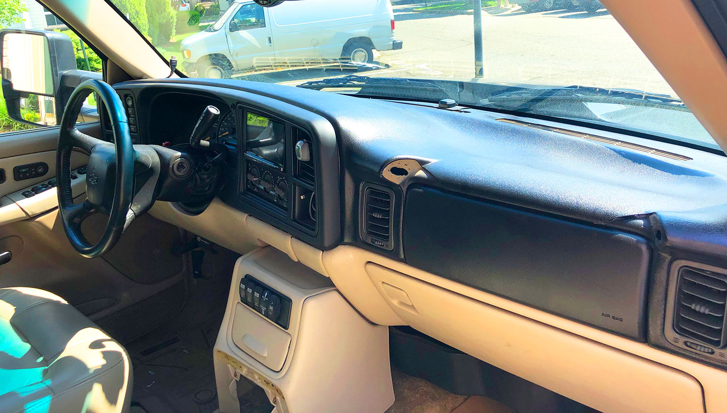

Upgraded (IMO) my dash to two-tone black and tan this weekend by installing a Coverlay dash cover. Also replaced the clips on my Metra double-din dash bezel from the ****** aftermarket ones it comes with to new OEM clips I ordered. It fits way better now–much more tight and sturdy. I walked through both upgrades in a video:

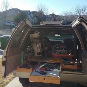

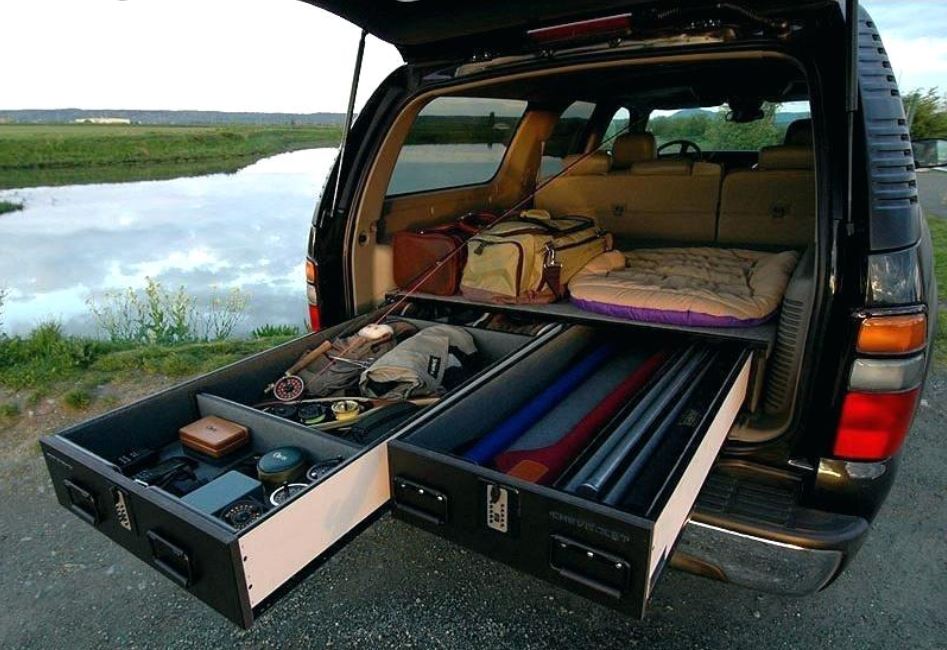

I've been looking at the cargo organizers and boy are they overpriced. So this week I bought two drawers from Uline to build a cargo organizer, I will post some pictures once I get the organizer started. I would like for my finish product to look something like the picture shown below.
https://www.uline.com/Product/Detai...le-Locking-Drawer-25-x-22-x-6?keywords=h-4833

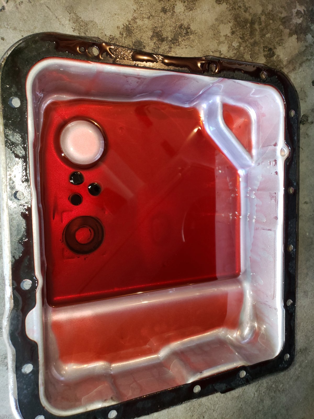

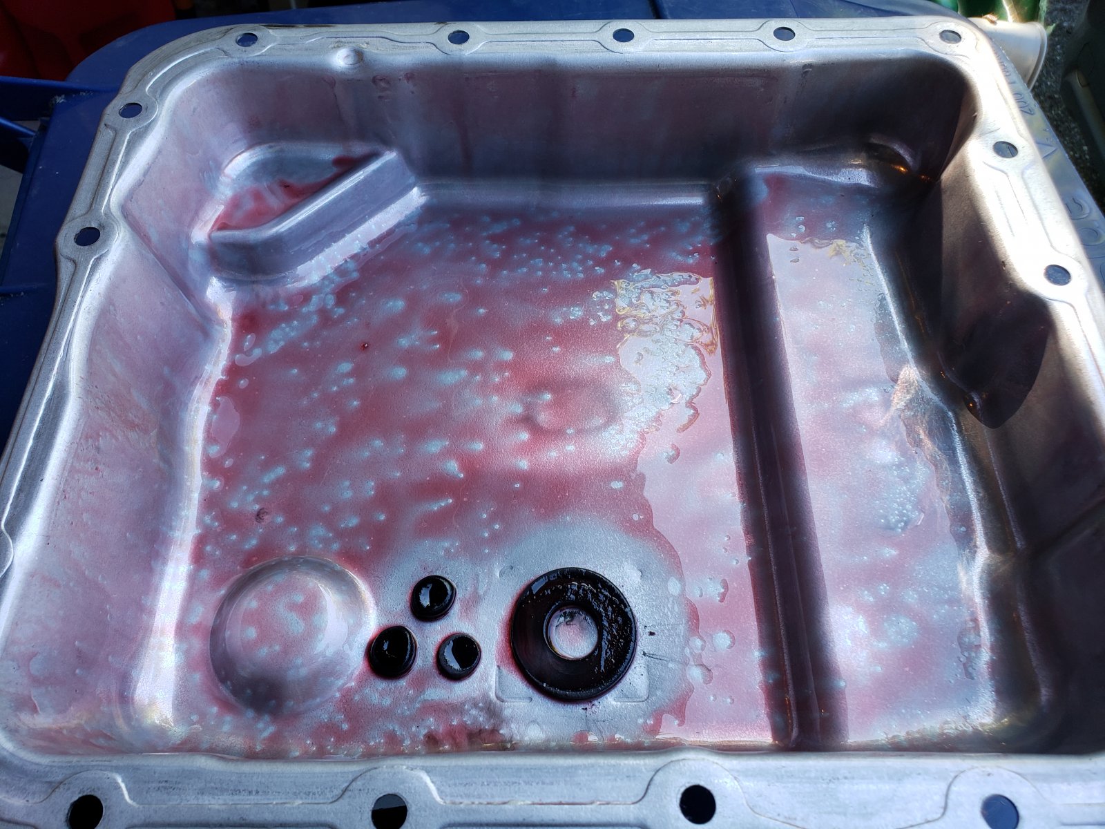

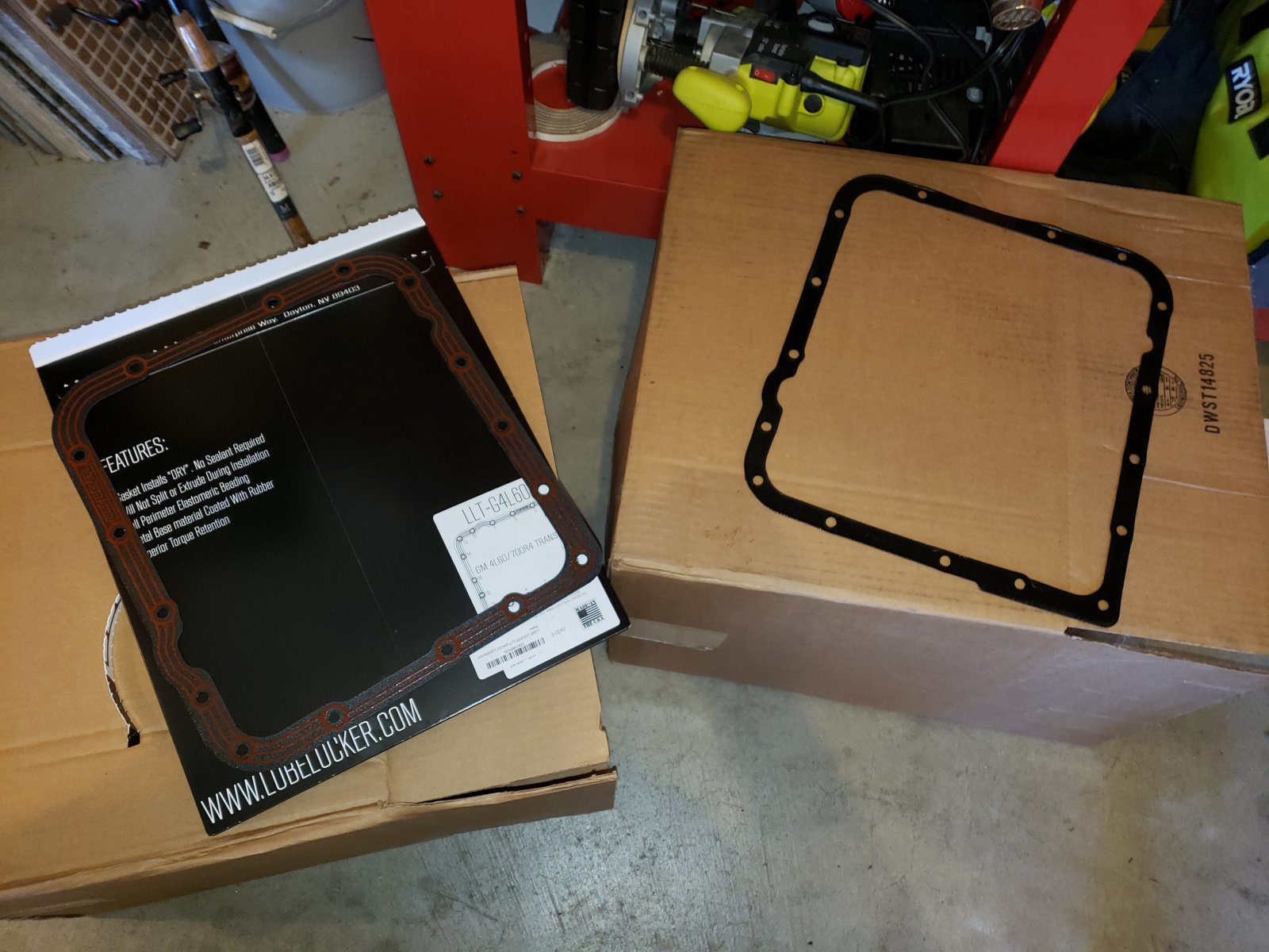

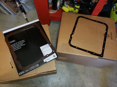

Got the pan off. Letting the thing drip dry right now so I'm not catching the shit in my mouth.
Fluid looks good, no concerning smells or discoloration. Minor sediment on the magnets. Have yet to inspect filter, that's draining out too. Can make a determination on my service interval then. Sitting at 40k right now if I remember right.
I will say the included gasket I used last time ******* sucked. And that was an ac Delco kit. Came out of the box like a limp dick and came off hard and stiff. Minor weep at front of the pan, verified Bolts still held torque. Picked up a lube locker unit to replace

I've got a lube locker waiting for my eventual pan drop. I was gonna suggest that to you when I read the first part of this post. Seems like a great gasket.
Fluid looks great

I’m going to use the same kit I used last time-ACDelco Professional. I need to do mine, it was supposed to be done 2000 miles after I installed the new trans and I just realized Im past that.

How many miles total on that tranny ? Fluid looks great .. mines do for a change soon also but it's nice color yet .. infact cleanest fluid I ever seen on a 177,000 mile rig . Previous owner must have changed it quite often. I pulled tranny dipstickes on rigs when I was shopping I looked at some were color of used motor oil it was all pretty horrifying .

144 and some change, original trans
