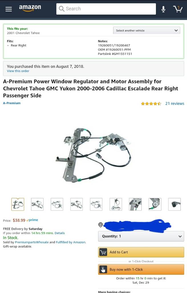

I don't know about a $30 regulator though... I originally thought it was just the motor, so I ordered a replacement but discovered the cable inside the regulator had committed suicide. So a new regulator is on its way.... and even from Rock Auto it cost more than 30. I don't like to get the cheapest part I can find. And I wouldn't say they're ez... I've certainly worked on worse, but I've definitely worked on easier than these damn tahoe windows.

Here is a regulator I just bought for my truck off Amazon. $38..so a little more than 30. The cable usually gets eaten and goes off track. Not worth the time to rebuild and I just replace the whole thing. I'm familiar with my truck so I can get in and out pretty quick,

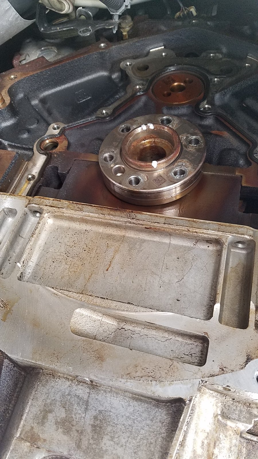

While I am replacing the transmission I am going to replace the rear main seal and oil pan gasket. I also purchased the billet seal install kit and one of these billet barbells from https://www.saccitycorvette.com/
I also got the modified oil pickup tube bolt but haven't installed it yet, I'm still working on getting the oil pan off.

I really need to replace my rear main seal. Not looking forward to that.

It actually wasn't that bad, air tools, HF trans jack, long extensions and taking your time are key ingredients. Also soak the exhaust nuts in PB blaster for a couple days.
