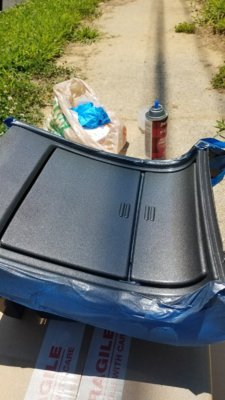

Sorry my phone started tripping out as I was trying to write that post but what I meant to say is that there is no way you can spray paint the door panels and kick panels and it will last. I'd be afraid to do an area that large and have it start flaking off or chipping away

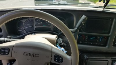

Ac is all back together there were no good pics to take. However I did start painting the dash. I picked a flat metallic iron color looks good so far.
