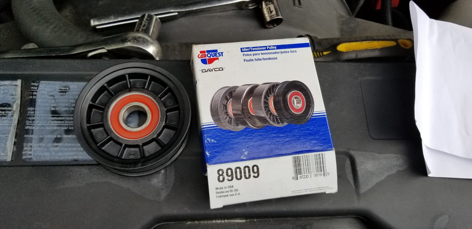

Did my idler pulley, again. It started chirping a month later.
33,201
51,447

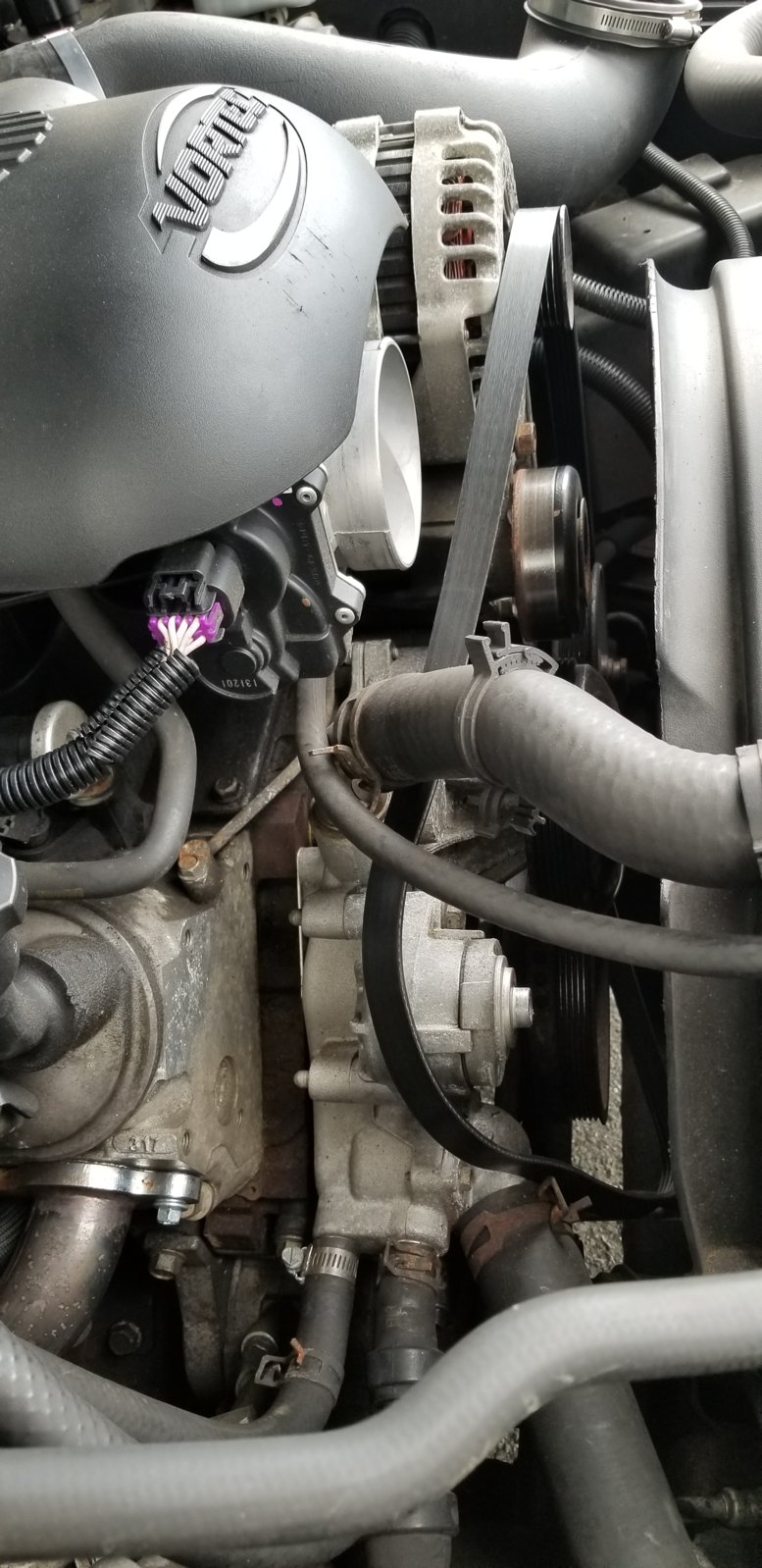

I like how when you installed a new hose clamp you just slid the factory clamp back lol. Easy way to kill a leak without breaking the system open.
I don't think I did that. I actually noticed that today. I just left that damn thing there.

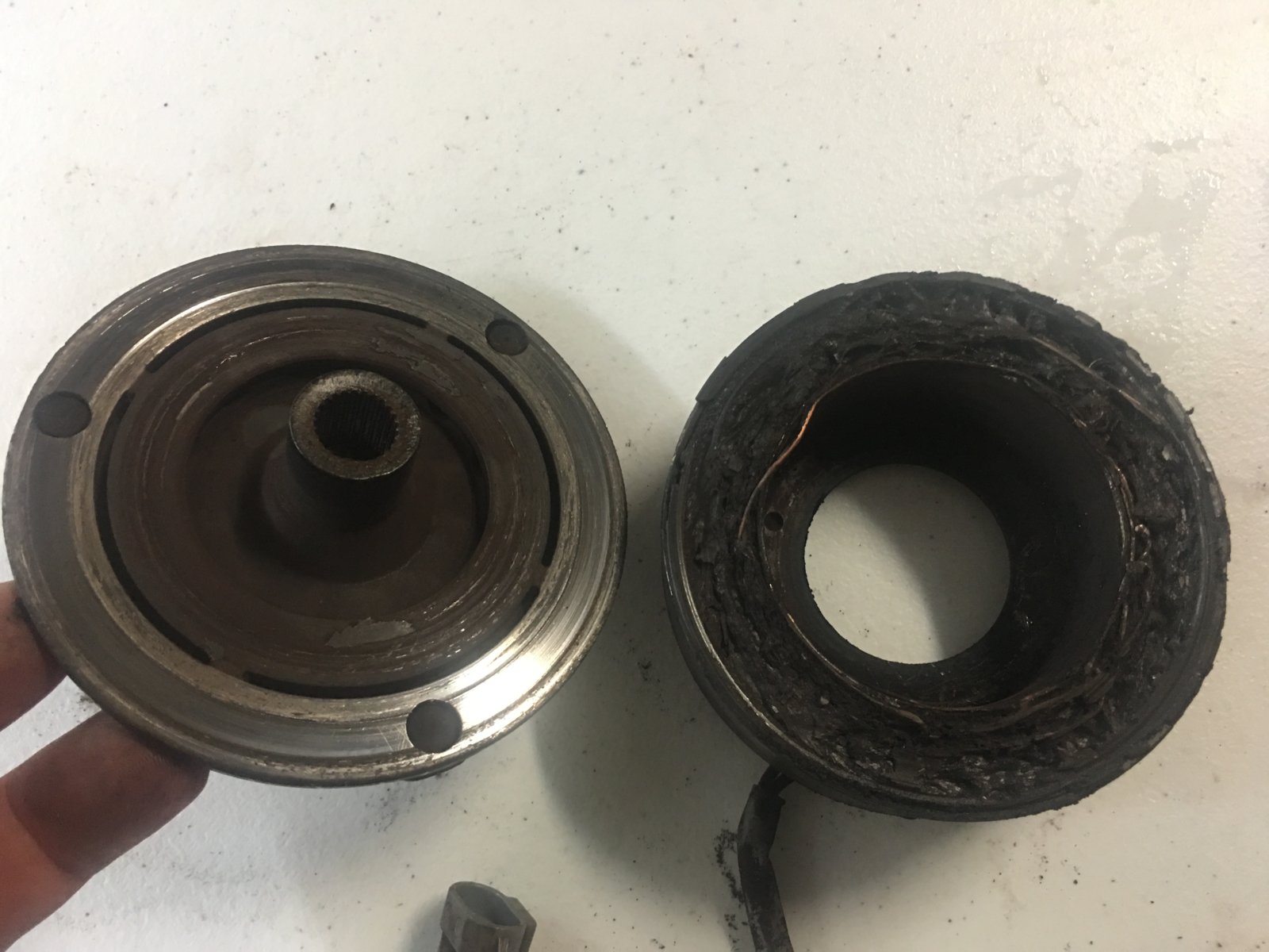

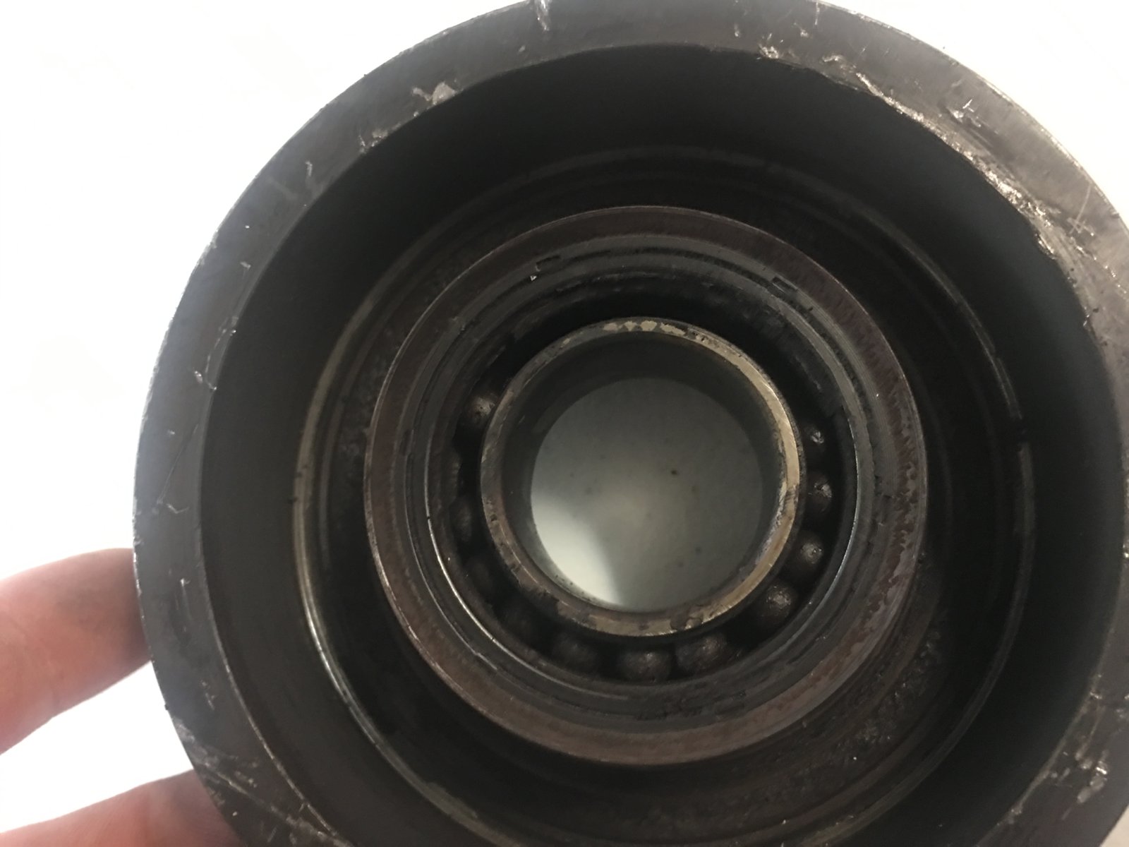

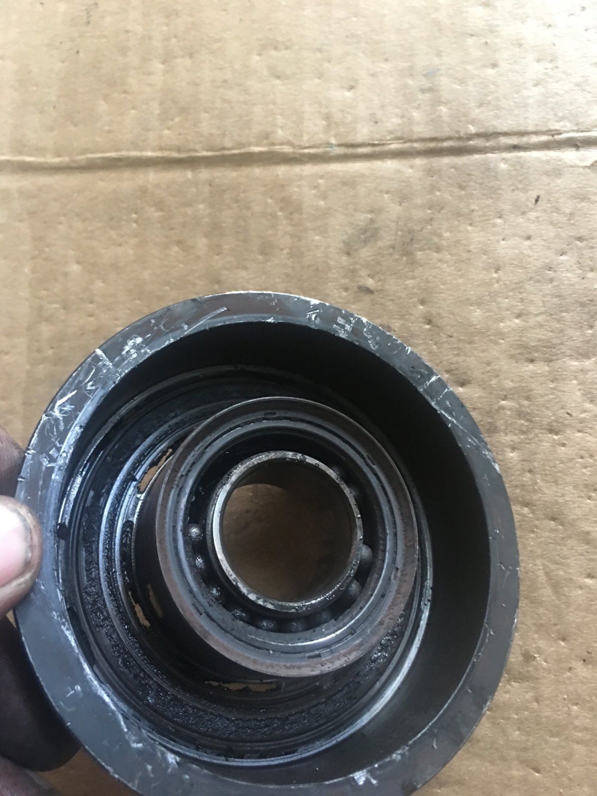

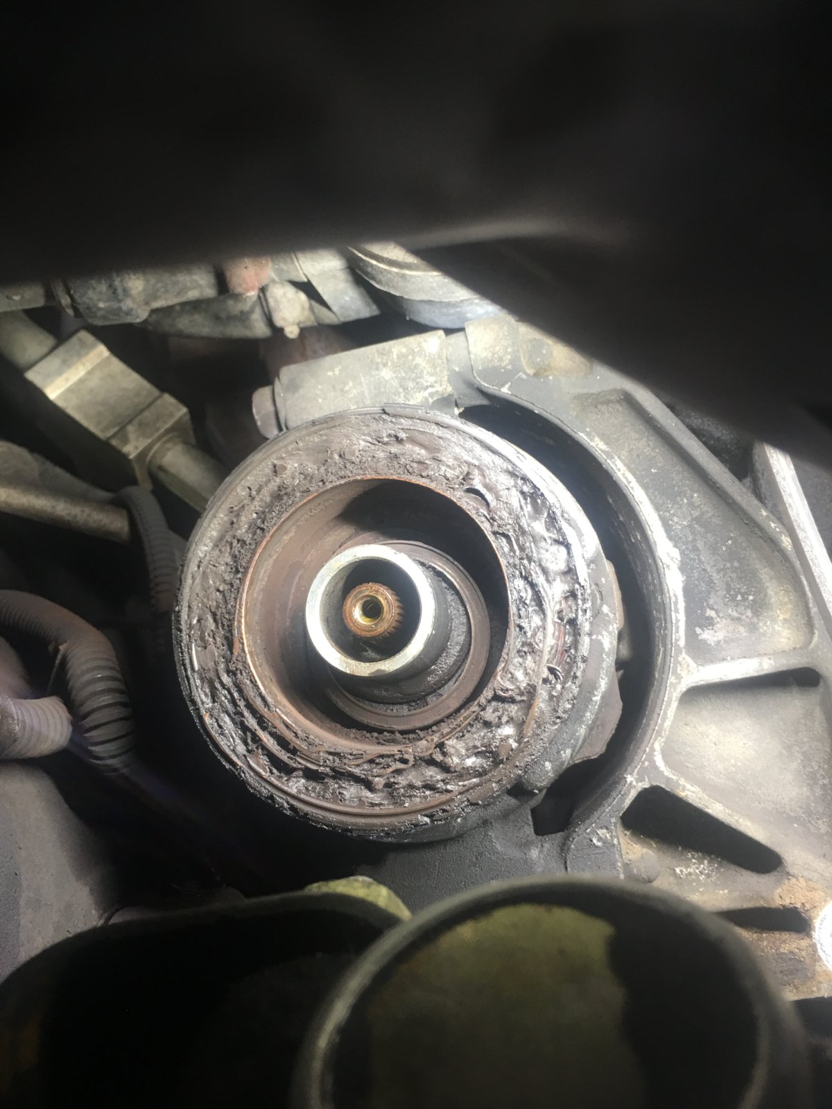

The ac belt tensioner? Mine actually seized once.
The pulley bearing bit the dust which burn up my clutch and coil. Not even a squeal/squeak/grind... pulled everything from the compressor and here ya have it.
1DC4FABF-EA61-4B3F-BD24-06C36865EAC5.jpeg 95F97BA0-4C39-40D9-B031-62A66A93B1E2.jpeg 0F4E5EB3-3905-4251-BBB6-A17363120E34.jpeg 74E83DC4-6E55-4AF0-A423-3907E67C5A23.jpeg
The coil still energized and engages the clutch but due to the extent of the damage just gonna replace it all. Parts will be here tomorrow. Rebuild kit -100 bucks.
View attachment 201185 View attachment 201186 View attachment 201187 View attachment 201188
