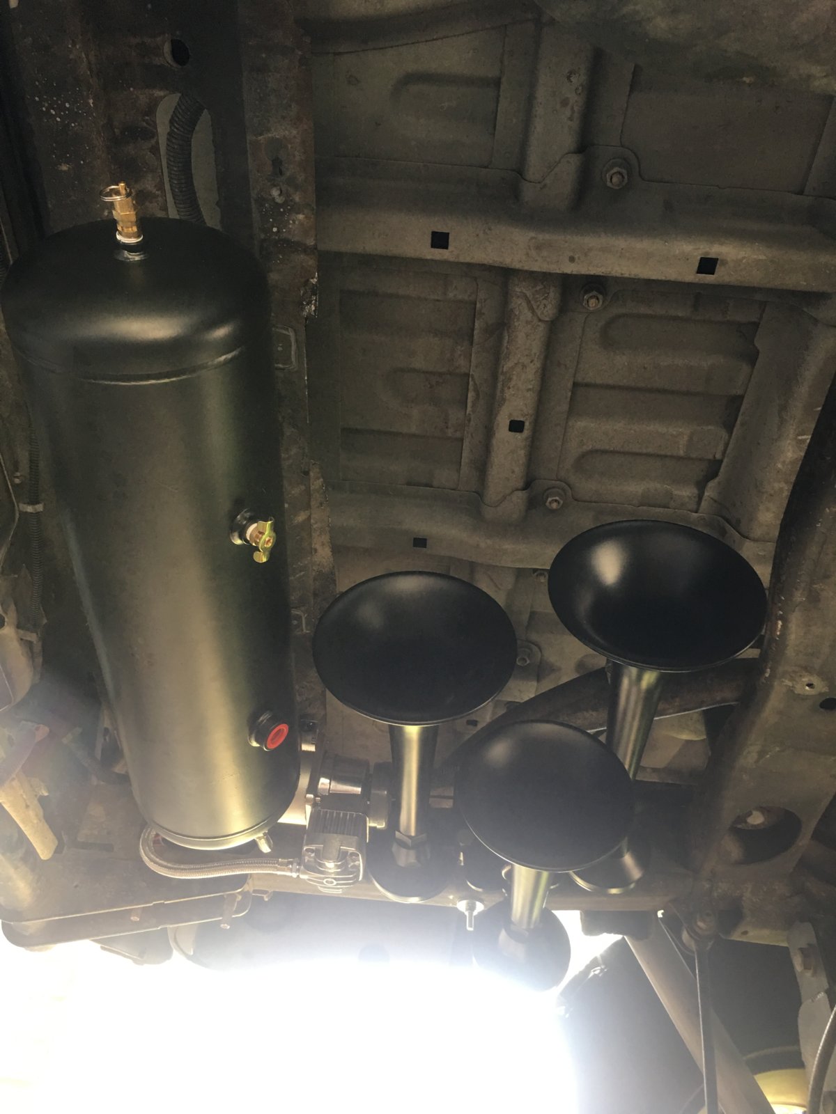

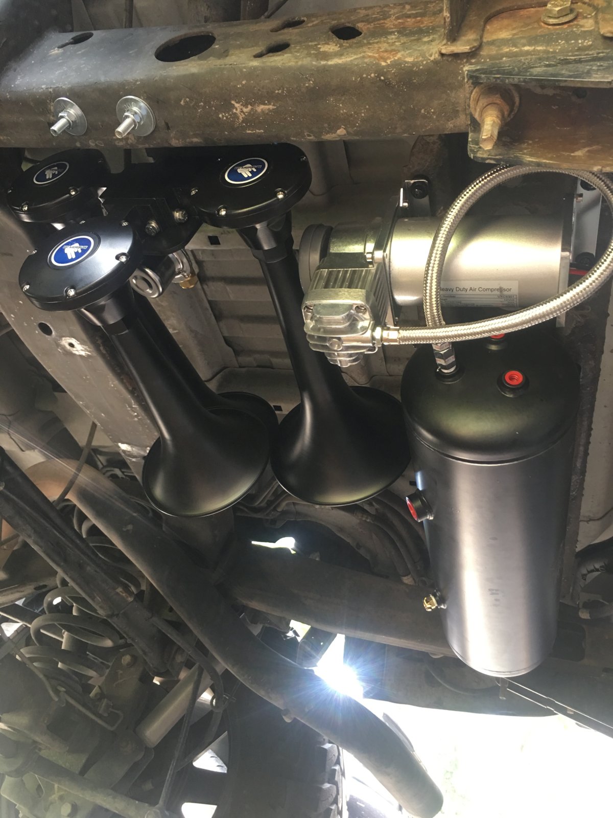

Finally had a lil bit of time to mount everything. Now just to run the wiring...

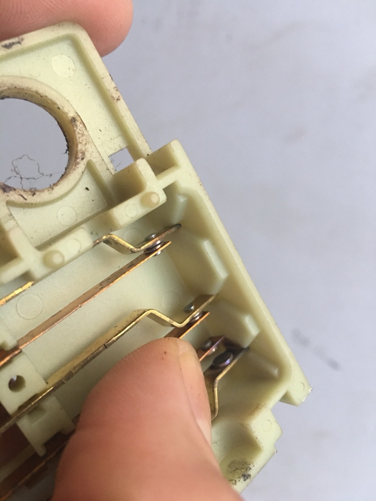

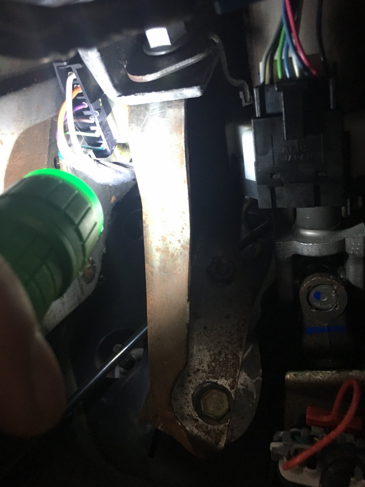

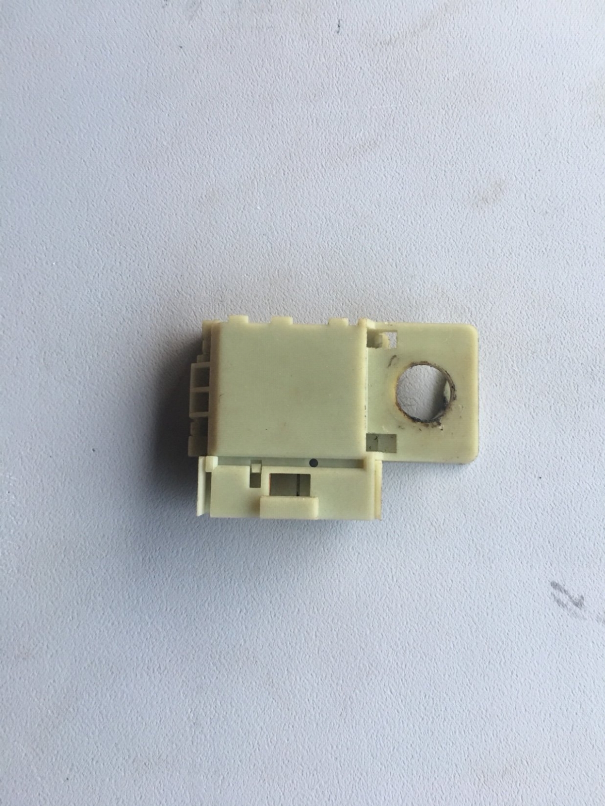

Coming home from work today this kid in a nice old late 70’s Chevy pickup is trying to get my attention at the stoplight, so I roll down the window he mentions that he didn’t see my brake lights come on when I stopped, so I get home and check them and yup they are out, I checked some fuses they were all good so I pulled the brake light switch and it’s bad so ordered an AC Delco off Amazon should have the Escalade back on the road Thursday night, with the adjustable pedals it’s a pain to get at.

Might I make a suggestion. That compressor has a air filter. I would run it up in the cabin with the air line out to under the chassis. It will make the compressor last 2-3 years longer. If you must mount underneath get either a sealed compressor or make a splash shield to surround it.
I do allot of these and have over 10 years experience just doing air horns.

I’m glad it seems to be an easy fix, GM doesn’t make it easy to get at with the adjustable pedals that’s for sure tho
I've found nothing in that area of the truck that's easy to get at. I just replaced the steering position sensor on my 08 CC which involved pulling the column and working down there and my body doesn't like those contortions. If the seat wasn't in the way it might be easier.

Yeah I do plan on making a remote location for the filter. This was just getting everything mounted up. I still have to run the wire and air lines. The splash shield is a good idea too!
