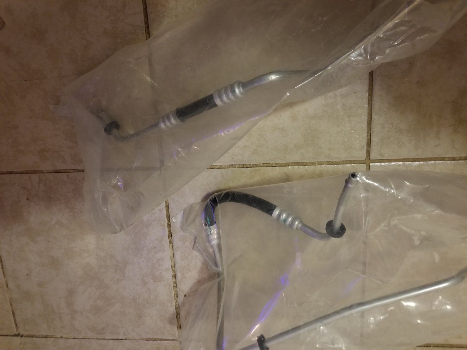

Yeah, lucky me. I called Advance Auto, $20-$22, and in stock. Not including my commercial acct. What did they run you at the dealer?
When you replace it check the fittings the lines pop into too and you might want to replace the metal clips that pop in after the lines in, for all the lines it was under $200 I like $150ish, back on my OBS Tahoe I had leaky oil cooler lines threw on Dorman brand ones they leaked within 3 months got some AC Delco ones never had an issue that’s why I went the dealer route on the Esky

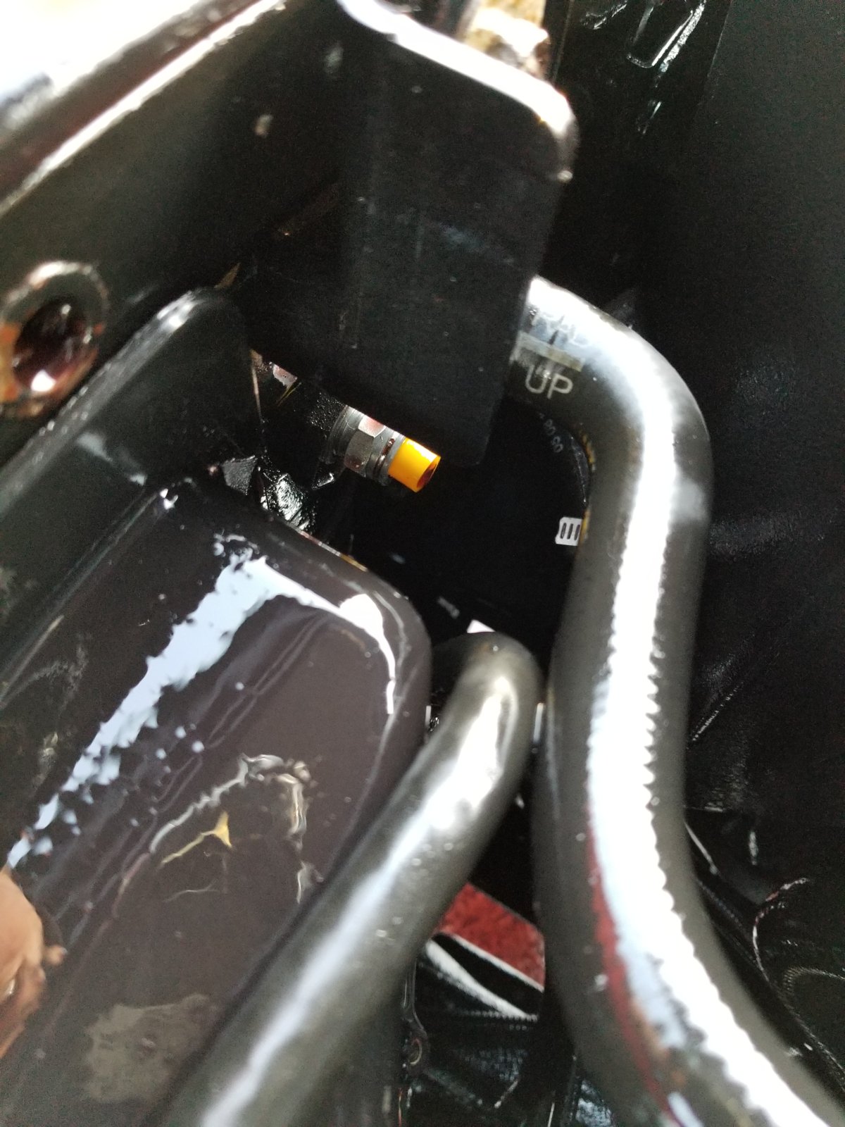

There's a plastic nipple sticking out where the trans line was on the radiator.
Should that be there?
drowssap
Apr 15, 2017
265
289
Colorado
There's a plastic nipple sticking out where the trans line was on the radiator. Should that be there?
I believe that is the part of the pressure fitting. Once you remove the clips ....all of that should come with the part that you will discard. The new line should have it as well but you won't see it. Hopefully you will never see it again as well!
