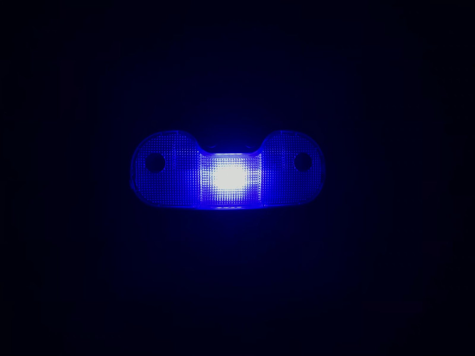

Looking for any thoughts or advice.
2nd row dome light blue LED stays slightly illuminated after the map lights and cargo area dome lights go out, either by timing out or locking the doors by the remote.
I sat in the 2nd row and tried different combinations, yet it stays lit.
I did not pull that bulb yet and try another one.
Here are a couple of pics.
Thoughts?
All interior lights on.
After all other interior lights are out.
Thoughts?
I had this issue on my OBS Tahoe and the consensus was if you convert all your bulbs this was a common issue, LED's take such little power to run and there was always some power going to the bulbs but not enough to power the regular bulbs, the way to fix it was to run resistors or put a regular bulb under the dash which worked, fast forward to my NBS Escalade I converted all my interior lights to LED and never had this issue

There's a write up on it that I bumped awhile ago. But like Brett said in the end dude put in resistors and it was fixed

My 05 did that in the 3rd row, i just took it out and put it back in and wiggled it a few times lol and it never did it again lol

Good info guys. Thx. Will fiddle with it and see. At the most, are we talking a super low draw? @05Single

Is it killing the batt or annoying you? Can you see out windows or is it distracting? Seriously, my 08 accord has a tiny blue led in between map lights that spashes light over the console at night... always on, no way to turn it off. At first it annoyed me but 10 yrs later and i actually like it because you can see stuff at night without turning on map lights. Just a thought, maybe leave it.
