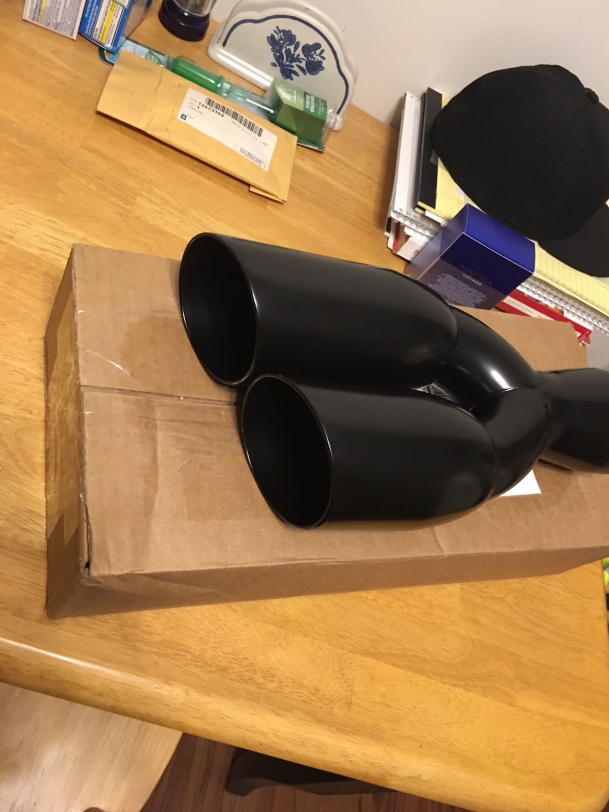

Made an appointment to get the muffler and tip installed Monday at 4:30
