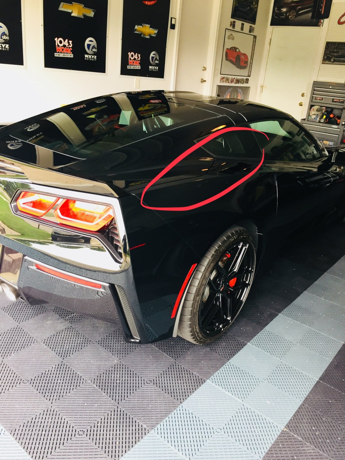

Here’s a pic of my black car. The quarter panel is wrapped with Xpel, then I ceramic coated over the Xpel, the liftgate is not wrapped with Xpel, only ceramic coated. Still looks pretty clean 2 years after ceramic was applied.

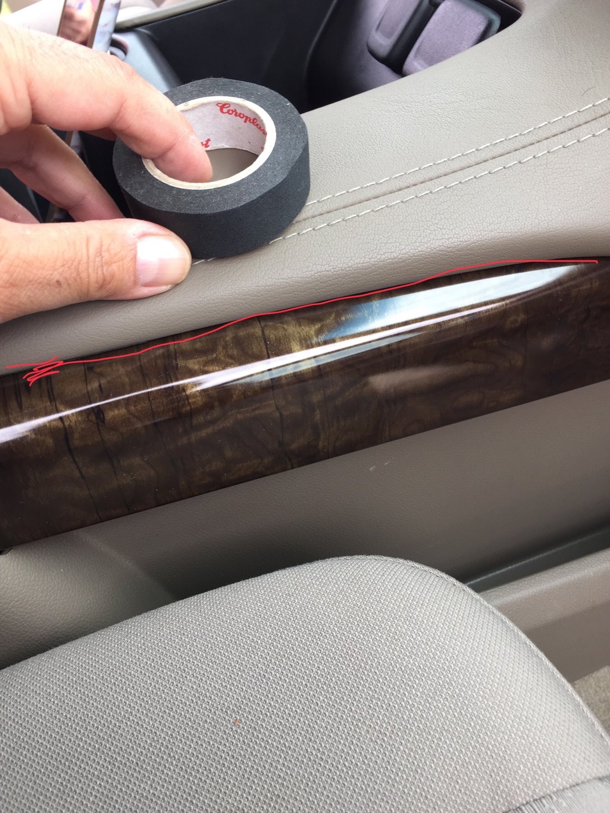

Fabric “itch” tape along the edges I marked, on both sides. Was getting a “rubbing” noise along those edges on rougher roads. Completely silent now on all road surfaces. (I stuck the tape on the inner edge of the “leather” looking upper bezel. Obviously, you don’t want to see a bunch of ugly fabric tape once everything snaps back into place)

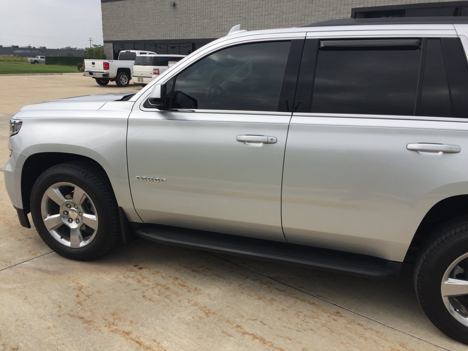

Front windows tinted (20%). A ticket’s a ticket. Not like the officer is going to cut me slack because the tint is only 35%. Might as well do it right.
