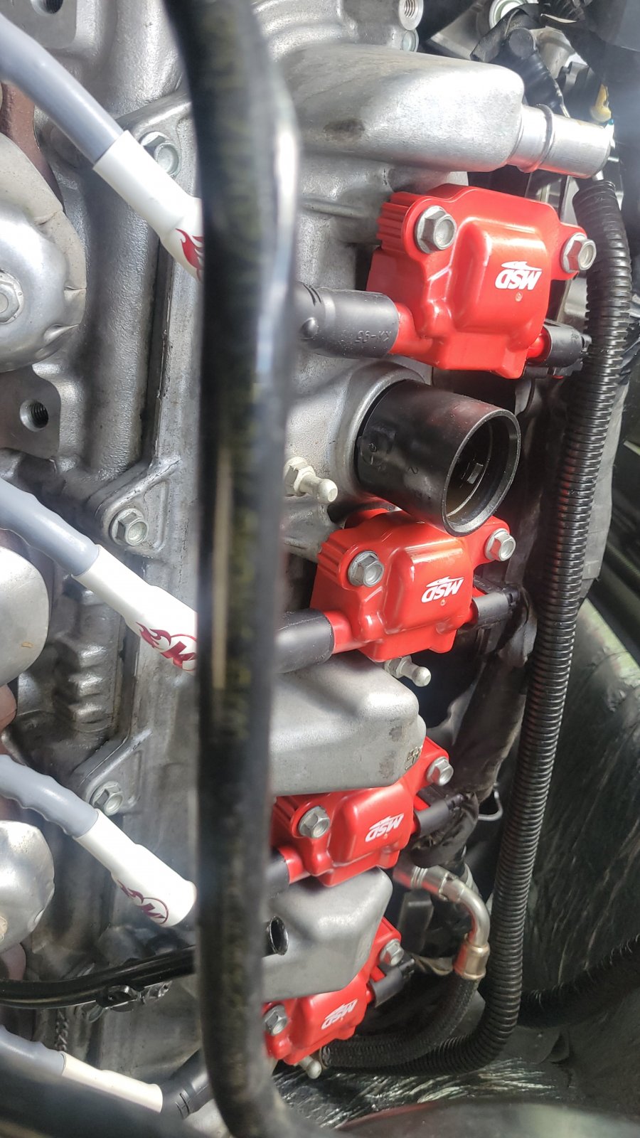

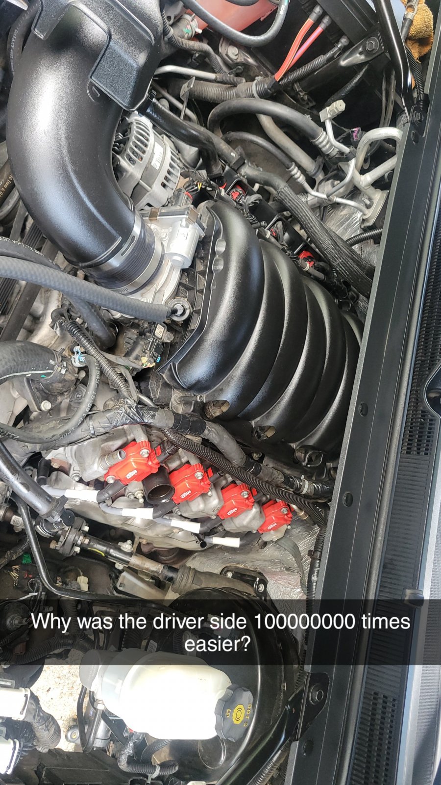

Went to change spark plugs as well since they're the originals with 92k miles on them now.
Driver side 1, 3, 5, 7 was easy enough from the top when I did that a little while ago.
Tackled the passenger side 2, 4, 6, 8 today and since it was a pain I took the wheel off and the fender liner off.

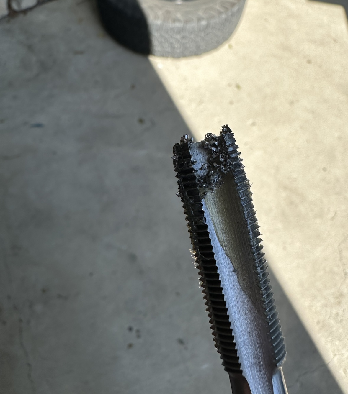

Number 6 was a pain in the ass coming out, turns out whatever moron put the plug in at chevy, cross-threaded it.
New plug wouldn't go in without cross threading.
Had to really work at cleaning and fixing (chasing) the threads to get a new plug back in.

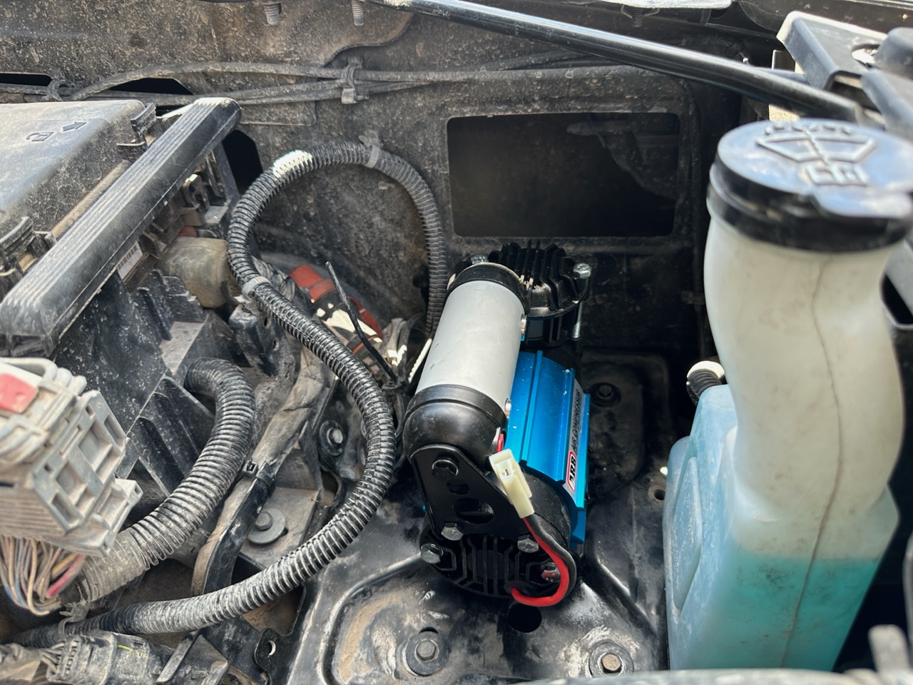

Added on board air. Switch location is TBD.
if’n ya look close you can see what folks in the south ask “whuzzat plug doing on your car?” things. No idea why actually, since it was sold and lived in Texas its entire life.
