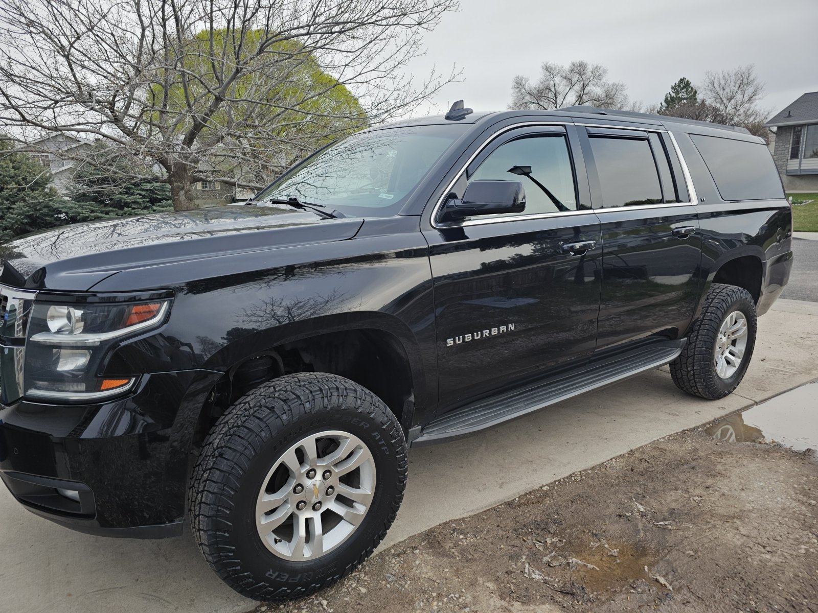

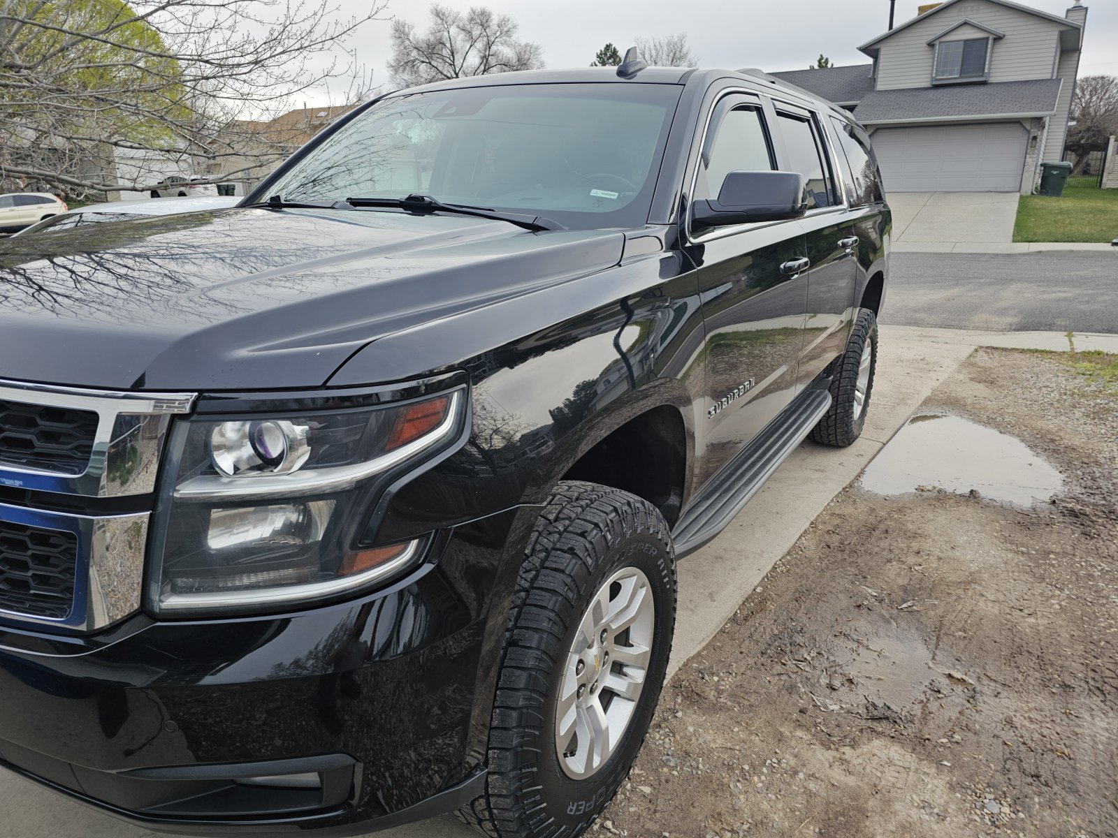

Yesterday I got new tires. Today I added 1.25inch spacers until I can get new wheels. Gives it a more aggressive look and keeps my new tires from rubbing on my new upper control arms. So now it's has the 3.5" lift up front. 3" in the back. 33" tires.

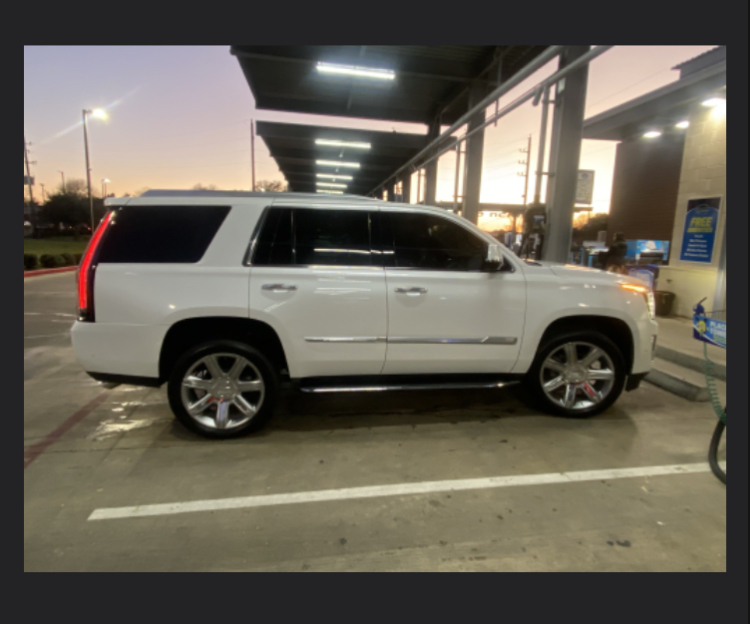

Put Armoral on all the doors, dash, doors panels, and hatch rubber to keep it fresh. Sprayed some ceramic spray on the hood to prepare for summer. I put trim coat on the side steps, lower front bumper, & rear bumper. Jay Leno conditioner is awesome for the leather. My 2018 Escalade looks like it left the showroom. The k2xx has much better quality the previous generation. If you keep on top of it you can keep it for many years. I have 107k now and my truck doesn’t have a spec of rust. I do live in Texas.

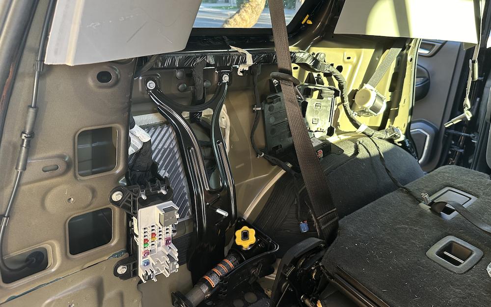

the ANC shouldn't stop the sub from working, all it would do is cause some undesirable feedback, kind of like having a mic to close to a speaker and instead of a high pitch squeal you would get a rumble. double check your work.
Well I ripped apart my interior and installed my Kicker sub. Followed every single instruction exactly.
Turned on some music and the sub itself makes no sound..
I'm unsure if it's because I need to go to the dealer and have them eliminate the ANC (active noise cancelation) through a reprogram. I know the installation manual says to do that. But I figured it would still work somewhat before having that done and then just be optimized after that was disabled.
Fingers crossed that all I need is the quick trip to the dealer and to pay $50 for them to reprogram in order to get this sub to function..
(pic of things torn apart for your enjoyment)
I took it all apart again and reattached where I spliced and then crimped on the sub wires this time. (Terrible instructions at that part from Kicker)
Working well now, definitely added some thump to it like I was looking for! Happy with it now.
