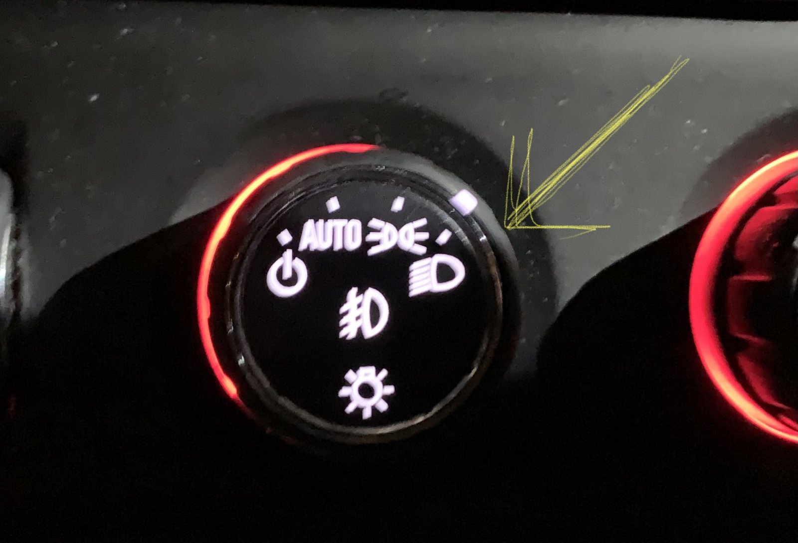

By turning them back on are you just switching the headlight switch back to “auto” headlights? I would be curious to see how the bulbs would function if you switched the headlight switch to the far right.
My understanding is this is the manual “headlights on” switch. Regardless if vehicle is turned on/off in park or drive; Headlights on. Turn it to that and see if they still stay on when you go from park to drive?

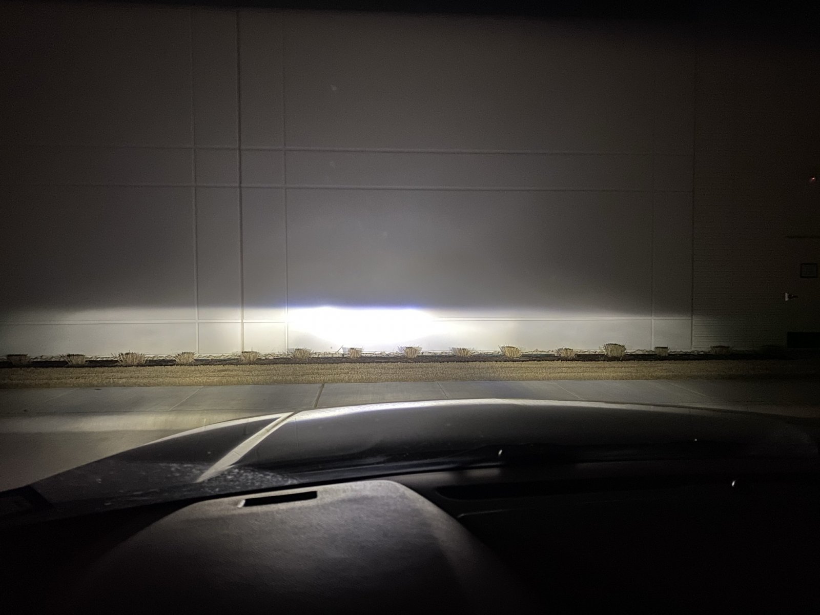

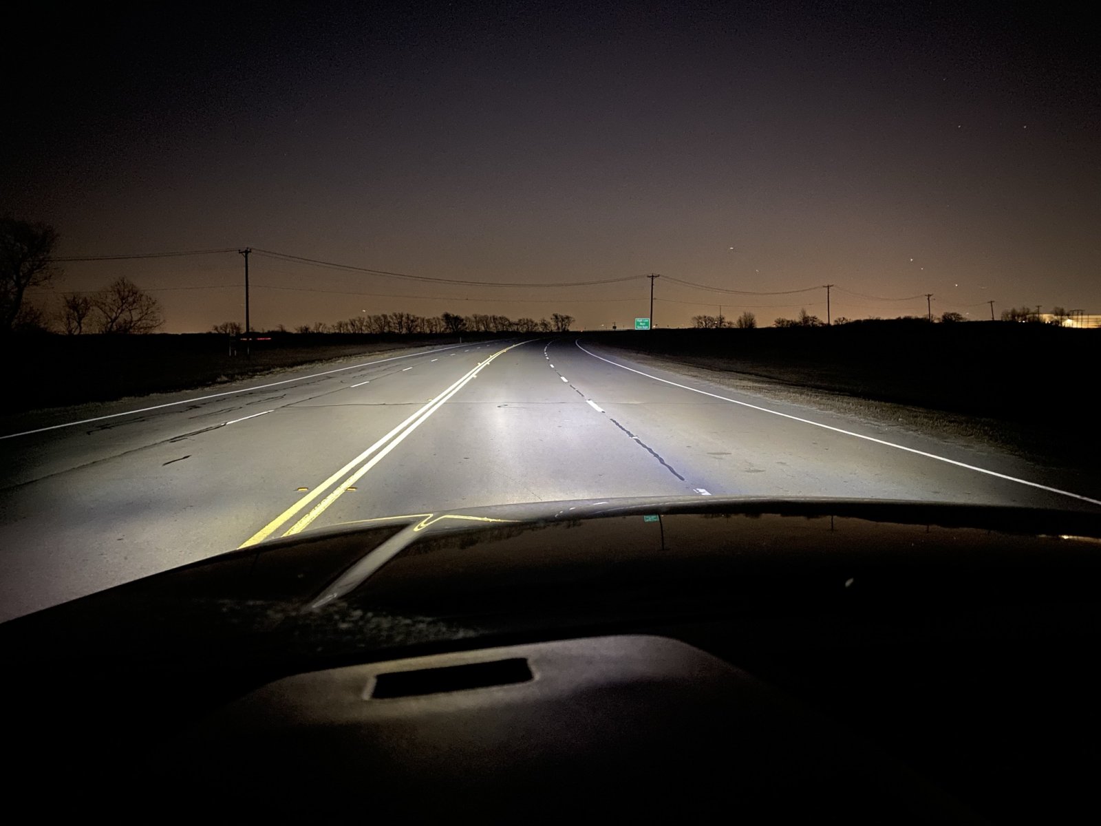

Got the replacement Morimotos today but only replaced the driver’s side which was the one having the flickering issue, regardless of the side it was installed in.
Was able to get it clocked in so that the LEDs are at 9 and 3 and no more flickering or turning off. Passenger side did a couple of flickers first, but that was it. Will replace that tomorrow, just in case. Then it’s off to destroying them, sending pics and getting my money back.
Took it for a ride and I think they look pretty good. The wall picture is about 30 feet away. It kind of looks like there are two dark spots, but so far they didn’t bother me. Pretty happy with the upgrade.

pull back from your wall shot about another 20-25 ft...i played with my adjustments of the housings...actually have raised the center line from stock setting a decent amount. it really helped down road illumination and no one has flashed me as of yet.
