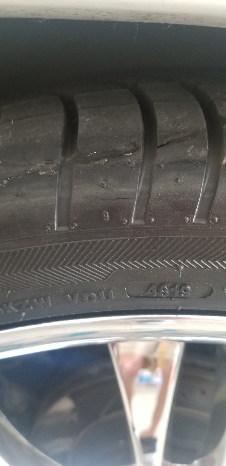

Here some pics. This never once happen the 3 years I had my vercelli stradas

I knew I should of got the vercelli again but there is a guy at my work that had the Achilles. different size than me but he liked them an they were cheaper so I tried them. Now I gotta buy 3 more tire . So misewell buy a whole another set. Definitely not this brand again.

That looks like your fender is rubbing and cutting your tires. That’s not a manufacture problem :2cents:

My fenders are rolled an never did that to the vercelli. an they were the same size. These are falling apart

It dont make sense I've had it the same height an changed nothing. The vercelli never got one mark on them. These started falling apart the first week. I think the rubber is weaker or softer.

And its plastic. No metal. I have fender flares an the plastic from them cover the metal. plastic shouldn't hurt a tire like this

This one came with a gash in side. An u can see in my pic how the flares have plastic that covers the metal.

Been at this height for a while. These have to be cheaper rubber. my other tires hit but these are falling apart every time it hits. 460 for set

Plastic will cut rubber easy. Just because u bought same size tires doesn’t mean they are the same size. I just had that issue with RDR 33x12.50 tires vs a comfoser 33x12.50... the RDR tire only measures like 33x11 and the comfoser is a true 12.50wide.. I’ve also have had a few 305/40/22 tires in the garage from different manufacturers and they were all different sizes. You could have got some bad tires from the company, it does happen. But from those pictures, that’s a slice from either something in the road or your fenders/fender flares... I hope you get it figured out though.
