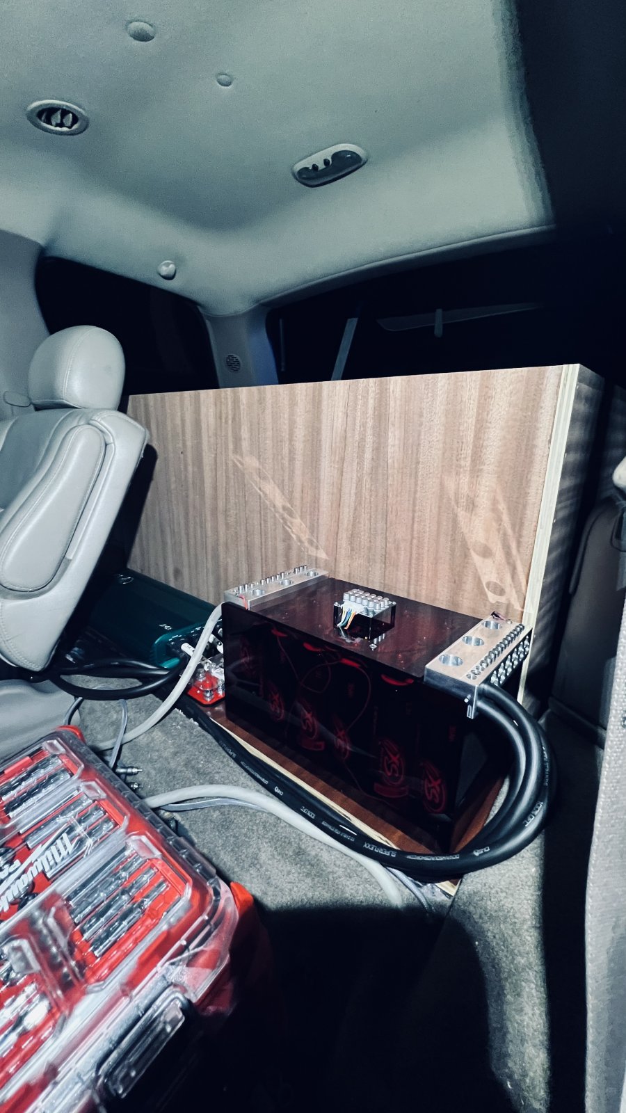

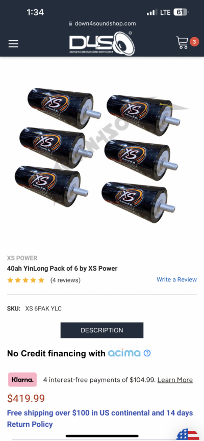

For car audio lithium battery’s are the way to go longest lasting and best performance
Xs power lithium cells are said to last up to 10 years
They should have a case battery that’ll fit under the hood but my buddy’s have swapped/deleted the battery for a setup like this
you will need a big 3 upgrade along with a voltage regulator all new 0g wire a acrylic case for it to sit in and that should be it. Of course a bigger alternator is also an easier option and could be used with this setup as well but the stock one can hold up I do believe.
For my system 6 is plenty I have a 2500watt and plan to put a 800w on the doors but my buddy in the pic is close to 20,000 watts so he has like 12 of the lithium cells in his setup
They should have a case battery that’ll fit under the hood but my buddy’s have swapped/deleted the battery for a setup like thisView attachment 430968View attachment 430967you will need a big 3 upgrade along with a voltage regulator all new 0g wire a acrylic case for it to sit in and that should be it. Of course a bigger alternator is also an easier option and could be used with this setup as well but the stock one can hold up I do believe.
Sweet!
My biggest concern is adding stuff and possibly opening a can of worms of codes due to new stuff not liking third party stuff. From what I gather, it’s not as easy as my old setup w/2nd battery, ** alt, big4, dual 0ga to amp with copper terminals all around.
The new car electronics is what I fear so I’m trying to see who has worked on 2021+ models.
