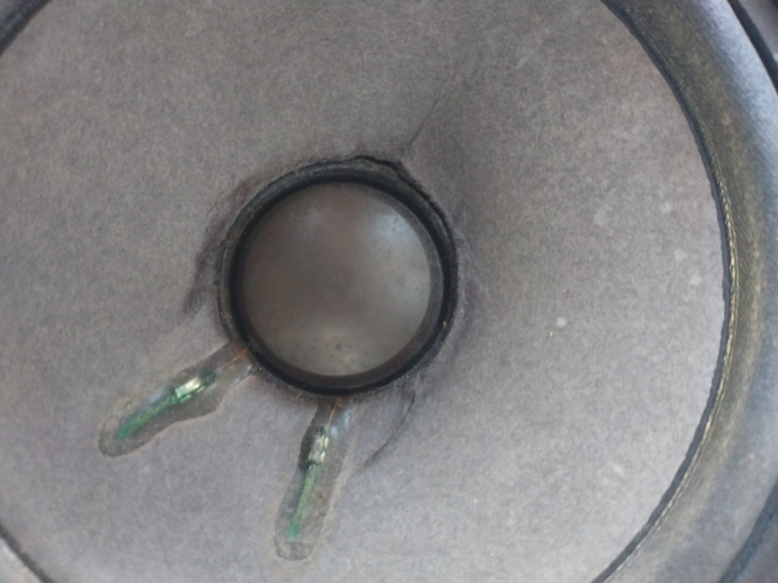

Ok so im gonna upgrade my stock speakers in my '09 suburban with the Bose system and was wondering what Ohms and output watts the radio is? I had a door panel off today and the speakers was ripped, so im sure the others are too or are shortly behind them. Any help would be appreciated. I used the search function with no luck
