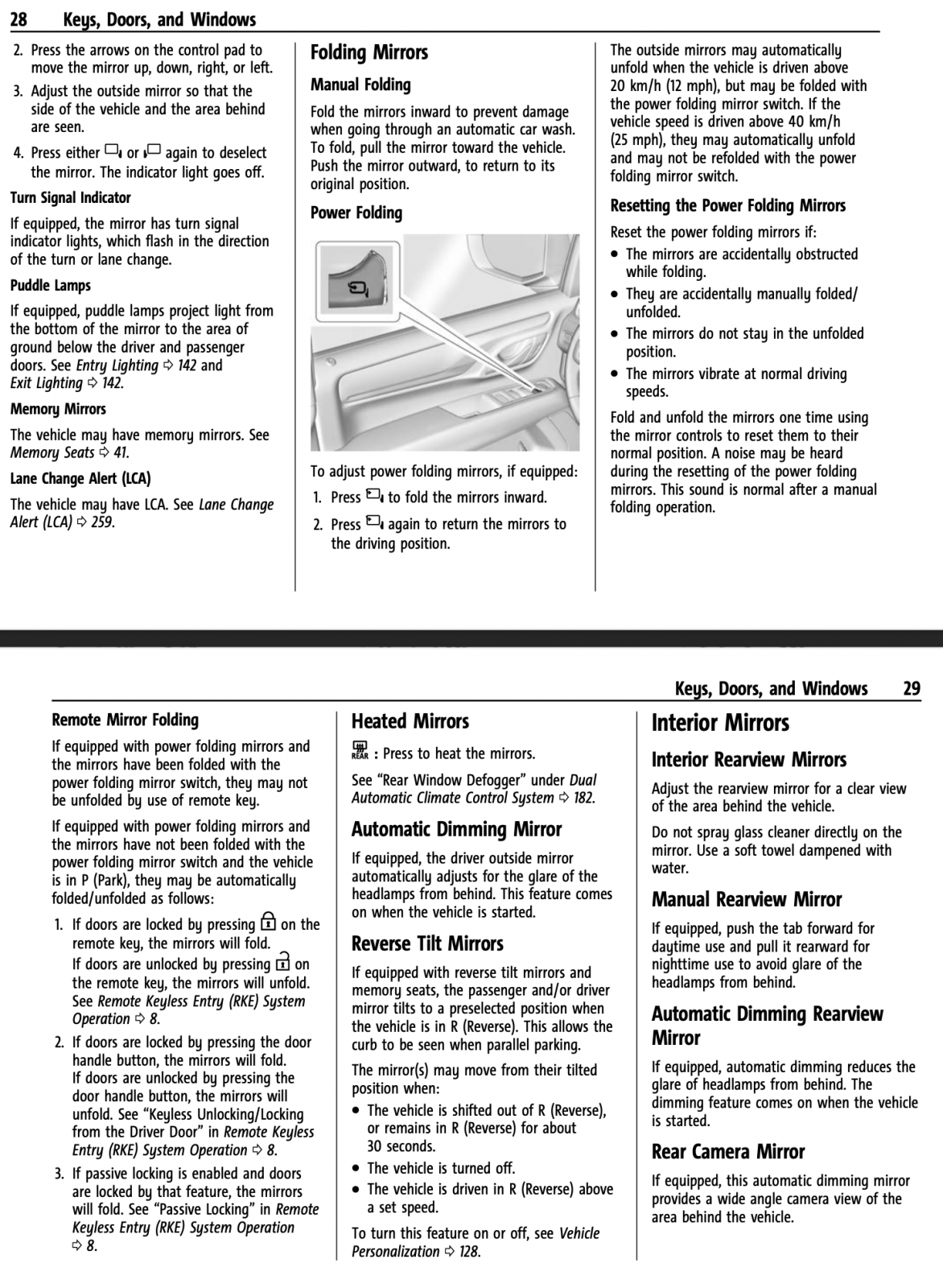

Holding the fob to fold/unfold the mirrors was a feature on the older models. The new models have a setting in the vehicle settings that allow you to have the mirrors fold/unfold when you hit the lock/unlock button on the fob or the passive lock/unlock button on the door handle, no need to hold either button. I really like this feature as you were not able to use the passive button on the older models and get the mirrors to fold/unfold.

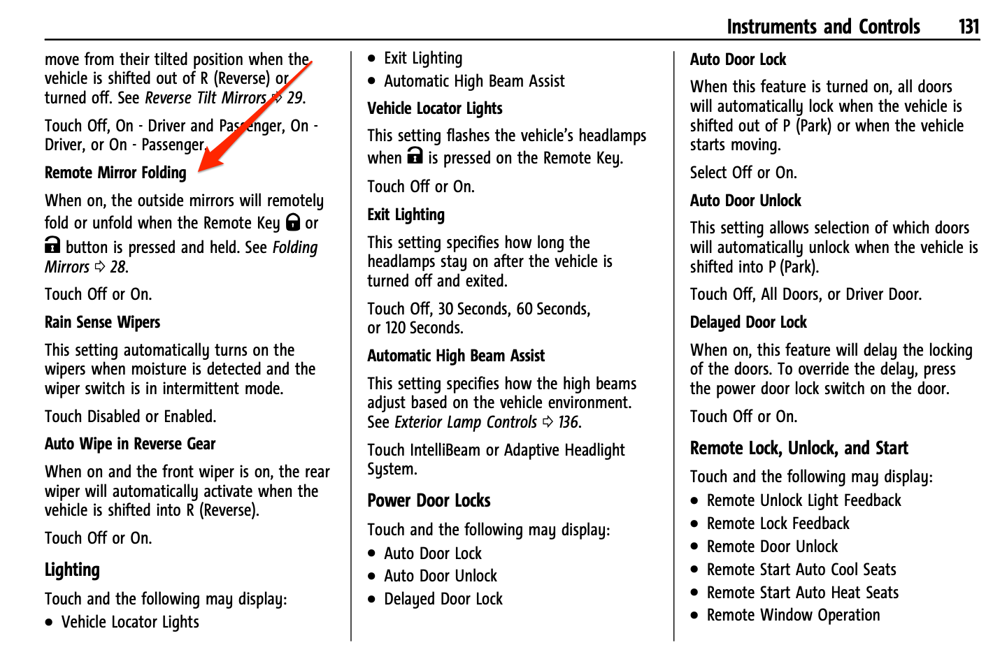

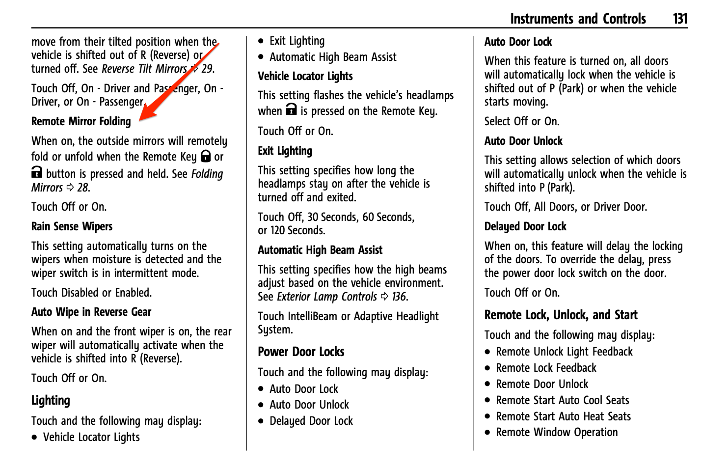

The suggestion to hold the lock an extra second seemed reasonable so we tried it today. Made no difference, sometimes mirrors fold sometimes not.
If you have the auto fold enabled on the infotainment screen, and hitting the button on the (outside) door handle, or the lock button on the FOB doesn't always fold the mirrors, you need to go to the dealer and report it as a warranty issue. Way I read the owners manual, that setting on, mirrors fold when locking the car.
Check the owners manual under "Folding Mirrors":

Ok, this is an error in the owners manual. I just went out to my vehicle and tested.
Setting of Concern is Settings -> Vehicle -> Comfort and Convenience -> Remote Mirror Folding
if this setting is OFF,
with the vehicle off:
Pressing Lock on key fob, or Holding Lock on key fob, or Pressing the Lock Button on the outside door handle, or pressing the lock button on the inside of the door all DO NOT fold the mirrors.
if this setting is ON
Pressing Lock on the Key fob locks the doors and folds mirrors
Pressing button on outside door handle locks the doors and folds the mirrors
Pressing the lock button on the inside door panel does not fold the mirrors
Above is true for pressing Unlock, just that the mirrors unfold instead of fold.
with the vehicle on:
Mirrors do not fold with pressing outside door handle button, lock on the fob, or inside door lock button.
They will fold by pressing the mirror fold button on the inside door panel.
I did not test the walk away lock feature, as I do not use this.
