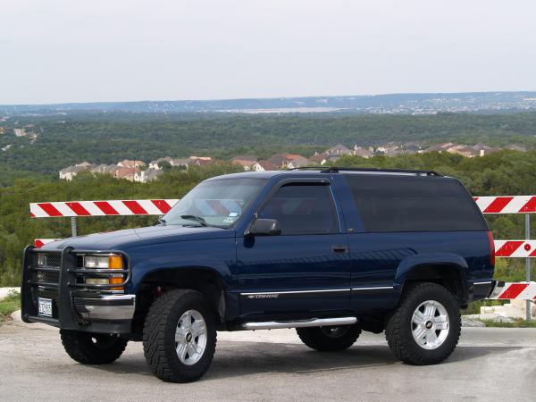

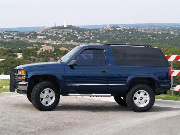

Most everyone here is going to tell you that you are better off with a 6" because you will want it bigger later on.
If you think this is the case, then do so. If you want it high enough for 295/75R16 then 2-3" is enough. The main concern you need to be aware of is rubbing the frame at full tilt. I have 275/70R18 and with the lift (before cranking) they rubbed the frame, after cranking, they cleared.
If you are riding on factory wheels, the 295's are going to wear out fast and honestly fit like crap. You need a minimum 8" or 8.5" wheel for 295's. Your factory wheels are 7" wide and I guaranty you will rub the frame even with a lift unless you have wheels with a -offset or use wheelspacers (dont do this).
The lift height is up to you and we will give you input on what we all feel is the best lift, which almost everyone has a different opinion. FYI, Skyjacker is my opinion.
Here are a couple snapshots of mine with 2.5" front, 2" rear springs, and torsion crank with 275/70R18's
Its sits perfectly level (well, 1/8th of an inch difference from front to rear)

I would say it is 4" cranked. And it is cranked all the way.
Keep in mind that when going wider with tires, lifting is not the issue, wheel backspacing is more of a concern. Getting to 305 or more you are going to be needing -25 or "more" offset. eg. Dick Cepek wheels are commonly -50. Stock is +25, thats 75mm difference, or pushed outward 3 inches.
