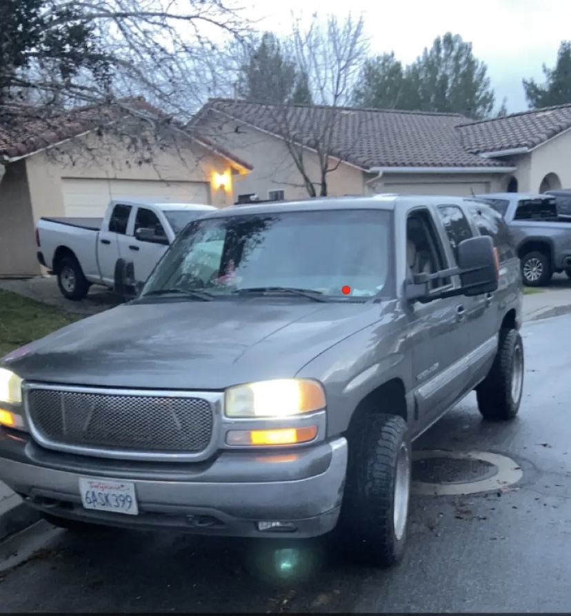

from the blurry background it looks like the wheels and tires are too wide so not surprising

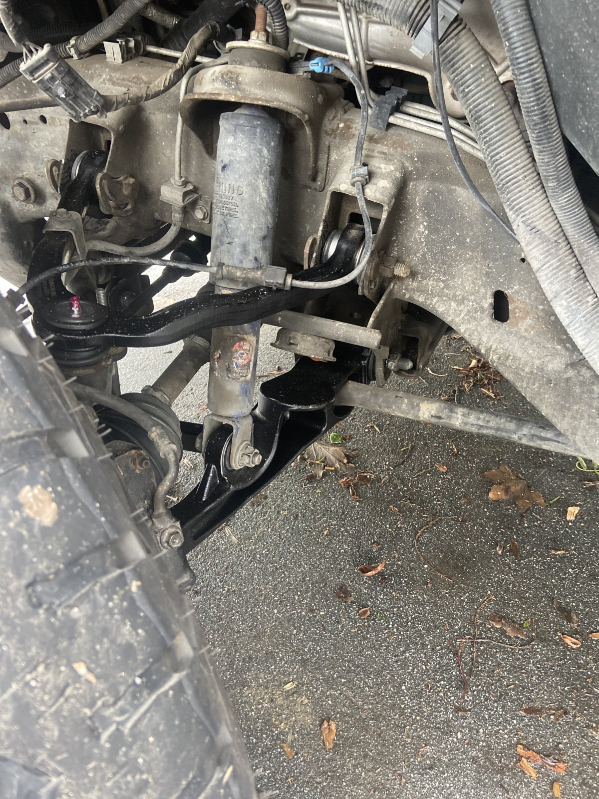

Spacers do do that I got the spacers to be a cool cat and they’re biting my butt the “cab” corner needs a small intervention with Mr sledgehammer and the grinder but Atleast they won’t refuse to align my truck for a while and I can drive it again with New control arms new idler arm and bracket pitman arm tie rods the back end needs the lift installed but that’s easy I do also need to either put the shock extensions or change to 2-4” lifted gas shocks
2” wheel spacers + new torsion keys within z spec no idea how cranked they are however it looks nice besides needing the rear coil spacers

What size wheels/tires?
265 60 r18 or 31~x 10.5”~ 2” wheel spacer +20? Offset 18x9.5 pro comp wheels max peeding rods torsion key lift minus the coil spacers and shock spacers
Vehicle was in a accident with previous owner so I could have my control arms pointing slightly back

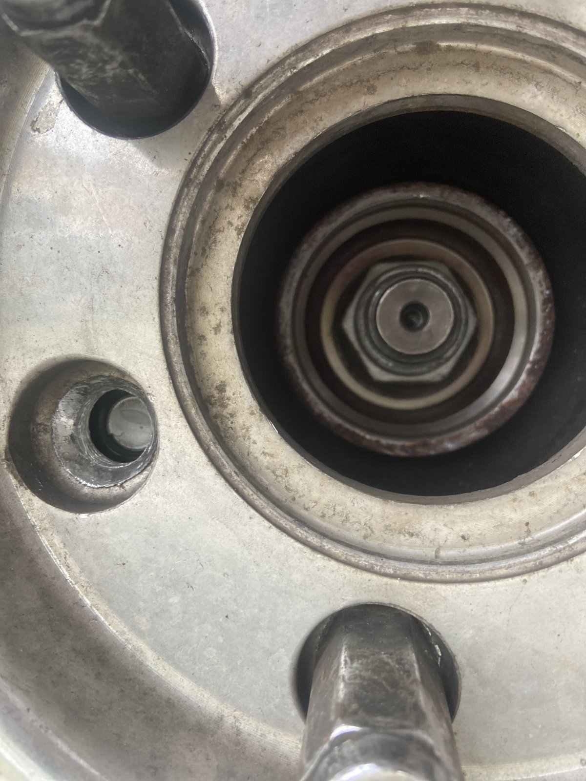

They snapped my wheel spacers lug nut without saying anything I found loose wheel speed sensor wires that had broken clips (understandably) but they didn’t even have the decency to zip tie them im missing a axle cover they didn’t remove my plastic lip or fill my tires to psi lots of low quality work

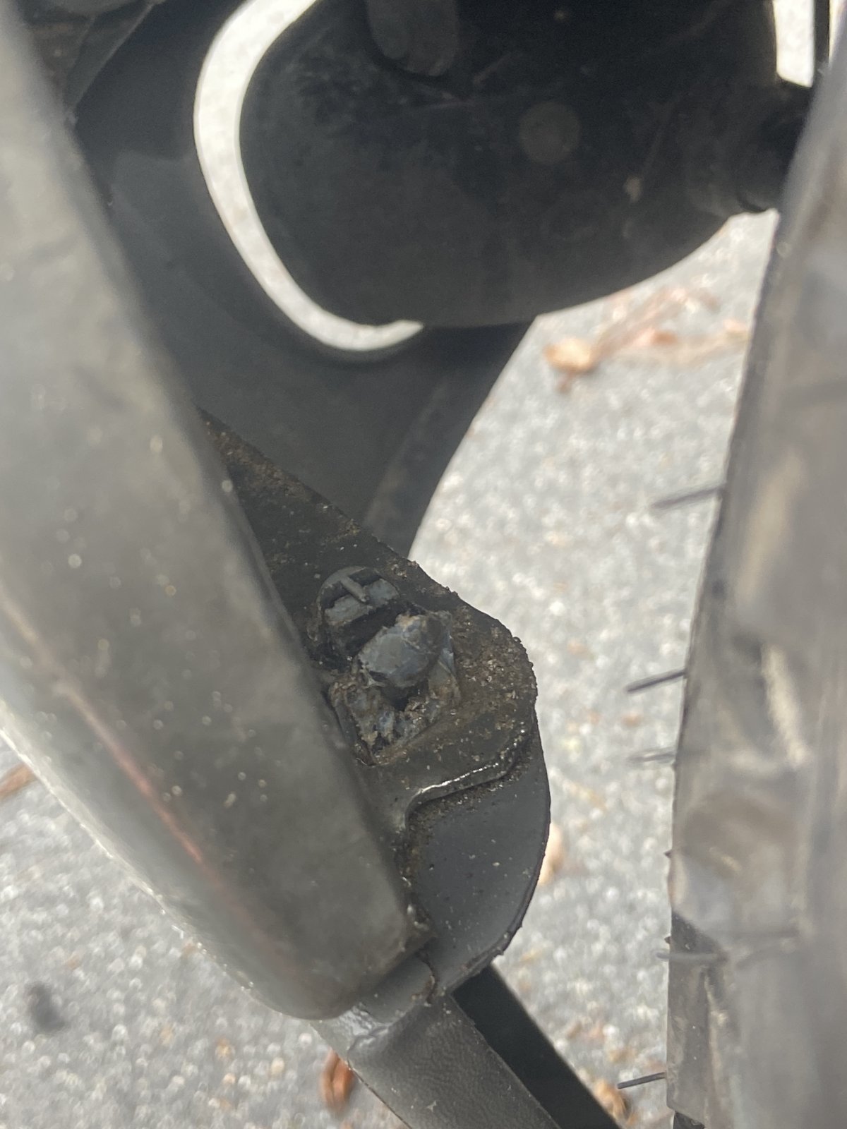

@Doubeleive any idea how to remove these plastic clips they’re rubbing my tire?
those hold the valance on, you could cut/grind a section off for clearance, I think they generally call that the "nor-cal" mod, might be some youtube video's out there, shops around here do it all the time.
I found out $3 harbor freight huge flat head + brute force in the right place= pops off but i have another issue my liscense plate mounts disintegrated
