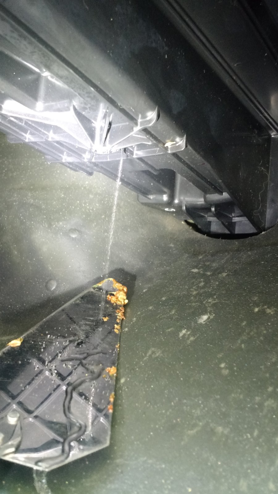

Thank you for the suggestions.. I found the culprit, thank goodness for small miracles, I don't need a large job yet on this new to us vehicle.
apparently when someone reinstalled the Blower cover/Sound cover they missed the factory hole and made their own. So I'll let it dry and seal it up, I'm guessing epoxy or something like that, unless someone has another suggestion.
Picture of the water flowing out onto my dirty mirror finish trowel.
My guess is RTV would work fine.
