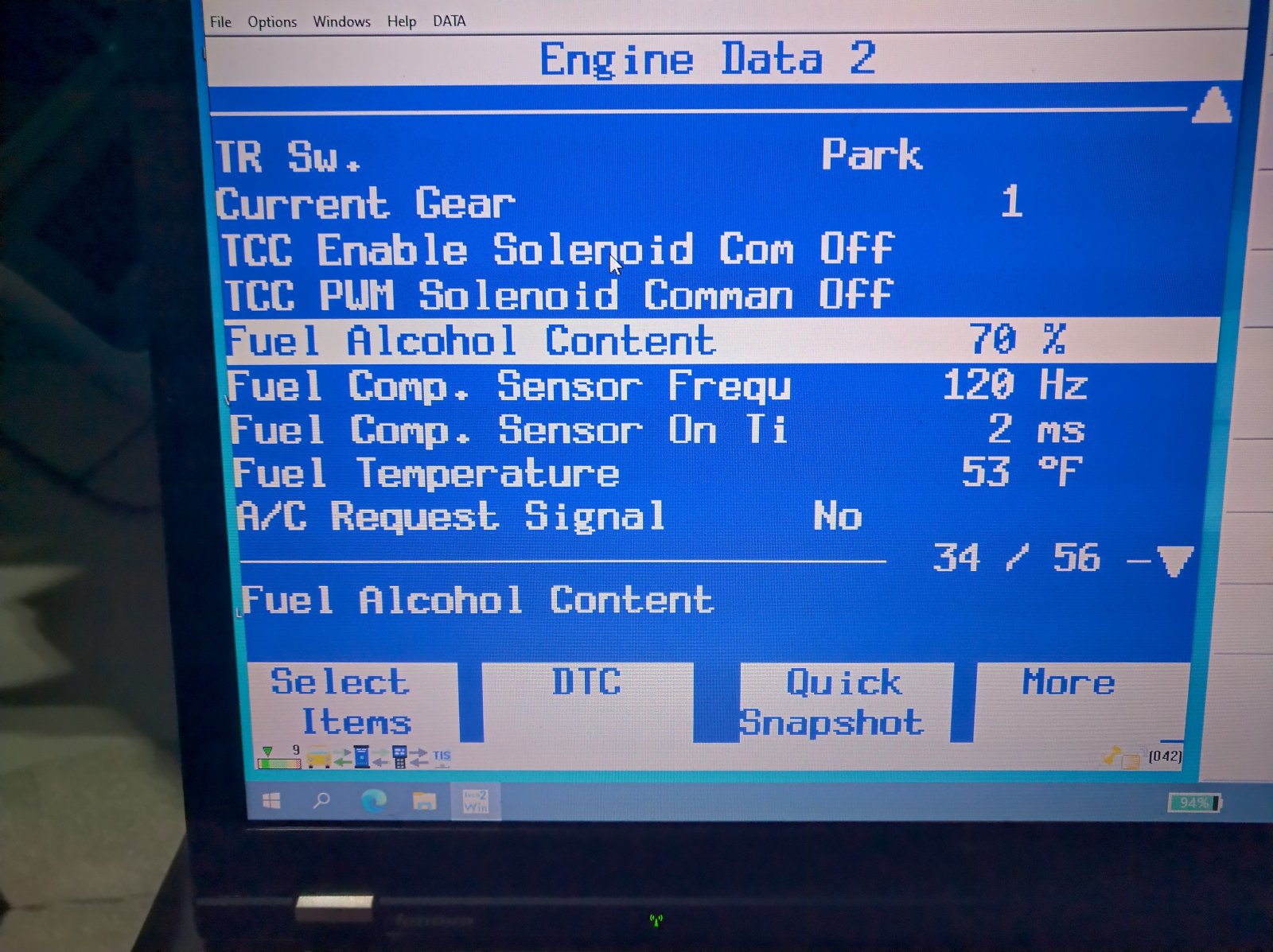

Just took this...it was still in open loop - hoping it's accurate. Same percentage as when I took it in December. I think I read some folks have their sensors stuck at 70% IIRC? Still have an eighth of a tank to burn before putting some e10 in to see if it eliminates the problem. Weird thing is, it's 23* outside and my garage is like 65* and just now it fired up first time. I'm so confused...lol.

I didn't look back in the thread, Matt, but have you compared the IAT sensor value with the ECT value when it's cold? They should be within 5° of each other after a full cool down. Just a suggestion.
There's no rhyme nor reason to it. Cold motor is does it sometimes. Hot motor it does it sometimes. I'm trying to eliminate e85 coupled with low ambient temps as the cause. Still bringing my alcohol percentage down. Today it didn't want to fire first thing in the AM, but I didn't get temp checks on it then. Ran a few errands and every other start (after only sitting 20 minutes) would give me trouble. Ambient ranged from 50-75* today. Just now, after it sat for 3 hours it fired right up, so my temps aren't a good test. However, it did sit for a good while with key on RUN which may be what it needs. I've tried to "prime" the pump 2-3 times before each start attempt but that doesn't seem to do anything, either. I guess I'll try and get alky down to 10% and also slap my pressure gauge on and let it sit for a while and see what gives.

Wondering if the 100° IAT reading is correct; but maybe there was some residual heat after running it (and letting it sit) that would explain that, but you don't have those kind of outside temps now, do you? Does that come down as you drive around?
The truck is garaged 100% of the time, so it's not out of the realm that under hood temps were that high. These temps were taken before before starting it and i just idled it for a few minutes. Maybe I'll toy around with looking at the temps while/after driving it. Trying to remember back to my LS1 days in the late 90's - we used to put a resistor in the IAT to "trick" it into reading lower. Not sure if that actually did anything but we tried it...those motors were brand new tech for all of us...not even aftermarket camshafts when I got one.
