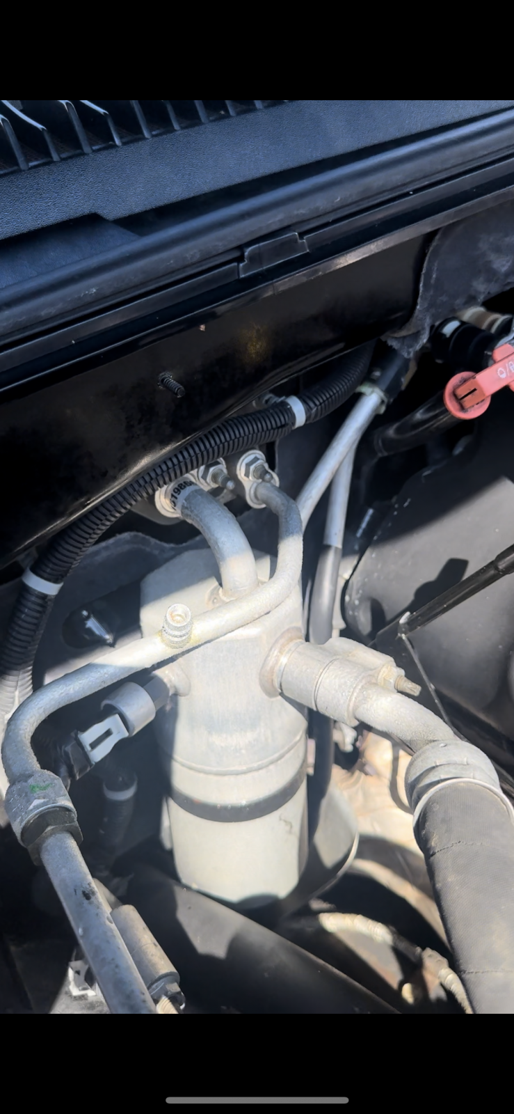

Here’s what it does. Went on a 8 minute round trip and it works perfect now even sitting at idle. Dryer looks like this

*all sweaty

The cap missing will allow debris/crud to get in there.

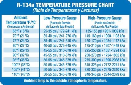

^^^^ This^^^... (thx Rock and OR V) HF has an inexpensive R134a gauge and manifold set. Ambient temp measured near the condenser (front grill) and I recommend getting a small thermometer for reading actual vent temp. I saw "fan clutch" in a previous post; I would consider a swap to e-fans, as that will make a big difference in cold air output while idling and at low speeds. 2005+ works, but I prefer the 2010+ (?) for the 7 and 9 blade combo.
