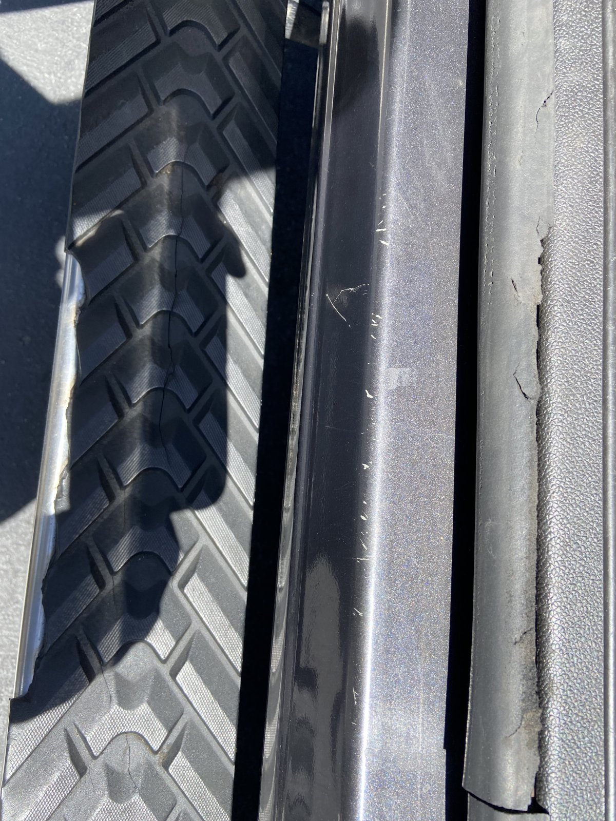

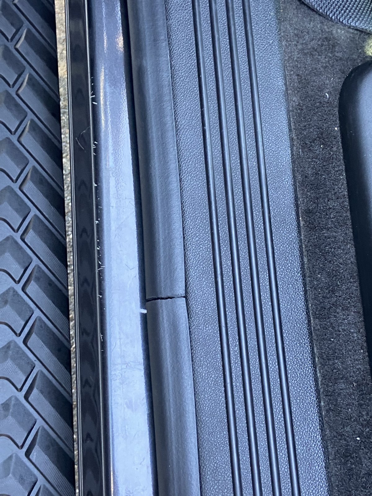

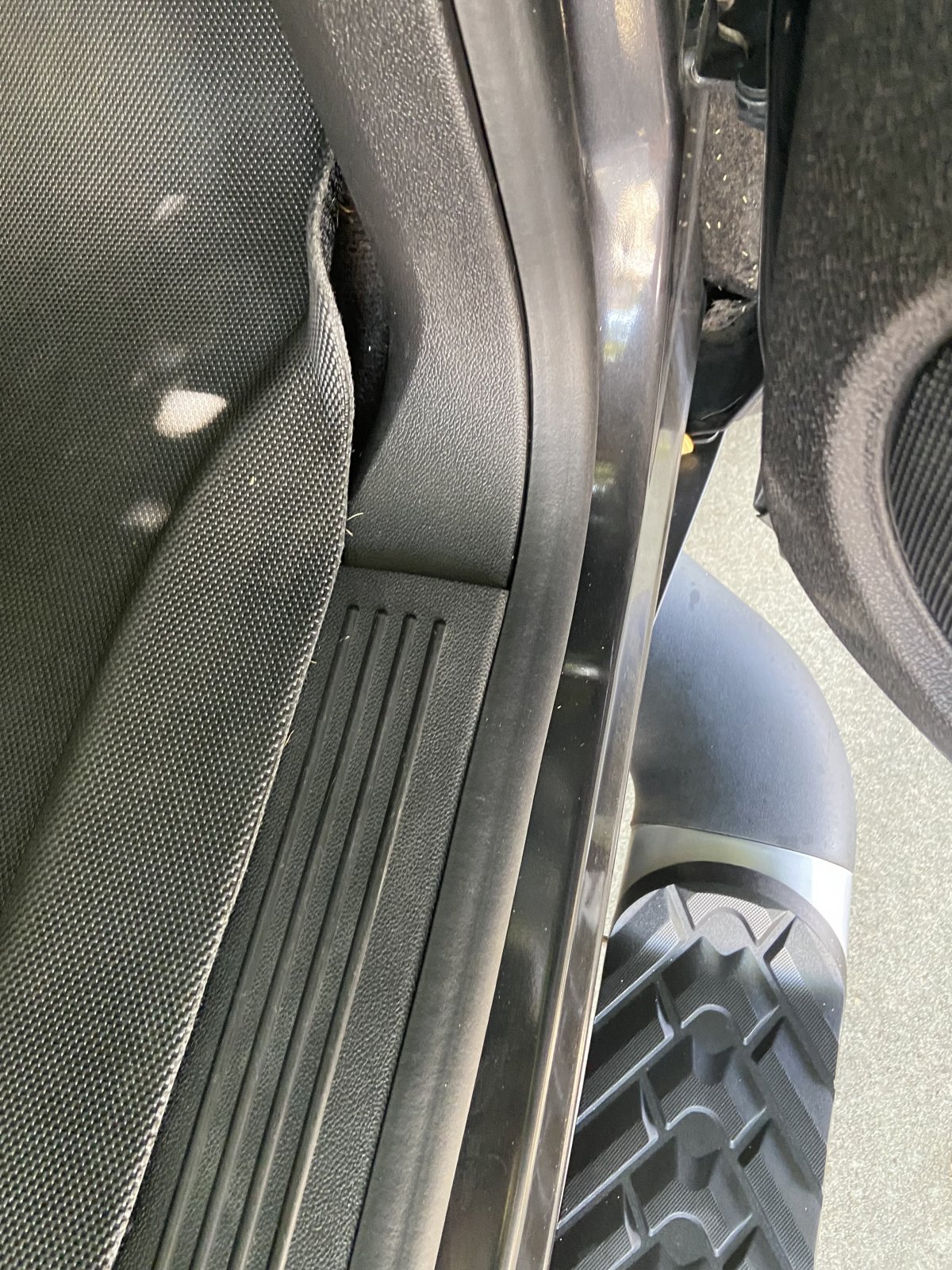

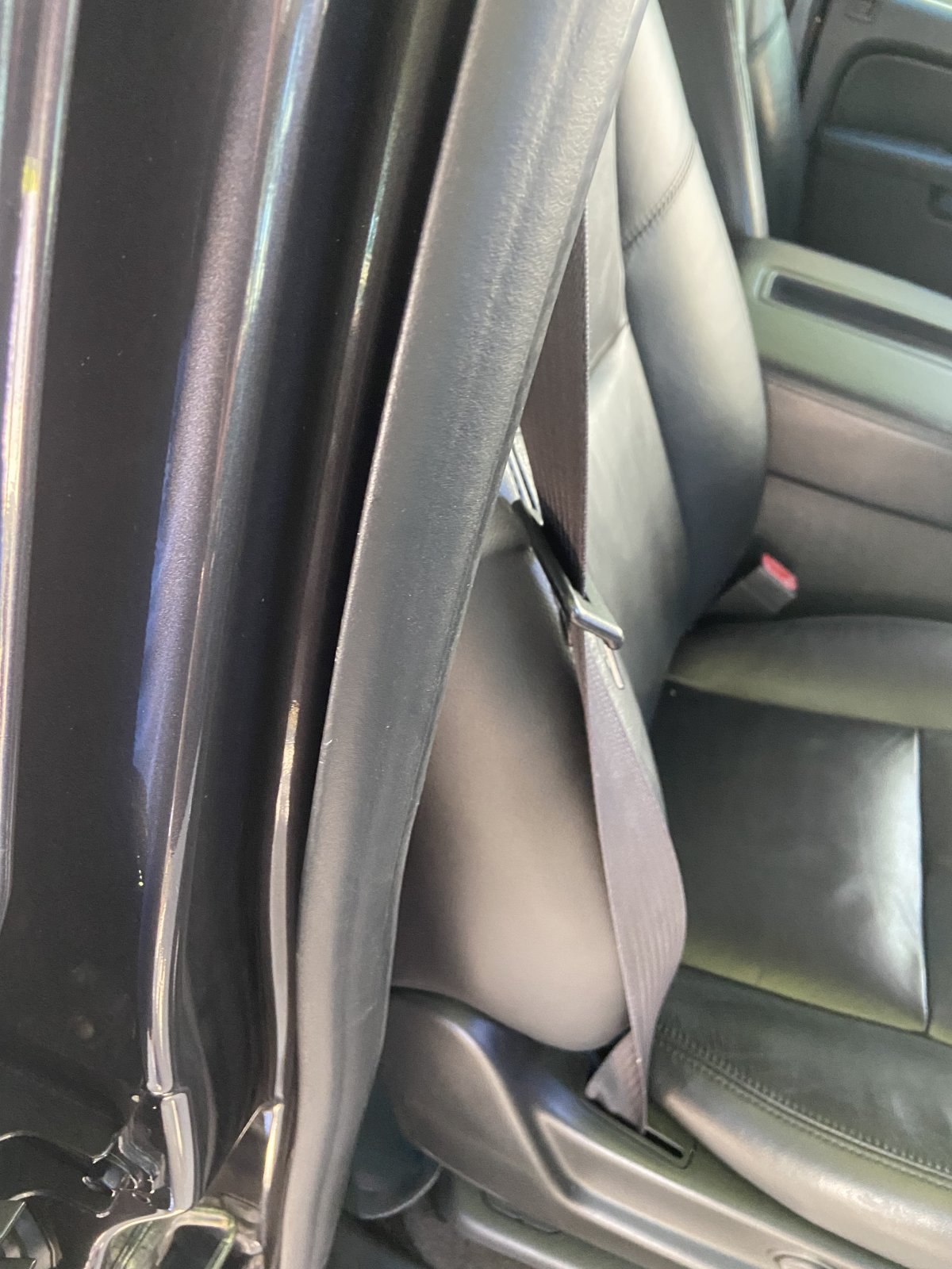

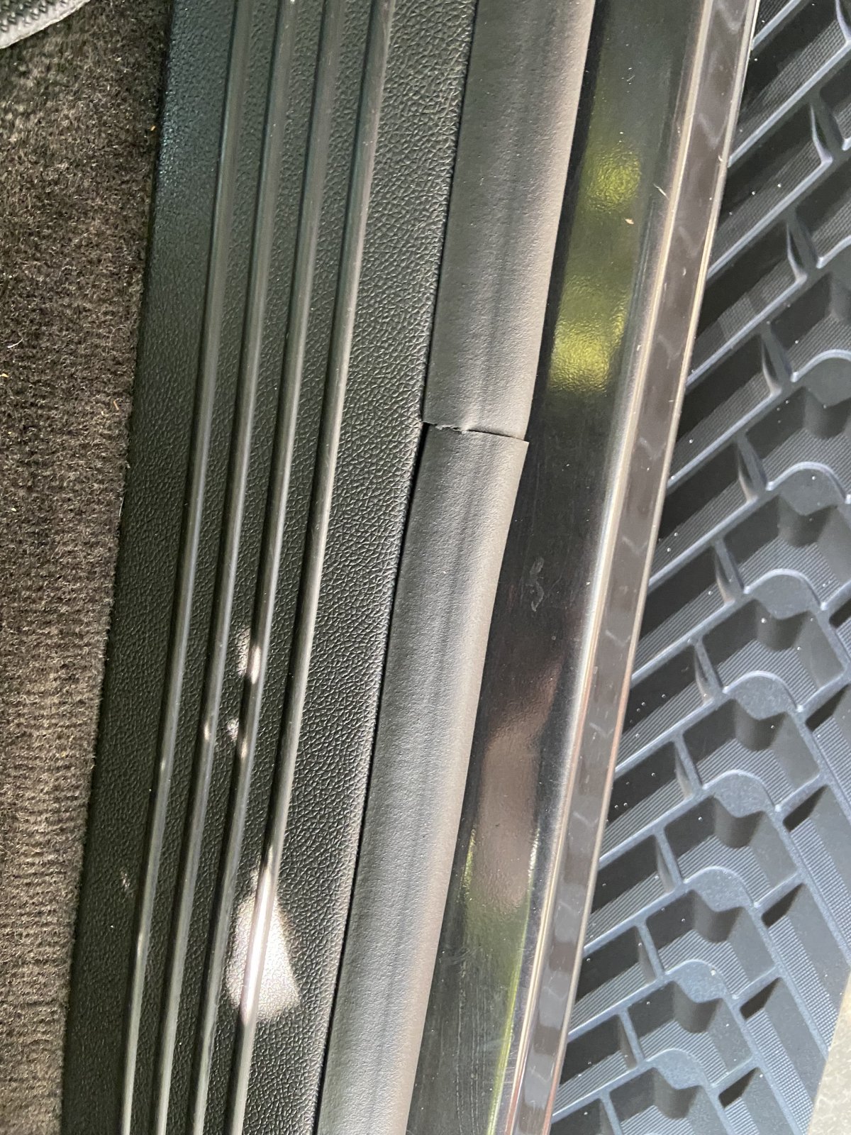

So I was very very frustrated. I took the old weatherstripping off a 2011 Tahoe and replaced it with OEM part on the drivers side. Removed the fuse box cover. The panel to the hood latch and the plastic floor board over the weatherstripping. I placed the new weatherstripping and had a devil of a time putting in properly and all back together. Well I got everything together but I can hear the wind driving on the freeway. So I looked up old posts and I think I put it in wrong. Backwards perhaps. Is adhesive recommended or required? Any suggestions? Tutorials that one could read or look at. Felt like a fool and wasted valuable time. I hate towing to the dealer. I’m a single dad with 3 kids at home.

Lol I was right. I put the weatherstripping on backwards. I did break the one part but it still functional. I changed it at night around 1:30 am. No 7/11 run this time. It buzzed me the whole time I was at work that I had it on wrong. I was determined to get it right. The one thing was I trimmed one wedge. Took an inch off and it had a gap of the same length. Just pulled or stretched it together and it looks fine. Now I have the passenger side to do. Huh wish me luck.

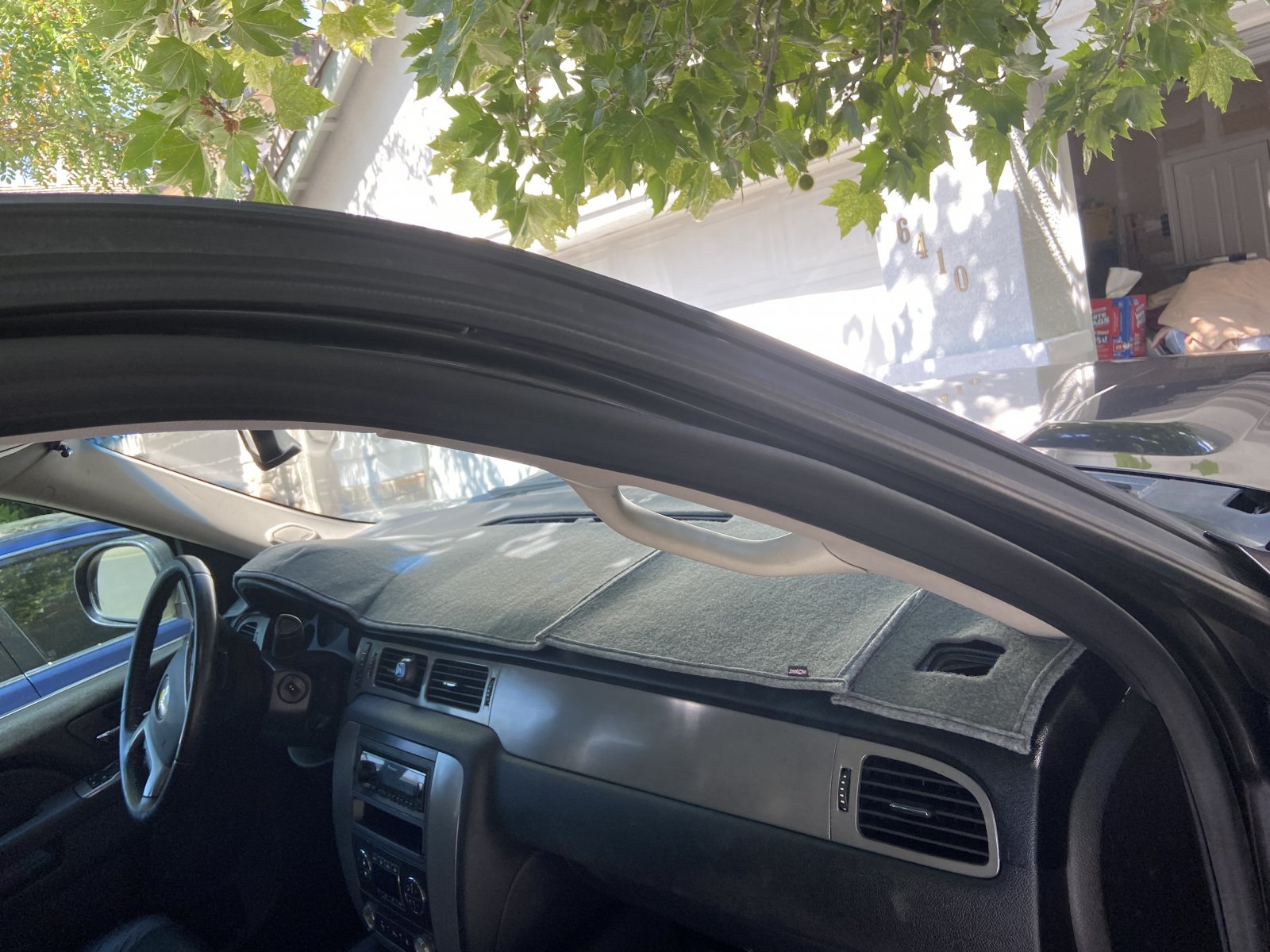

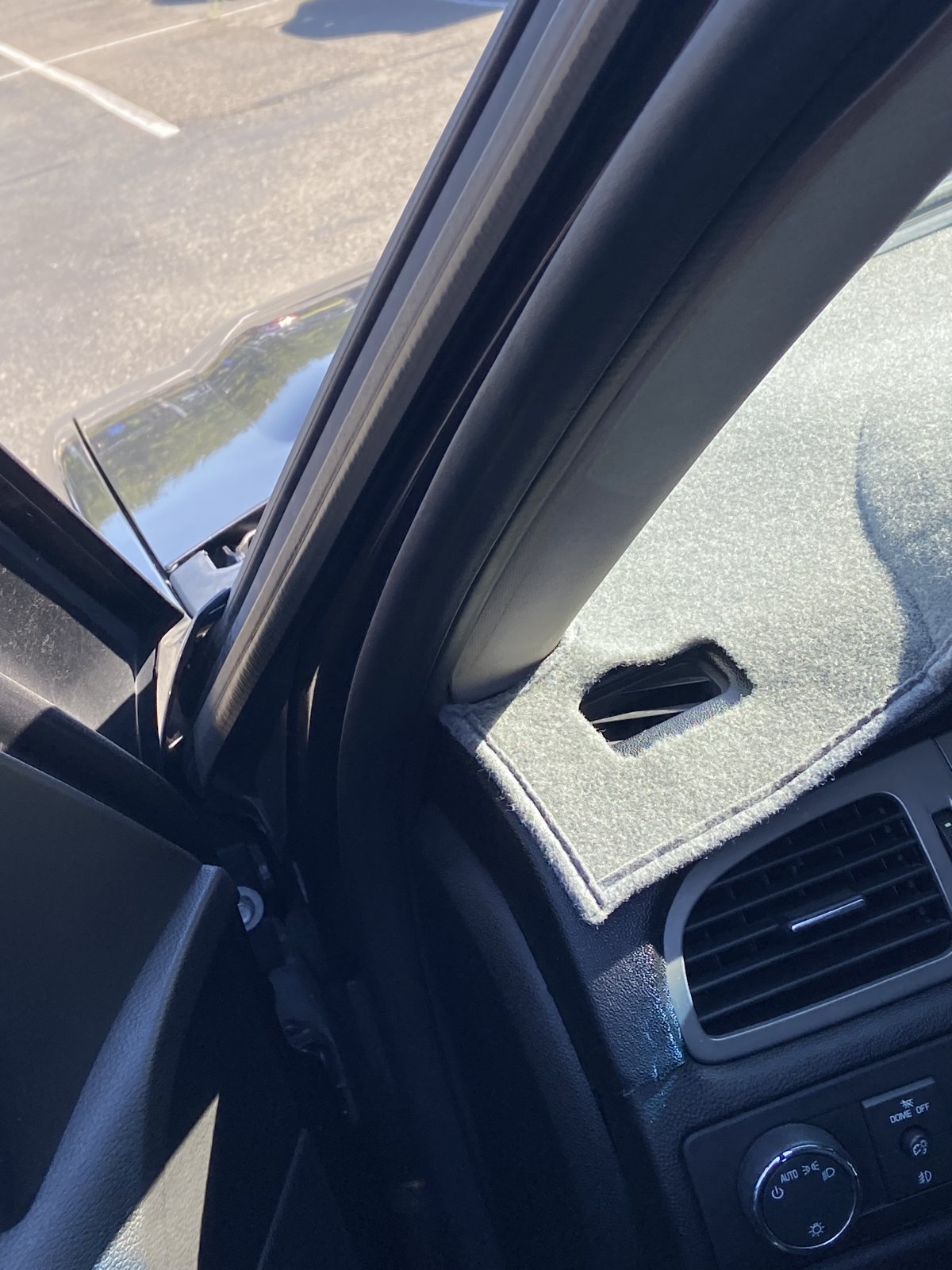

Some photos.
Ken

One thing you'll notice with the new weatherstripping is that you'll have to put a bit more effort when closing the doors to get them to close all the way
